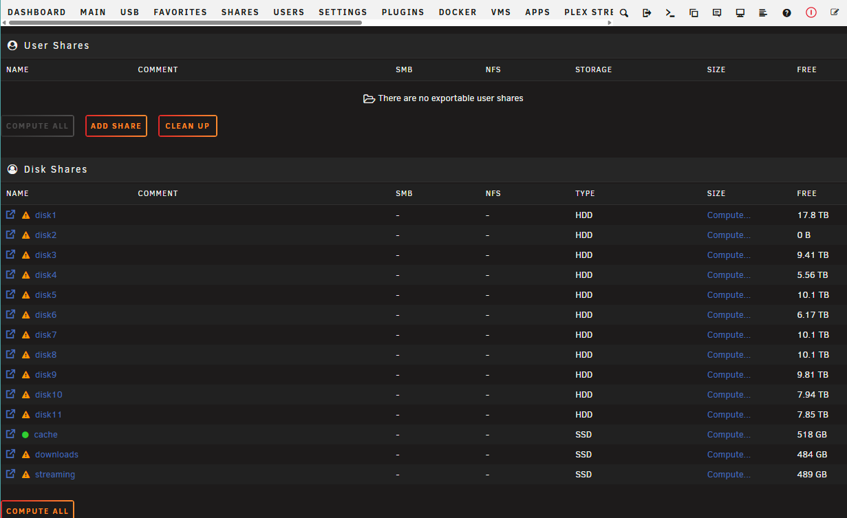

My shares are disappearing
My UnRaid server keeps dropping/removing my share folders after a certain period of time. It has been happening for a min on my unraid server

Jun 17 23:51:17 Animeking emhttpd: error: malloc_share_locations, 8160: Operation not supported (95): getxattr: /mnt/user/data
This typically means yu have something creating this mount point, /mnt/user is reserved for Unraid.
Is there a way to fix it. Or remove what's making th problem
It will be something you set up on your system.
Is there a way to determine this, or is there a method for diagnosing it?
You must have a script or something else creating that mount point, if you don't know what it is, you can try redoing the flash drive, backup the current one first and then recreate it using the USB tool and just restore the bare minimum, like the key, super.dat and the pools folder for the assignments, also copy the docker user templates folder (\config\plugins\dockerMan\templates-user), if all works you can then reconfigure the server or try restoring a few config files at a time from the backup to see if you can find the culprit.
