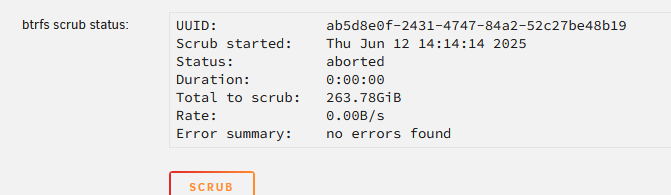

I stopped the VM and tried to run the scrub again, but it immediately aborts:

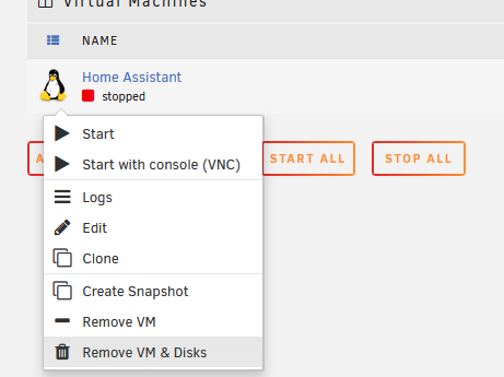

So now I am trying to remove the VM from my server through the UI, but it just hangs and does nothing. If I refresh, it seems nothing happened at all.
If I try this:
It will just stay stuck like this:
And if I refresh it just goes back to saying stopped.

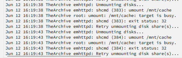

I then decided to stop the array to see if that or putting it in maintenance mode would help.
Now the server is stuck trying to stop the array. It seems that it can't unmount the cache because it's busy:
I'm not sure where to go from here.

Found that running the command umount -l /dev/loop2 allowed the cache drive to be unmounted.

If the scrub is aborting, there's an issue with the filesystem, recommend backing up and reformatting.
