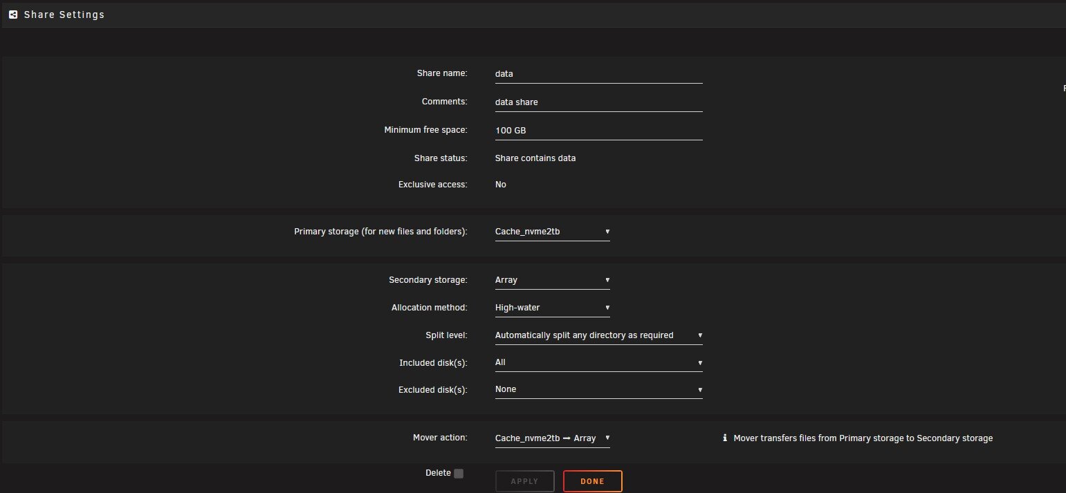

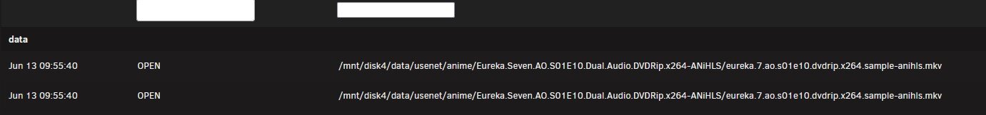

I cant figure out why my disks are keep getting utilised despite have a 8tb cache drive as the main primary source of storage. Whilst the downloader is running I am seeing file activity on a disk in the array, its very low writes but i don't think my drives should be touched, especially with docker running on its own ssd.

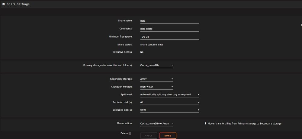

I am using the trashguides <Data file structure with usenet as a subdirectory for downloads inside. I have uploaded some screenshots plus the diagnostic data

I moved over 7tb last night and now I am starting it up with a empty cache drive. If im not moving at the same time as downloading then why is this action happening for a file that has just finished now. Why does disk 2 need to be utilised when the file will be on the cache drive saznbd is the client and is moving it to completed category for arr client to pick it up.
Jun 13 11:07:27
OPEN
/mnt/disk2/data/usenet/incomplete/xxxxxxxxxxxxxxxxxxx
You say you moved last night, your data share is set to be moved to your array so all of its contents are now on the array, since incomplete downloads are also in the data share that'll include them.

If you want incompletes to always be on cache then the solution would be to have another share for those that is set to only reside on cache.

So just to clarify the following should work if i change Saznbd directories.
Saznbd will place incomplete download in a separate share
Saznbd will move the download from incomplete share to completed folder in the main Data share
Arr will pick up that there is a completed download and then move this to the appropriate directory such as 'Tv Shows' / Movies for example.
Run mover overnight will move the files into the array
The end result should mean that the array will only be touched when either the cache drive fills or mover is operating.
