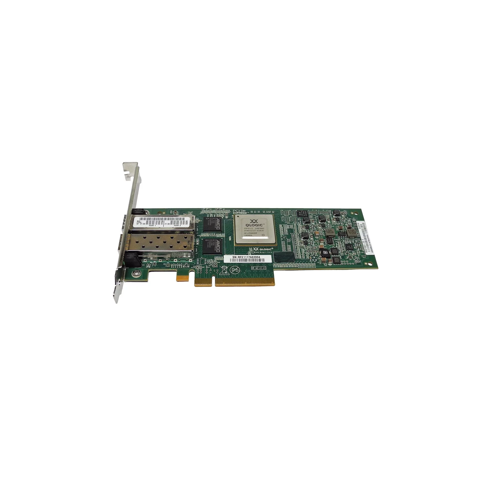

Hi everyone,
I'm hoping to get some assistance with a frustrating issue I've been facing since upgrading to Unraid 7.X. My 10Gb network interface card (NIC) was functioning perfectly with version 6, but now it no longer works across several versions of 7.
Currently, I'm running on a 1Gb Realtek onboard NIC, which is not ideal for my setup, and I would like to get the 10Gb NIC working again.
Here are some details about my setup:
- Unraid version: 7.1.2
- NIC model: QLogic QLE8152
- NIC appears in dmesg
- ifconfig -a shows no 10Gb NICs
- dmesg output attached
I would appreciate any advice or solutions that could help me resolve this issue. Has anyone else experienced similar problems with their 10Gb NIC in Unraid 7.X?

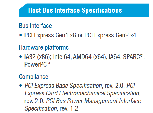

There are two versions of this card:
If he has got the Gen1 x8 one I see very little hope to get it to run in modern MoBos which usually offer 4x slots now.
And, the card has no extra room for an NVMe like the log implies.
But maybe turning the ghost off helps. he should try and report.
