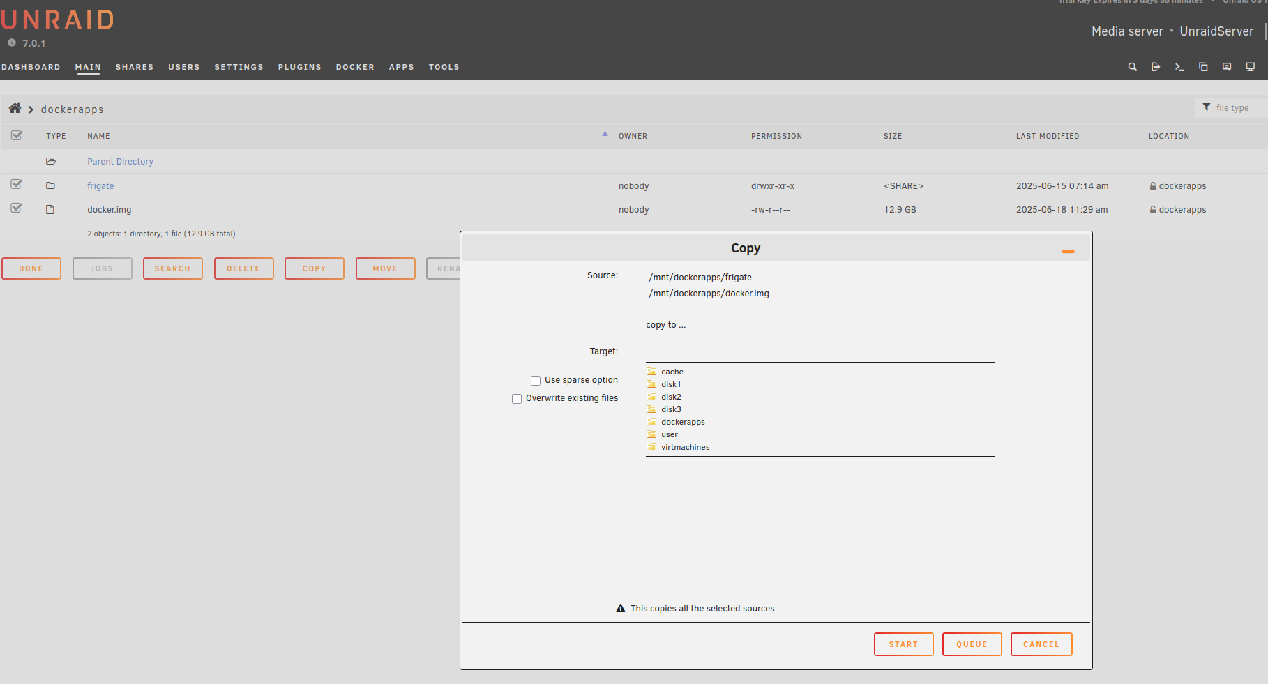

June 18, 20251 yr Author Here is what I propose to do. Note that I only have 1 NVME slot so cannot copy directly to new one. Please let me know if this is correct:Stop all docker apps.Using file manager, copy the contents of the dockerapps NVME drive to virtmachines drive (since it is currently empty).Shut down Unraid machine and change NVME drive to larger one.Boot up and assign new NVME drive to be dockerapps.copy contents of old dockerapps from virtmachines to new dockerapps drive.Start docker appsDoes it look like this will do it?unraidserver-diagnostics-20250618-1152.zip Edited June 18, 20251 yr by Steve_UR
June 18, 20251 yr Community Expert Solution Looks like you decided to deviate from the "standard" way to setup docker.DOCKER_IMAGE_FILE="/mnt/dockerapps/docker.img" DOCKER_APP_CONFIG_PATH="/mnt/dockerapps/"This means your docker.img is not actually in any user share since it is at the top level of the pool. And it means that if you don't specify "appdata" or some other user share, the appdata path for a new container may default to the top level of that pool also, which might mean a new container would create a new user share for its appdata.10 minutes ago, Steve_UR said:Stop all docker apps.That is not sufficient. You must disable Docker in Settings before you try to work with these files.
