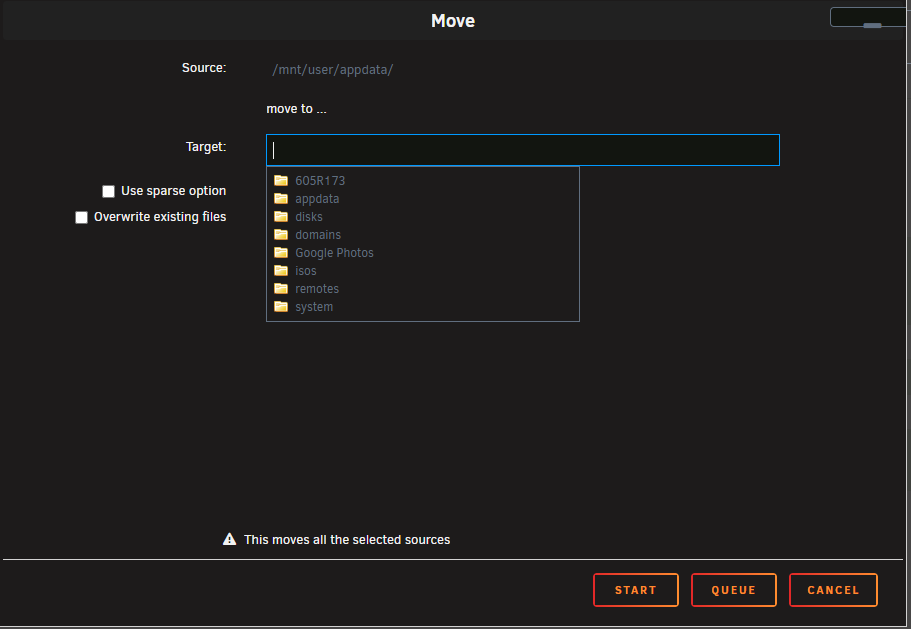

Good day all. I've spent the last 2 hours trying to get the appdata contents from my main array to a newly created secondary SSD based RAID 1 pool. I was able to create the Pool and change the appdata settings to the new pool as storage only. I disbled docker in settings and i even rebooted the server and ten tried mover and it is not moving the appdata files from the main array to the new pool. I am running 7.1.3. Any help would be apreciated. Not sure what I'm missing or should I just use unbalance to move the files?
Mover will only take ction if you have both Primary and Secondary Storage set.
You could also use the built-in File Manager to do this.
The built in file manager does not allow moving to the cache drive. Its not in the target pull down. I'm pretty sure I tried adding the secondary but you think I should do the pool as the secondary and they swap them after the operation is completed?

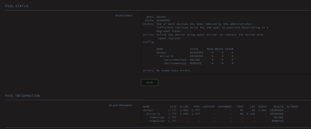

Thanks @itimpi , another related question. i created the secondary pool but it looks like i missed something. this is how the pool is showing its status:
Pool is degraded because one of the devices was removed, possibly dropped offline, post the diags if you didn't reboot yet.
You were right, the drive is on a PCIe card adapter, and it got loose. I reseated it and it's now functioning properly.
