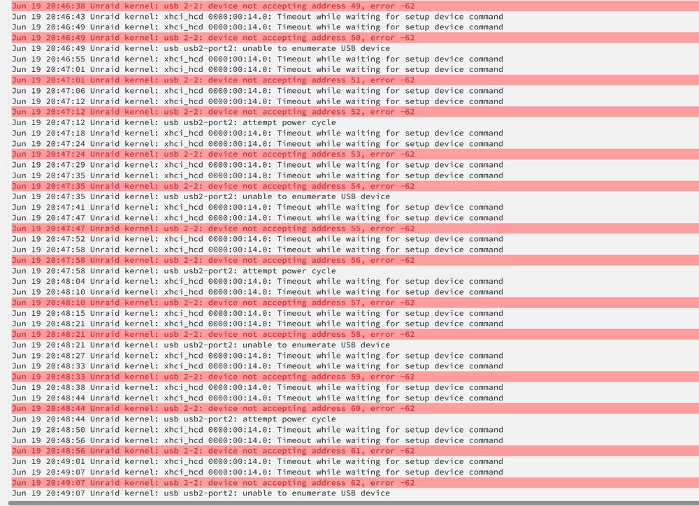

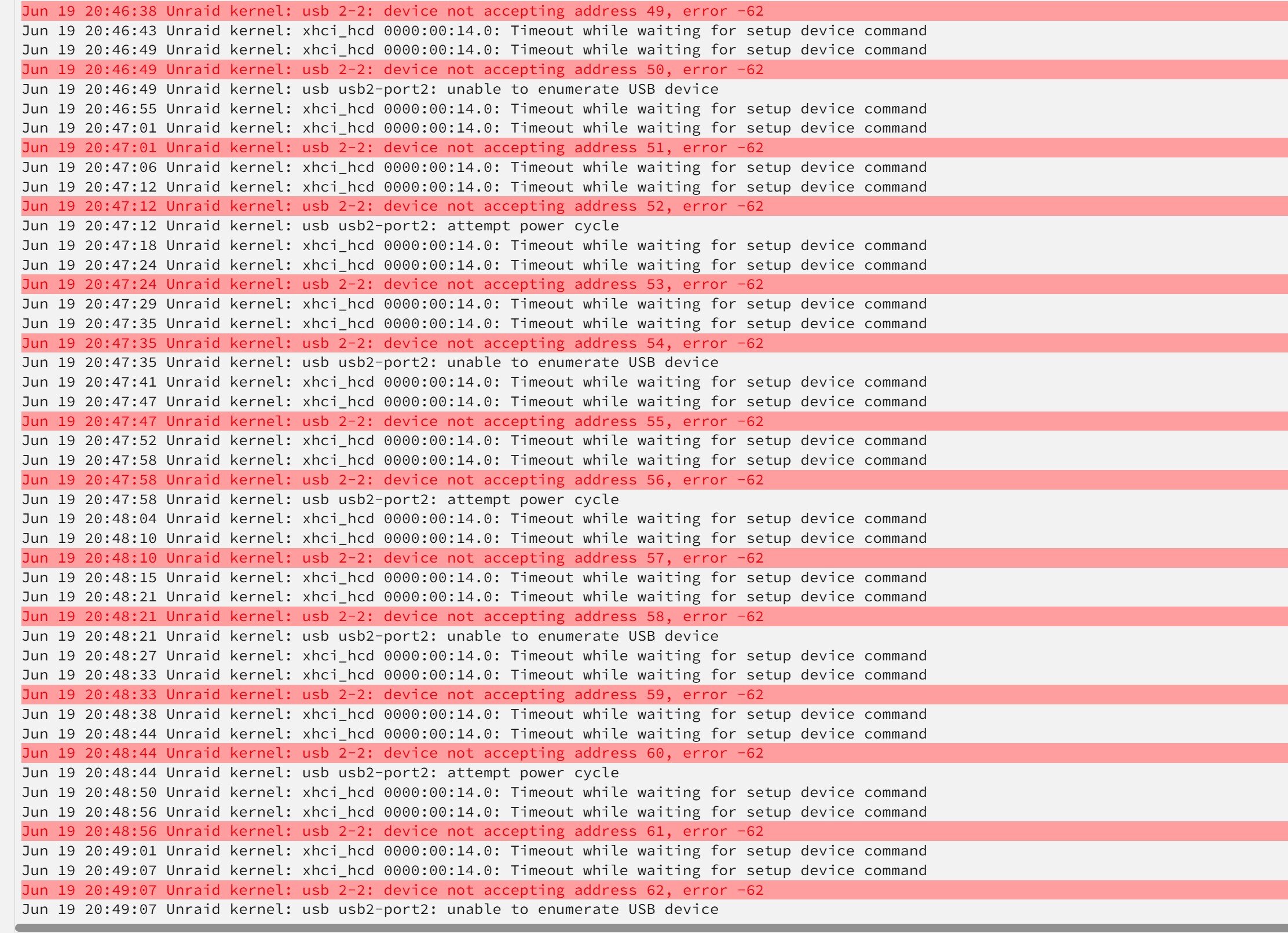

After the unraid system is turned on, error logs keep appearing
This error log seems to be related to the USB device, but I only have a bootable USB drive installed at the moment.The system version was upgraded from 7.1.2 to 7.1.3, and the latest motherboard BIOS was also upgraded.Does anyone know what causes this?屏幕截图 2025-06-19 204952.jpg
Likely the Connect issue with MSI boards, but for some reason lsusb is empty on the diags, post the output from lsusb

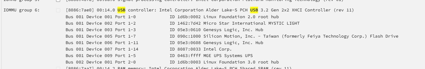

My motherboard is indeed MSI B660M.There are currently two problems, one is the background error log, and the other is the webui stuck,It takes tens of seconds for docker and vm information to appear.Here is the output of lsusb
root@Unraid:~# lsusb
Bus 001 Device 001: ID 1d6b:0002 Linux Foundation 2.0 root hub
Bus 001 Device 002: ID 1462:7d42 Micro Star International MYSTIC LIGHT
Bus 001 Device 003: ID 05e3:0610 Genesys Logic, Inc. Hub
Bus 001 Device 005: ID 090c:1000 Silicon Motion, Inc. - Taiwan (formerly Feiya Technology Corp.) Flash Drive
Bus 001 Device 006: ID 05e3:0608 Genesys Logic, Inc. Hub
Bus 001 Device 007: ID 8087:0033 Intel Corp.
Bus 001 Device 009: ID 0463:ffff MGE UPS Systems UPS
Bus 002 Device 001: ID 1d6b:0003 Linux Foundation 3.0 root hub
