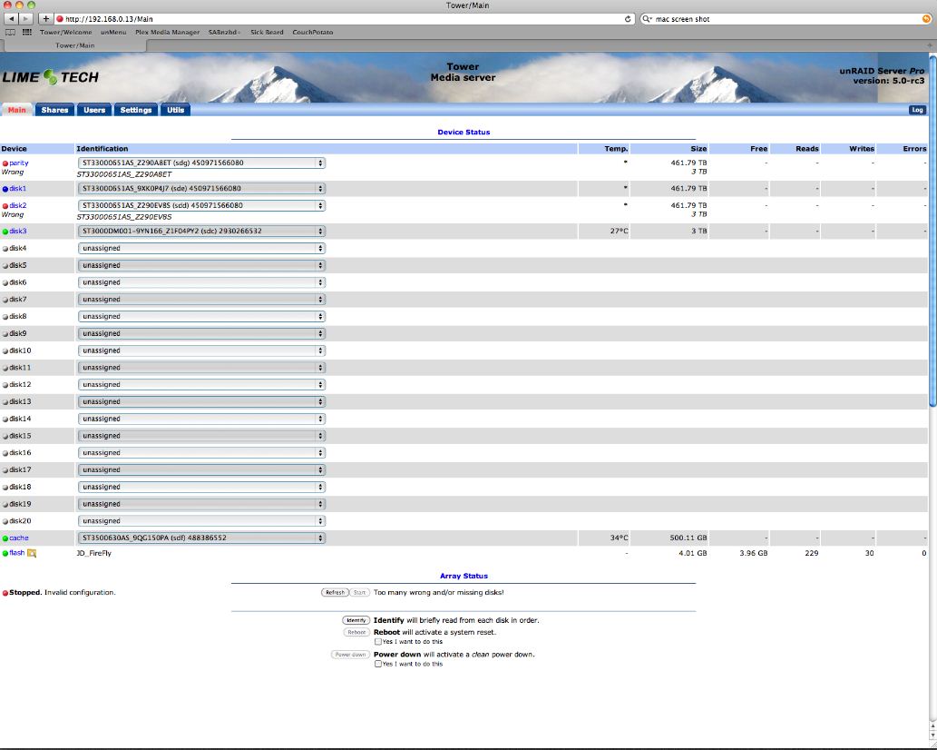

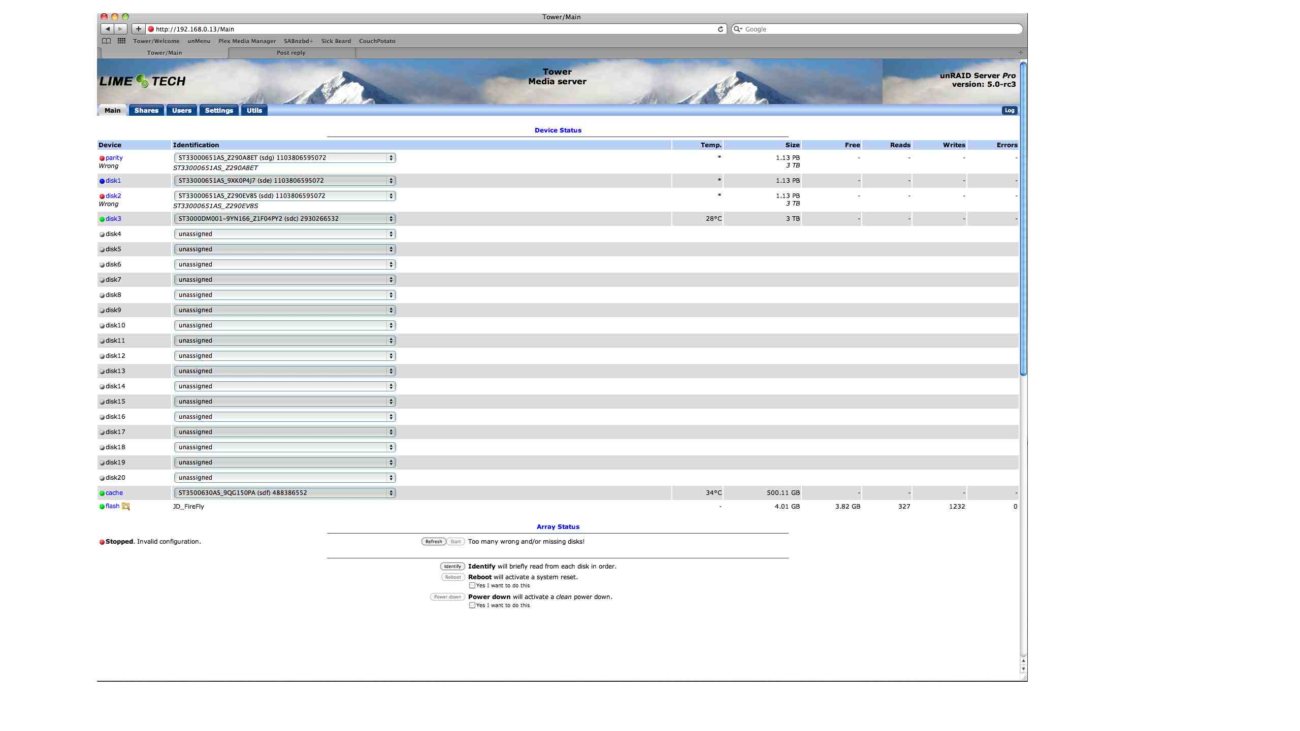

I changed all my drives over to the Supermicro MV8 add-on card and I am still getting disk errors.  I'm now getting these errors much more frequently, every three to four days, and I'm now getting multiple disk errors.  Attached is a screen shot of what I had today with all drives on the MV8.  Initially, with the array running, disk 1 was red balled and all other disks were green, all disks were spun down.  I stopped the array and the attached screen shot shows what I saw.
I don't know much about computers and was only able to build my server with the help of users on this forum.  I really need help troublshooting this problem.  I'm guessing this is probably a hardware problem?  Is it time to start replacing parts?  Anything else I can to do further get to the bottom of this?

Something else is going on (I think) since the two drives are marked as "wrong'  (as if they changed their serial number or their size changed)
If you can attach a syslog to your next post.
Looking at your screen shot... the disks did change their size... dramatically.
They went from 3TB to over 461TB each.  ;)  Did you change the server time? (to a date about 20 years from now?  8))

The disks are probably just fine.  It is unRAID which is calculating the sizes incorrectly.
(unless you really do have a few 1.13PB drives.  ;)8) 8) 8) 8) 8) 8))
