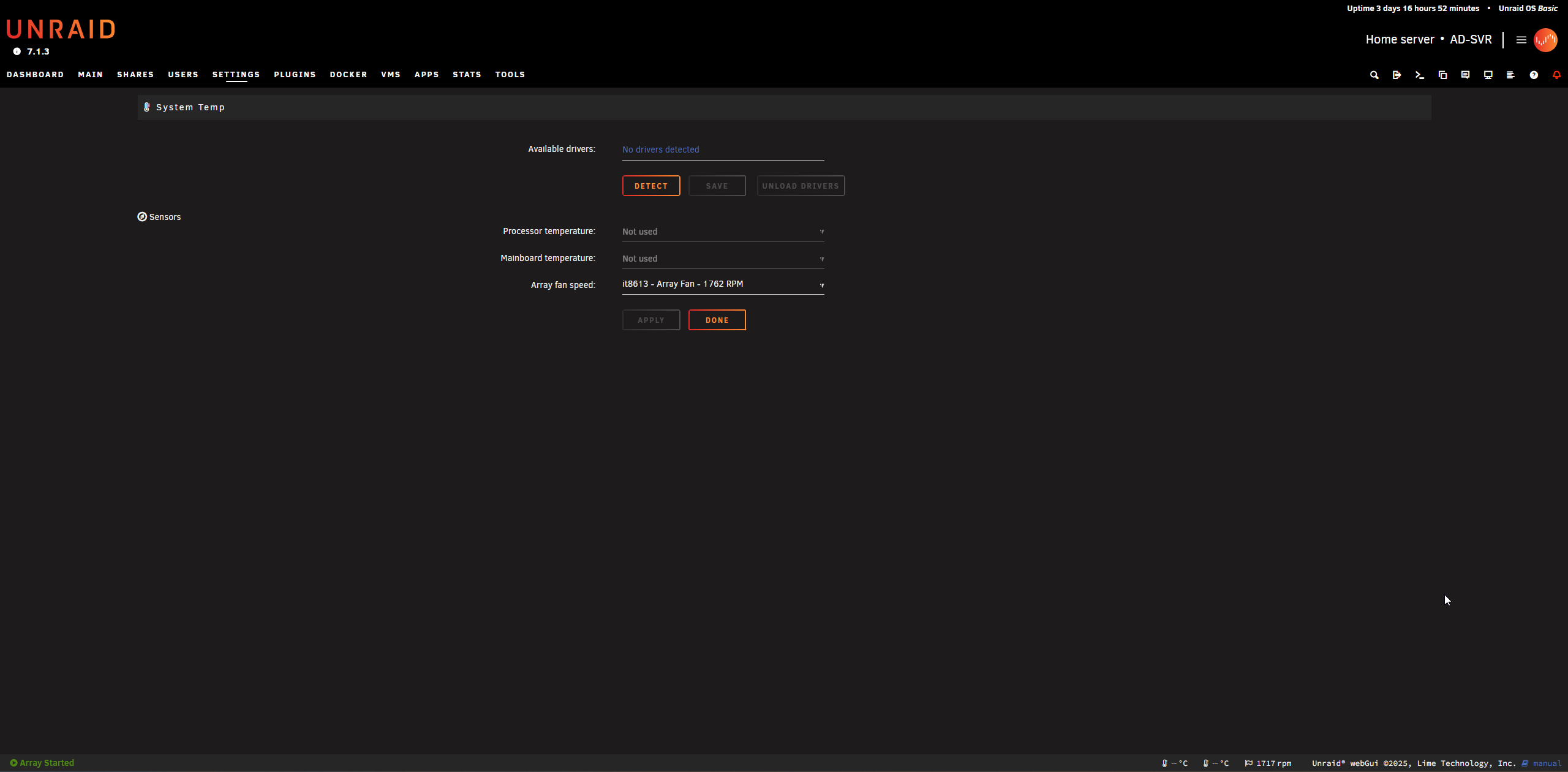

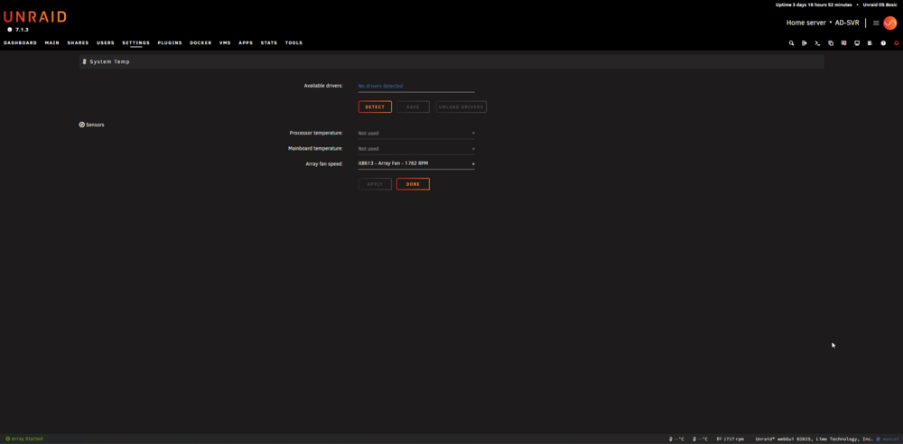

June 23, 20251 yr Hello dear Unraid community.I've the AOOSTAR WTR PRO AMD Ryzen 7 5825u 4 Bay Nas Mini PC 16GB RAM.I spent days in google, Unraid Community, Github, also with DeepSeek & Chat-GPT trying to find a way to get that plugin works to monitor at least the disks temperature to set the Disks threshold while writing Parity and to also Monitor My NVME Cach Drive.Unfortunately no success.I kindly ask for your help.many thanks
June 24, 20251 yr You can add your sensors into the drivers.conf file and that should make them appear in the plugin settings (might need to stop / start the array).In a terminal window type: touch /boot/config/plugins/dynamix.system.temp/drivers.confand after that nano /boot/config/plugins/dynamix.system.temp/drivers.confadd the following lines:it8613k10tempnvmepress ctrl + o followed by enter followed by ctrl + x to write your changes and exit.

August 5, 2025Aug 5 On 6/24/2025 at 8:36 AM, tabish121 said:You can add your sensors into the drivers.conf file and that should make them appear in the plugin settings (might need to stop / start the array).In a terminal window type: touch /boot/config/plugins/dynamix.system.temp/drivers.confand after that nano /boot/config/plugins/dynamix.system.temp/drivers.confadd the following lines:it8613k10tempnvmepress ctrl + o followed by enter followed by ctrl + x to write your changes and exit.Thank you for this! You are the man. Unfortunately no mainboard sensors show up... but cpu temp is good enough.On 8/1/2025 at 5:12 AM, ramongarciabeceiro said:Hola amigo! Estoy interesado en comprar este equipo y veo a poca gente interesada en usarlo con unraid. Uso unraid con un miniPC y me interesa seguir usándolo con este equipo si finalmente lo compro. Me parece un equipo que se ajusta perfectamente a mis necesidades. Mi idea es usarlo como servidor plex además de usarlo para todos mis otros contenedores docker. No he visto casi ningún comentario del uso de este equipo con el contenedor plex. ¿Has conseguido hacer transcoding por hardware en plex? ¿Que memoria ram tienes actualmente funcionando? SaludosUtilicé el traductor de Google, perdone cualquier malentendido sobre sus preguntas.The device has been good enough for me. I'm only here because temperatures weren't available at first, you'll run into a lot of little things like that because it is made with lesser known Chinese hardware. I have enjoyed it and have not had any significant problems. I use jellyfin, not plex, so my experience won't be exactly the same as yours if you use plex. AMD processors do not transcode very well, so that will be your biggest limitation. You might want to find an Intel based machine, or one that can take a small NVidia GPU if transcoding is that important to you. Outside of transcoding though, this is the perfect pre-built NAS for me. I have 32gb of ram, and have barely ever gone past 30% use age. Unless you're running heavy containers, you're probably fine with 16gb. Edited August 5, 2025Aug 5 by ignitionnight

October 13, 2025Oct 13 I've got the WTR Max and have followed similar steps, but still see no temperature. Any differences for the Max vs the other ones? Thanks!

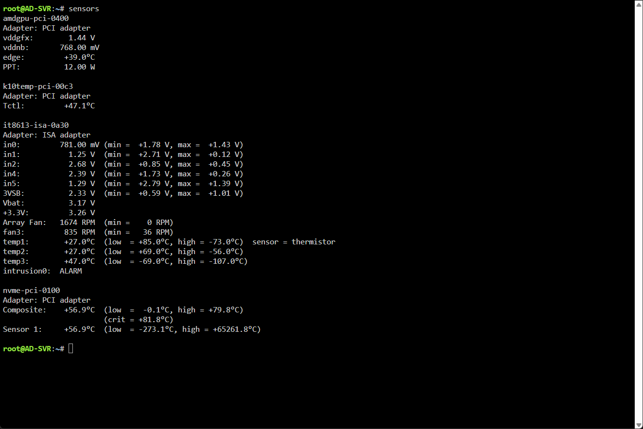

October 25, 2025Oct 25 For anyone looking for CPU temperature monitoring for the AOOSTAR WTR MAX, this worked for me linkSimply edit /boot/config/goAdd in these lines # sensors via https://forums.unraid.net/topic/111683-no-fan-control/modprobe it87 force_id=0x8620rebootYour sensors will then look like this# sensorsamdgpu-pci-0100Adapter: PCI adaptervddgfx: 1.42 V vddnb: 765.00 mV edge: +37.0°C PPT: 29.08 W (avg = 6.09 W)k10temp-pci-00c3Adapter: PCI adapterTctl: +40.4°C it8620-isa-0a30Adapter: ISA adapterin0: 1.08 V (min = +0.00 V, max = +3.06 V)in1: 1.30 V (min = +0.00 V, max = +3.06 V)in2: 2.35 V (min = +0.00 V, max = +3.06 V)+5V: 4.75 V (min = +0.00 V, max = +6.12 V)in4: 768.00 mV (min = +0.00 V, max = +3.06 V)in5: 2.65 V (min = +0.00 V, max = +3.06 V)in6: 1.98 V (min = +0.00 V, max = +3.06 V)3VSB: 5.50 V (min = +0.00 V, max = +6.12 V)Vbat: 3.46 V Array Fan: 1442 RPM (min = 0 RPM)Array Fan: 1477 RPM (min = 0 RPM)Array Fan: 1182 RPM (min = 0 RPM)CPU Temp: +41.0°C (low = -128.0°C, high = +127.0°C) sensor = thermistortemp2: +32.0°C (low = -128.0°C, high = +127.0°C) sensor = thermistortemp3: +40.0°C (low = -128.0°C, high = +127.0°C)temp5: +41.0°C temp6: +41.0°C intrusion0: ALARMnvme-pci-6900Adapter: PCI adapterComposite: +35.9°C (low = -273.1°C, high = +65261.8°C) (crit = +84.8°C)Sensor 1: +35.9°C (low = -273.1°C, high = +65261.8°C)Sensor 2: +40.9°C (low = -273.1°C, high = +65261.8°C)enjoy
