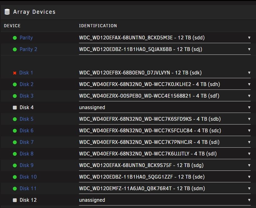

Woke up to alerts on my server looks like disk1 has 1922 errors and has been disabled and contents emulated.
Server kernel: md: disk1 write error, sector=11070194240server-diagnostics-20250625-1030.zip
Will be looking for a new replacement drive today but not sure if I need to do anything with a disabled drive or can I replace as normal?
Looks like it dropped offline, check the cable/connections, reboot and post new diagnostics

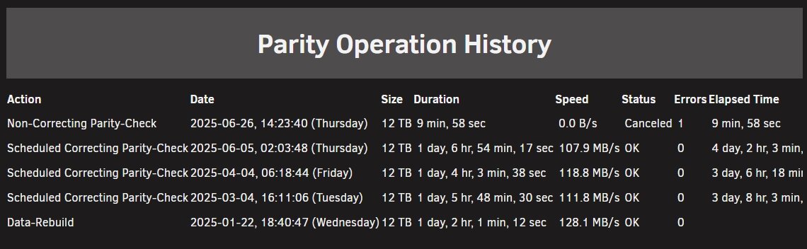

Replaced disk but something happened and all the drives went offline, the disk rebuild paused, so went shutdown and went back to check everything and started server up again. But now it doesnt seem to be rebuilding the disk. I have just stopped the array.
server-diagnostics-20250626-1437.zip
Do I need to set disk1 back to no device start array, stop array then assign the new 12TB drive?
Looks like the HBA lost contact with the expander, all disks dropped at the same time.
Before starting to rebuild again, make sure emulated disk1 is mounting, also worth check/reconnect the cables to the expander.
Checked all the connections and removed and added the HBA card back in. I think the breakout cable was loose this is now clicked in.
The disk is available and emulated and has option to spin down but dont see how to start rebuild.
Ok got it, drive is rebuilding!
