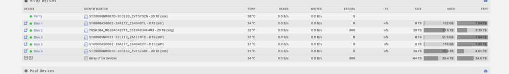

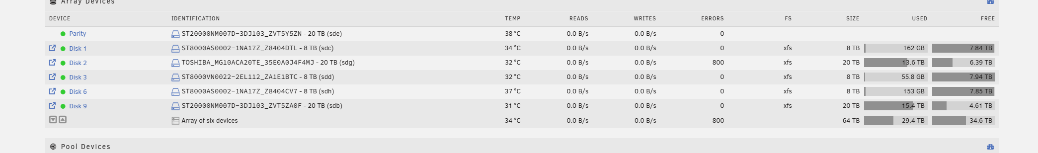

What I have done from here is to buy a new disk, box fresh, zero'ed and put it in the system. From there I have emptied my 3 x 8 TB disks onto the new 20TB disk. Al went well, all was good :)

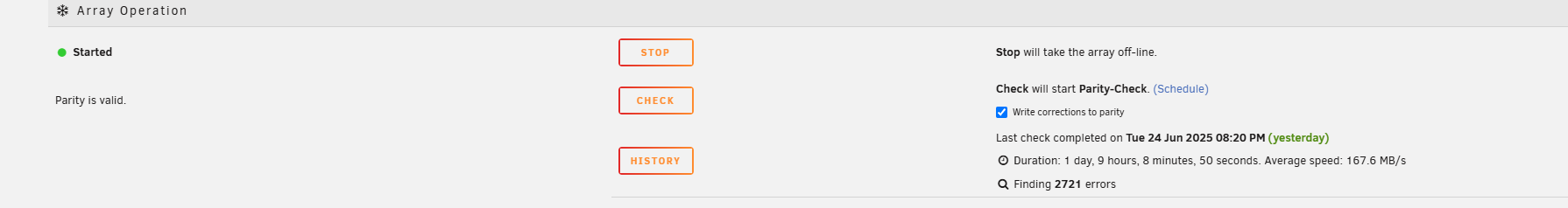

Then I decided to run a check, before taking all the 8 TB disks out, and just run with 2 x 20TB disks and a 20 TB parity drive. When I did this, I got errors on the new disk, and corrections to the parity:
Question is - whats up with my server? Is this normal, or do I just have a bad parity or what? :D Let me know If I need to send anything, and ill do so.

It's not logged as a disk problem and SMART looks fine, check/replace cables for that disk and try again.
Its all new cables, bu tI can try and swap between two disks(one of them that needs to be pulled anyways), and then I will try to run a check agian.
Should I still have the Write corrections to parity - marked when I do this?
Yep
