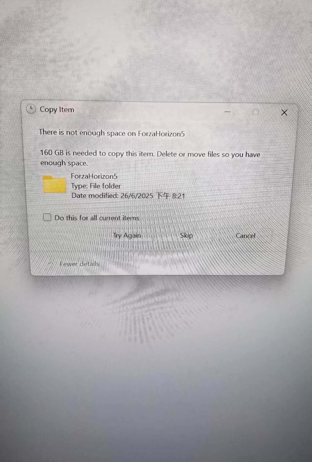

I have unraid 7.01 with 2 disks array, and 1 disk pool device. the problem is not enough space when I tried copy 160G documents from windows to pool device named datapool, but actually the disk has 12.7TB free space and 3.28TB used with btrfs system.Partition format:GPT: 4KiB-aligned

when I tried copy anyway ignoring the alert message, when it copy until about last 10%, alert message will show again, and can't copy anthing more. used metadata UDP wil jump to 3.9G, so I guess it might related to the metadata space. but I dont know why total metadata UDP is only 4G, and how to expand it.

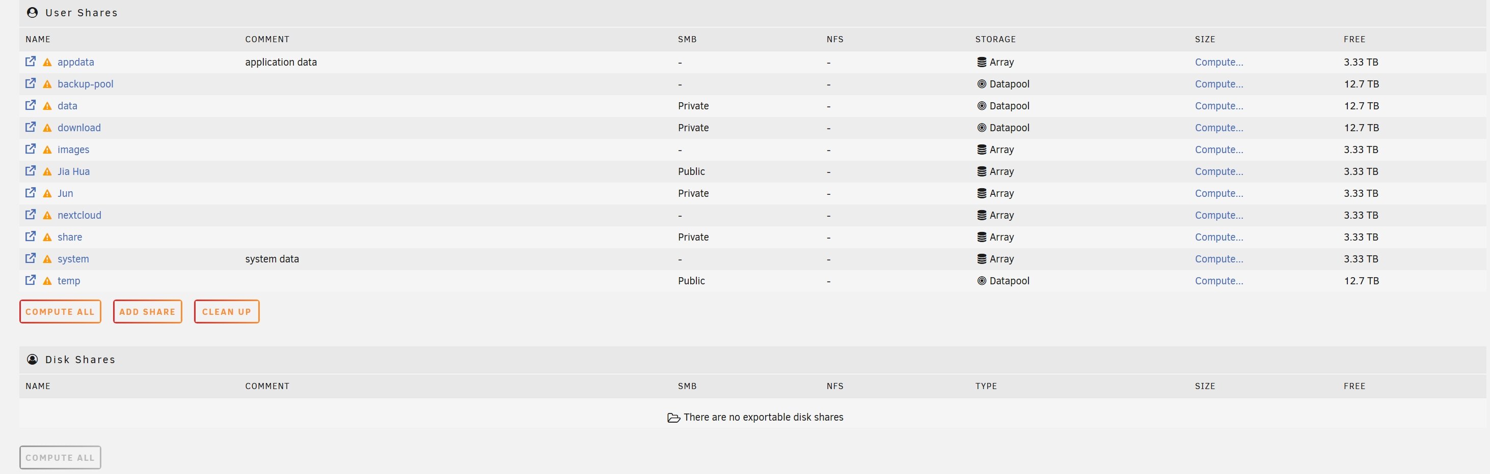

You have both disk share and user share enabled, that's not recommended because it's prone to user error, but I don't see what would cause the stated issue either.

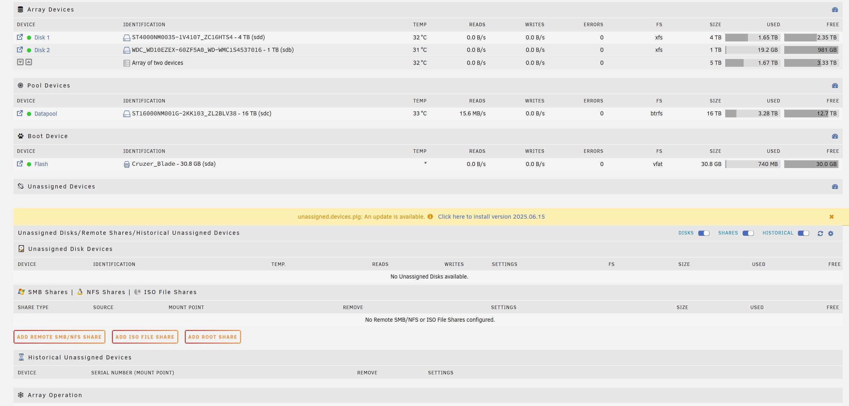

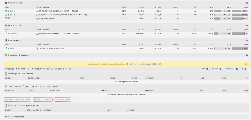

here is the setting.
i dont have disk share now. before i tried it.
I have 2 apps on docker which set download folders on datapool, one is qbittorrent which is on, another is FileBrowser-PNP which is stopped. I dont find any setting may relate to the problem.

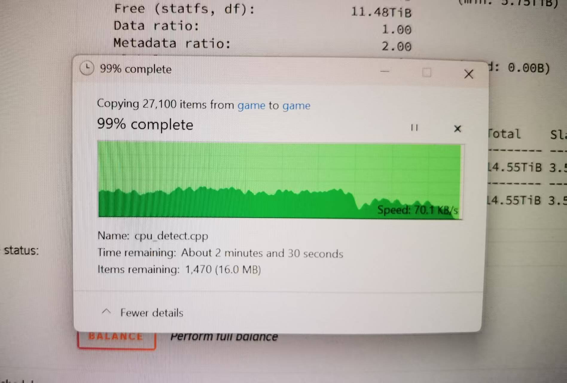

I have copied two folders (30G and 40G+)to the same directory(/datapool/data), it worked.
but at the almost end of copying process, the speed goes down to 100+kb

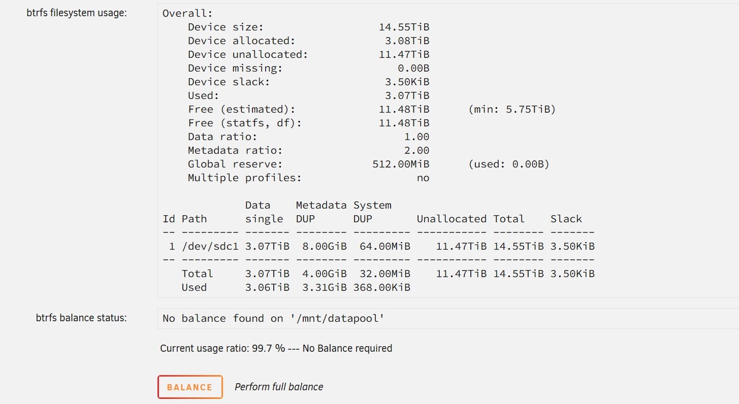

and here is the btrfs filesystem usage info:
I cant understand, why Device allocated: 3.08TiB, meanwhile keep Device unallocated: 11.47TiB. it seemed only use the "data single" space.
This is normal with btrfs, it will allocate more space as needed.
