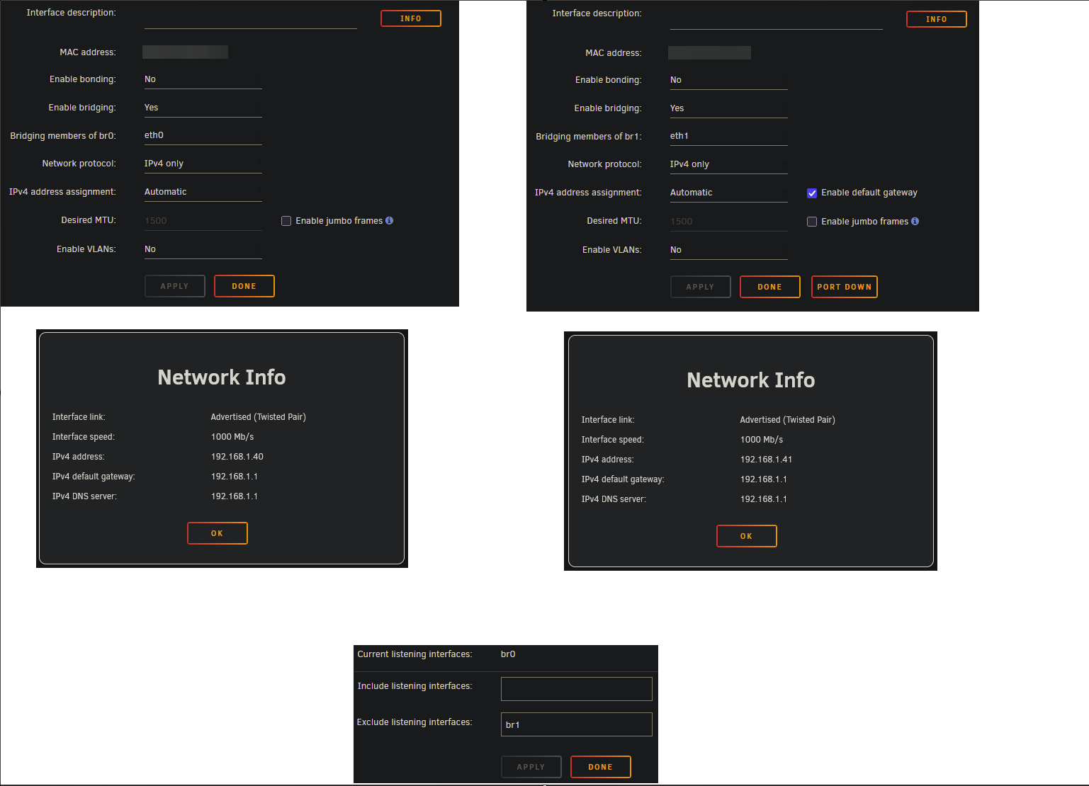

I'm trying to fully segregate Unraid and a Dockerized NGINX instance using two physical NICs:
  • Unraid is bound to br0 (NIC 1)
  • NGINX (container) is bound to br1 (NIC 2)
The intention is to isolate the traffic paths and allow communication from Unraid → NGINX.
Network Interface Setup
I’ve correctly configured Unraid’s network settings:
  • br0 and br1 are assigned to separate NICs
  • No IP conflict
  • Bridging and assignment are set as expected

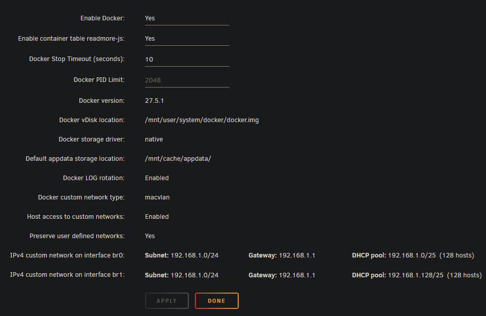

Docker Settings
Docker is set to use macvlan as needed, with custom bridge support enabled.

Looking for guidance on:
  • Why br1 is not registered as a usable Docker network despite startup logs saying otherwise.
  • Whether Unraid is doing partial setup (interface only) but not registering it with Docker’s IPAM
Thanks in advance for your time and help.
Solved by DespairServices
Solution was to ditch bridges and forcefully map the container's ports in extra parameters:
-p '192.168.1.41:80:80' -p '192.168.1.41:443:443'
However it is interesting to note that Unraid's UI mixes up the actual IP addresses, perhaps this is a bug, not sure:
ALSO (very important), uncheck the "enable default gateway" for the secondary interface because otherwise you will have an industrial quantity of asymmetric routing which will break your services.
