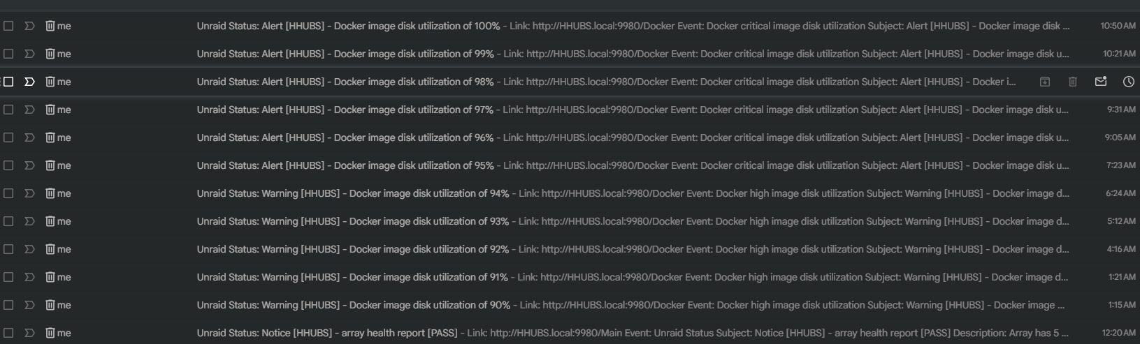

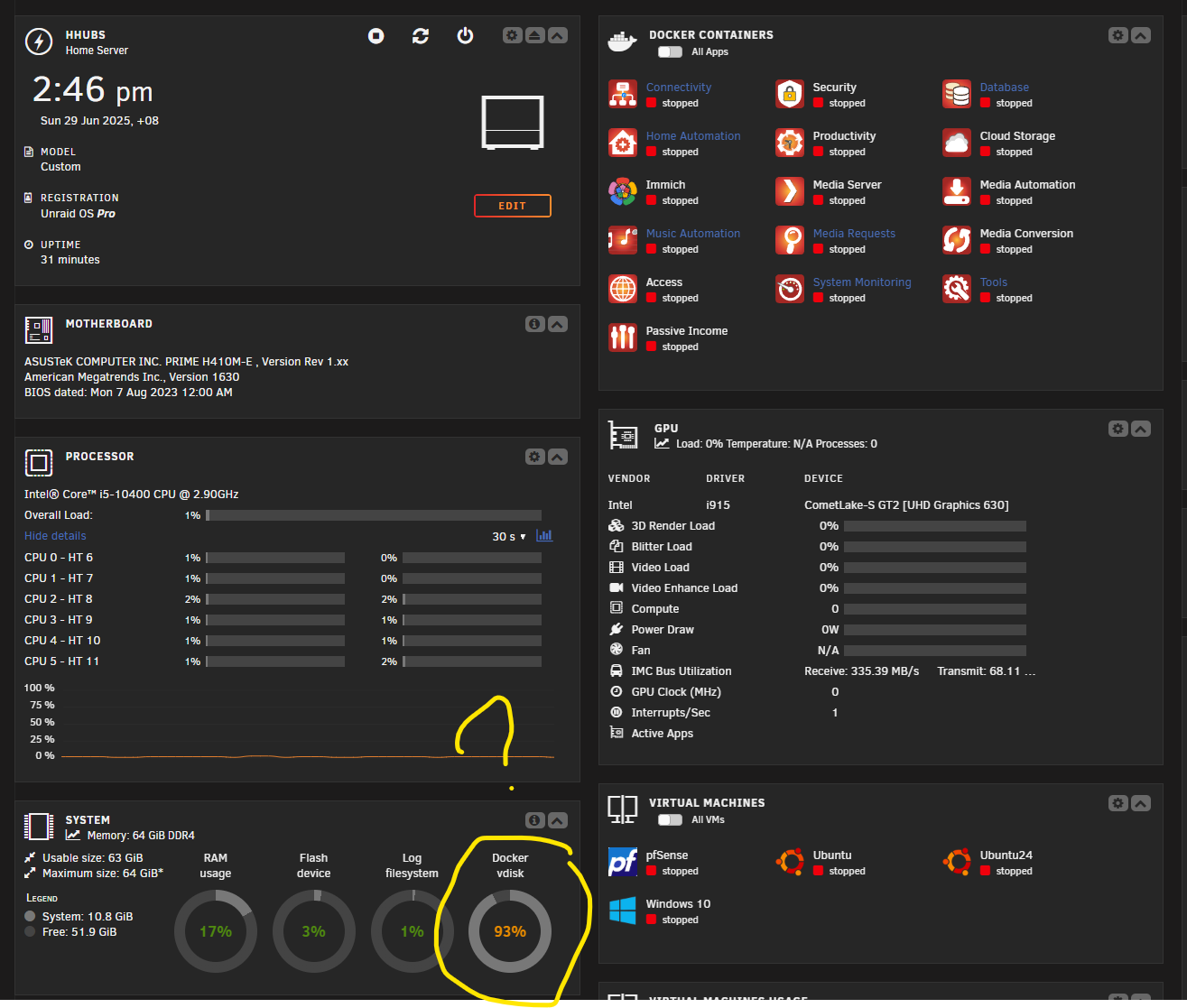

Hello, please help me. My Docker VDISK becomes 100% overnight. Yesterday I updated to 7.1.4(from 7.0.1).
I use the spaceinvader script to check and delete unconnected volumes and orphan images, but still 100% docker vdisk usage. So I downgrade back to 7.0.1, thinking that the script no longer works on Unraid 7.1.4.
I am now back to version 7.0.1 and tried the script again, but no success. Then I stopped all the Docker containers one by one to see whose eating Docker vdisk, but no success again. All of my containers are now stopped, but still, I have 93% Docker vdisk usage. What's happening here?
