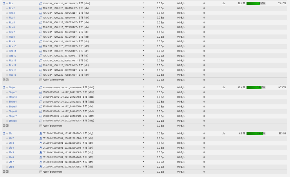

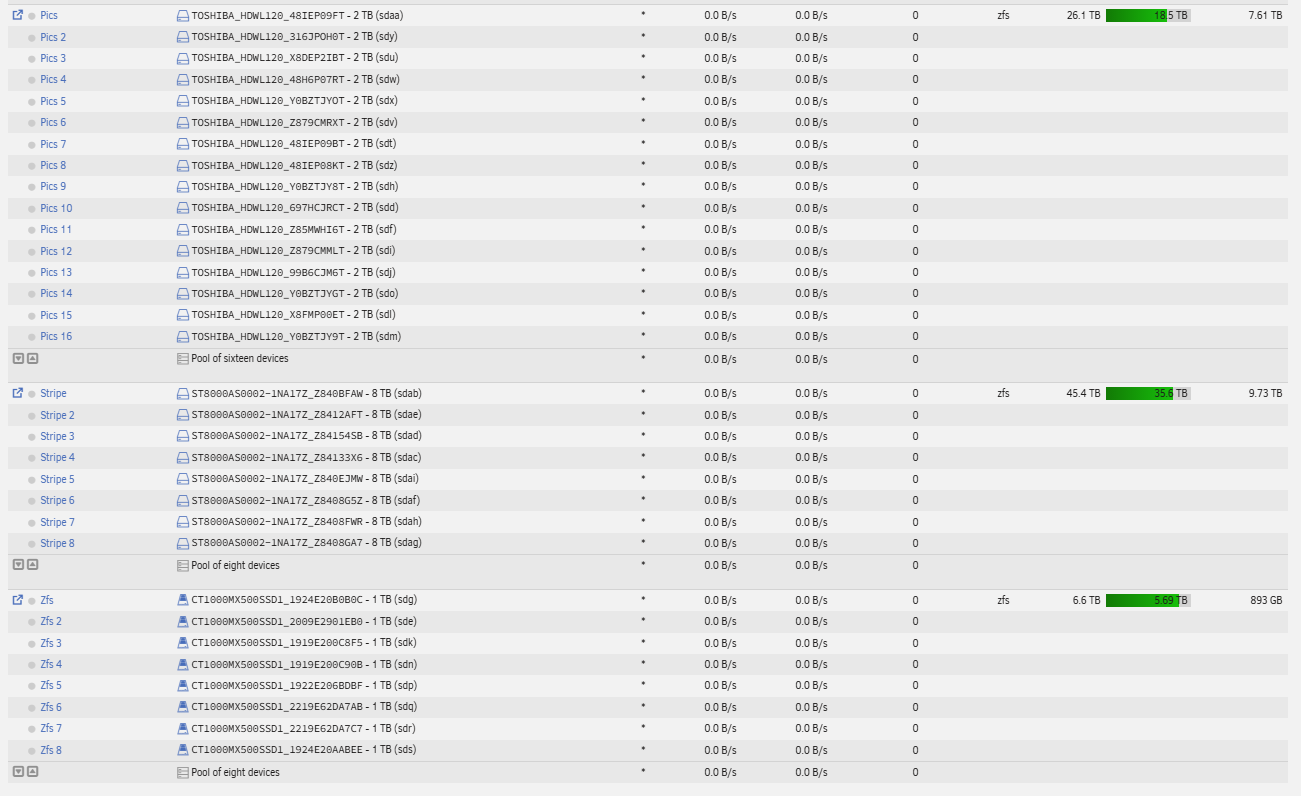

Solved by MetricTonto
You don't need any other setting other than enable spin down, and as long as nothing is using the pools, they will spin sown normally:
