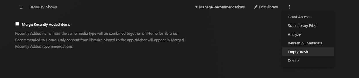

then in plex make sure you run thorugh the basics for library scanning..
and make sure you empty the trash to each of your libraries
Scan Library files and Refresh all metadata...
you can scan all your libraires for new content

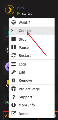

There are two ways to interact with a container:
  1. image.pngThis will open the conatiner console where you can run the commands inside the container shell.
  2. image.png Click this button to open up the unraid console and type in docker exec -it plex followed by the command needed for sqlite db recovery (note: the container name in this command needs to be spelled exactly like it's named on your system and is case-sensitive)
