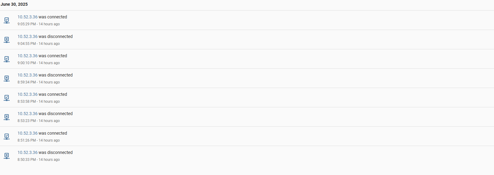

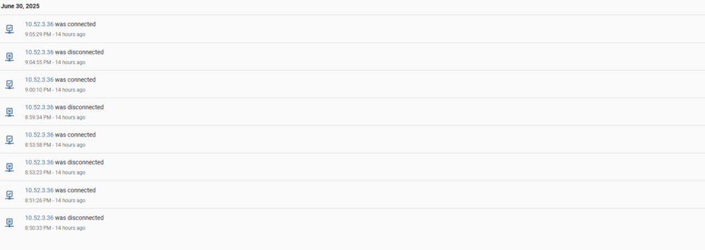

I have an intermittent issue. It went away when I updated to v7 but now on 7.1.4 it is back. My server doesn't crash, but it does become completely unreachable (including docker containers, and VMs) for a period of time. Last night this happened from 8:50:33 pm to 9:05:29pm (logs from Home Assistant VM pinging unraid server attached as screenshot).

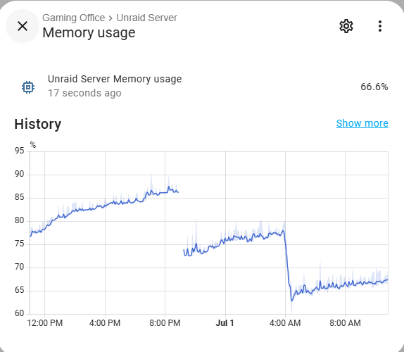

When the server crashed, it was reporting ram usage at 86.2%, which I can't imagine is enough to crash the server. I have attached a photo of the graph of RAM at this time. Also, none of my drives seemed to be under heavy load. I do have 2 SMR drives, which are in the process of being phased out, so I am wondering if they could be the cause. However, they have no issues with SMART tests, and run perfectly fine during parity checks and mover operations.
