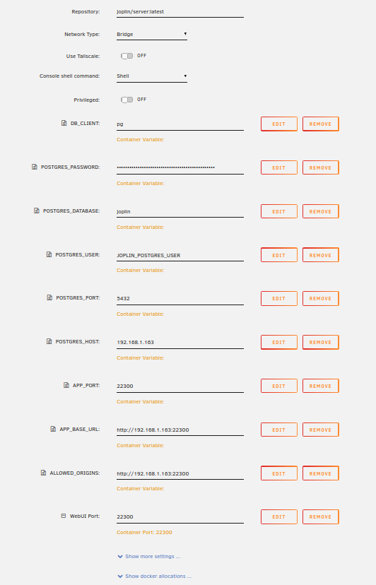

I'm trying to setup joplin/server:latest, using the following variables (through the GUI):
-p 22300:22300
-e DB_CLIENT=pg
-e POSTGRES_PASSWORD=your_db_password
-e POSTGRES_DATABASE=joplin
-e POSTGRES_USER=JOPLIN_POSTGRES_USER
-e POSTGRES_PORT=5432
-e POSTGRES_HOST=192.168.1.163:5432
-e APP_PORT=22300 \
-e APP_BASE_URL=http://192.168.1.163:22300 \
-e ALLOWED_ORIGINS=http://192.168.1.163:22300 \
When I run it, my given variables are ignored. I cannot go to the WebUI due to the origin not being allowed, and it decides it is using sqlite rather than postgreSQL.
JoplinLogs.txt
Solved by Ke3gan
try dropping the port from POSTGRES_HOST
you are already specifying POSTGRES_PORT and may be causing that option to fail
I tried that but no change I'm afraid, same log output:log2.txt
I have found the only solution I could find: I set all my variables and configuration as extra parameters, allowing UNRAID to actually add my variables to the docker run command. Also be sure to put your password in ' ' or else issues can arise.
