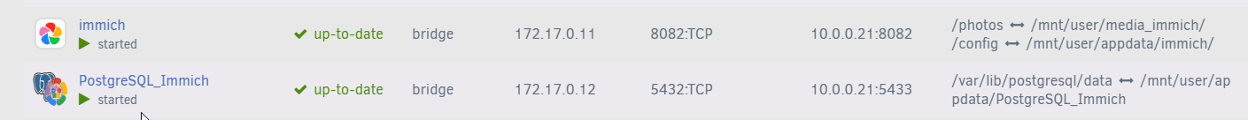

I'm running the Immich Docker container on a port 8082 vs the default port 8080 as the port is in use by another container. The container starts up without issues, but I'm unable to reach the WebUI. All other containers I'm running are reachable without issues. This was previously working without issue, but I recently changed ethernet cards on the server and have not been able to reach it since.

... you didn't setup the docker nat for immich correctly you can't change containt port off of 8080 the conatin is still using port 8080
you told unraid to use host port 8082 and changed the port for immich to alod use port 8082...
https://forums.unraid.net/topic/191526-image-genius-immich-docker-container-running-but-can-not-connect-happens-with-most-docker-containers-debug-howto/#findComment-1564290
stop immihc edit the web ui port and set that back to 8080...
