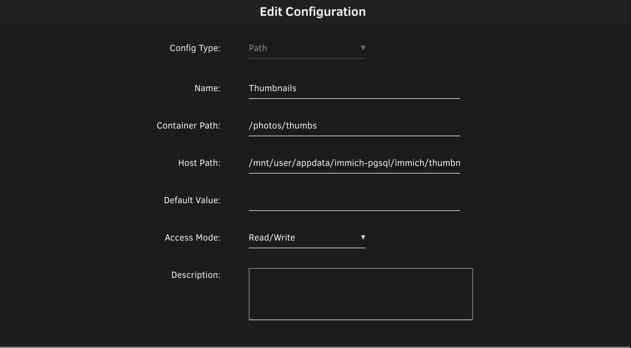

July 4, 20251 yr Hi I've tried to have Immich library run in Array and thumbs on SSD, but it always puts thumbs on array.What can I do to change it to SSD.This is my docker template.

July 5, 20251 yr Community Expert Solution The container path for thumbnails has to be /photos/thumbs for it to work. Edited July 5, 20251 yr by MowMdown

July 7, 2025Jul 7 Community Expert Yeah unfortunately this was the only way I could get it to work when using the pre-built container of Immich.It’s not clean but gets the job done.
