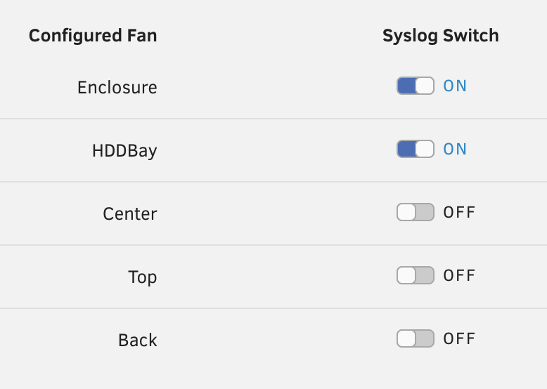

On 7/23/2025 at 8:38 PM, CkChong said:
Funny timing — I’m adding log toggle support for the next version, and each fan will have its own on/off switch for syslog logging.

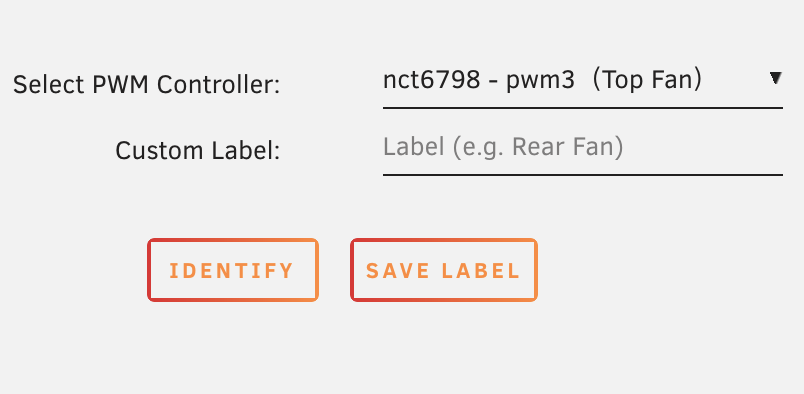

I’m also working on a new feature that lets users identify and label each PWM controller more easily, to help with reference and setup. Currently finalizing the UI and testing before release.

Just dropping in to let you know — the new version is out now, with per-fan syslog toggle included.
Hope it does the trick — feel free to report back if you hit any issues.

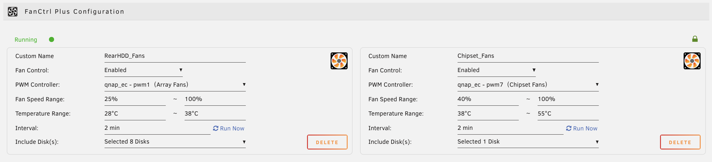

Sharing settings for my TS-873A using the QNAP-EC plugin. Went with aggressive 28°C → 38°C cooling for HDD array fans to prioritize drive longevity, and 38°C → 55°C for M.2/chipset cooling. Just implemented these settings so too early for performance data, but wanted to share the configuration in case it helps others.
Thanks for sharing your setup — always great to see how others are using the plugin!
Hope you’re happy with how it’s working so far!

Everything seems ok at the moment syslog was on and log is just a bunch of this:
"Jul 29 08:56:51 N fanctrlplus: [CASEFAN] Temp=31°C → PWM=230 → RPM=1333
Jul 29 08:58:56 N fanctrlplus: [CASEFAN] Temp=44°C → PWM=245 → RPM=1397
Jul 29 09:01:00 N fanctrlplus: [CASEFAN] Temp=34°C → PWM=230 → RPM=1328
Jul 29 12:03:03 N fanctrlplus: Manual Run [CASEFAN] Temp=53°C → PWM=255 → RPM=1433"
I did rename a unused CPU fan, and the fan went inactive since i dont use it in your plugin, rebooted and fans worked as expected, but still the widget said inactive, until today.
Strange!
Edited by theusername
added info
49 minutes ago, theusername said:
All day yesterday it was saying offline, i tried rebooting etc, but today (sofar) it's saying status:running! All I did was let some time pass. I did rename the fan labels, from casefan to CaseFan for example, but that was 2 ish days ago.
Jul 29 09:01:00 N fanctrlplus: [CASEFAN] Temp=34°C → PWM=230 → RPM=1328"
Strange!
Thanks for the update! Just to clarify — you mentioned renaming the label, but it’s possible the issue was actually related to the Custom Name, which is different from the PWM Label.
I left a note above about this — feel free to refer back to confirm which one was changed.
PWM Labels are just for display and don’t affect functionality, but renaming the Custom Name (especially with only case changes) can currently cause temporary issues in the Dashboard. That bug has been identified and will be fixed in the next version.
Since things are working fine now, feel free to keep an eye on it — and if it happens again, any extra details would be super helpful. Thanks again!
