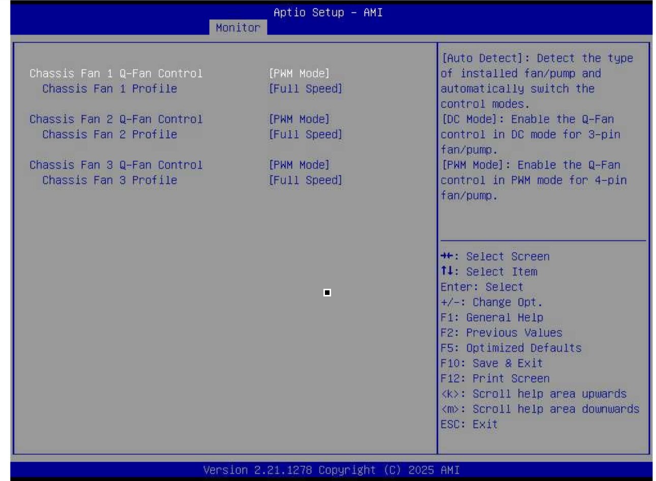

Has anyone managed to get this working with a Gigabyte motherboard? I have the Z690 AERO G DDR4 mobo which includes "Smart Fan 6" in the BIOS and no matter what setting I choose, I can't get the fans to be controlled from this plug-in or the Dynamix one.
There's no option to actually disable this automatic fan control in the BIOS so I assume I'm SOL.

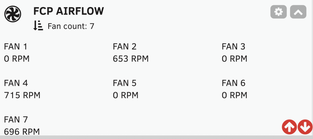

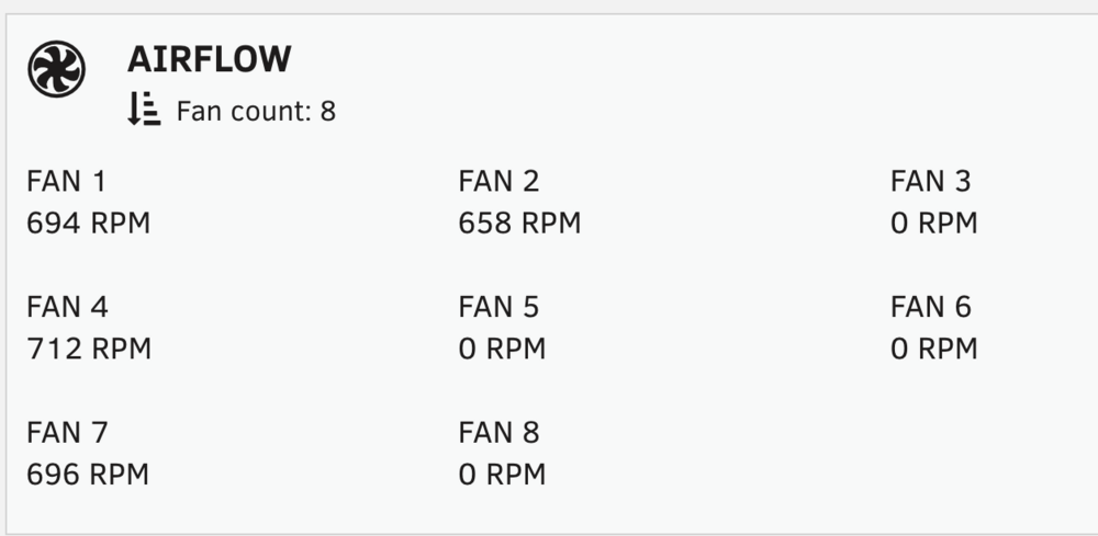

I just tried this and was able to identify the fans (the fans turned off and back on) but it seems like trying to control the speed of the fans appears to disable them and only a reboot will re-enable the fans.
My case does have 8 fans along with another fan used to cool the HBA.
There are 3 fans at the front and 3 in the middle of the case (all Noctua NF-S12B PWM fans). The HBA fan is a Noctua NF-A9x14 PWM fan.
Each series of 3 fans are connected to a fan splitter and are reporting the RPMs properly but I'm not sure if this is related to my issue, although I have tried just a single fan with the same problem.

You’re likely still fighting the BIOS/EC.
In BIOS, set each fan header to PWM in Smart Fan (not Auto or DC), then try again in FanCtrl Plus.
I haven’t used that specific Gigabyte board, so names may differ — just look for PWM mode and avoid Auto/DC.

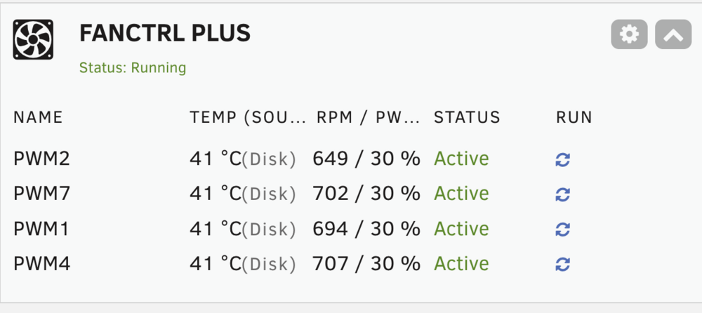

Strange behaviour here on my server. The fan control worked quite well and I am using it just for monitoring two array fans together with hdd temps. They spin up when the drives are active and switch off when they are asleep.
But: Now one fan is on full speed even if the hdds are still sleeping... where can I have a look into? The log does not point me to any direction unfortunately.
BTW: I am on a Gigabyte Mainboard and they tend to be tricky to setup with fan control... but as it worked flawless for over 10 days I am wondering what causes that issue.

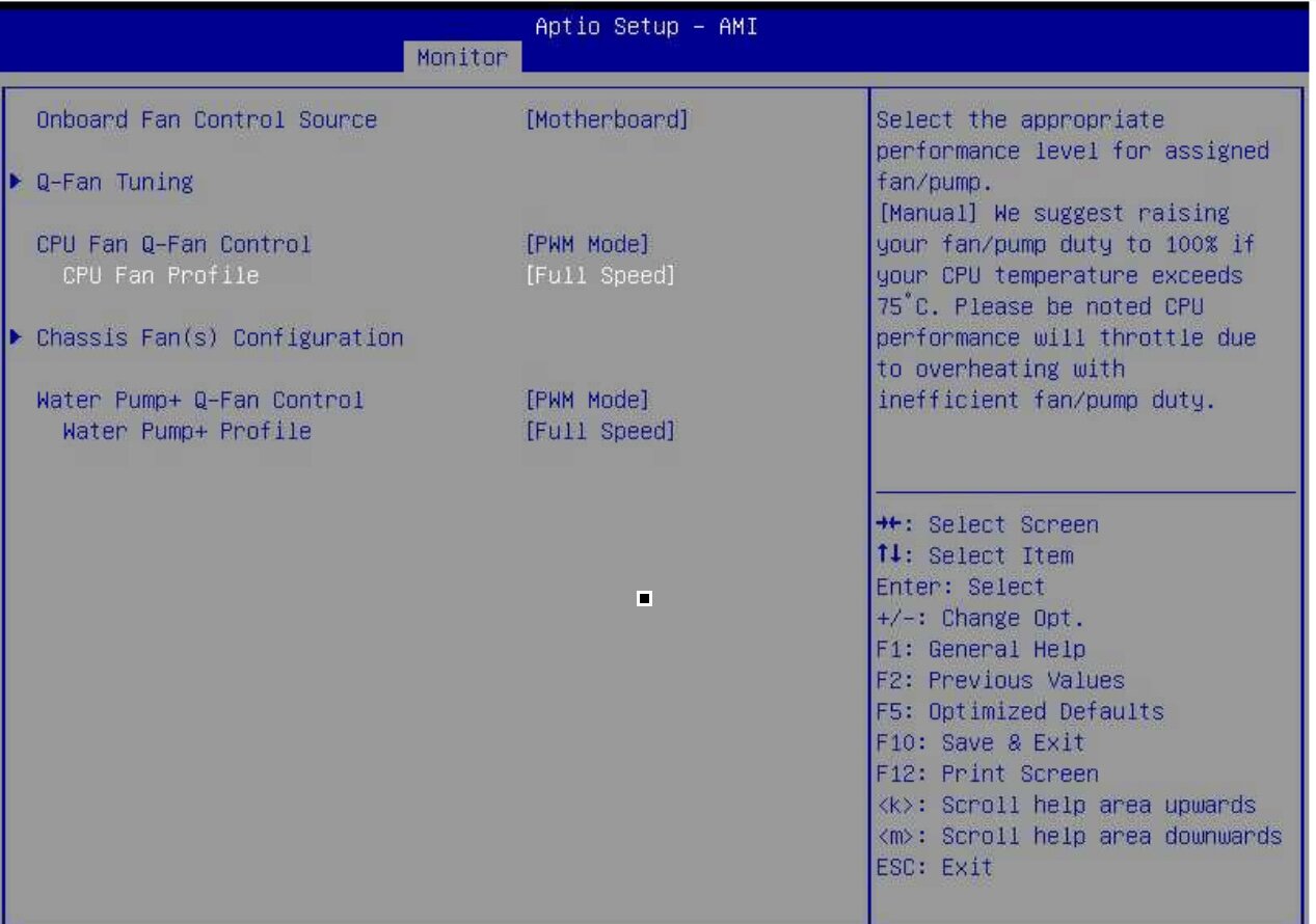

Could you try adjusting the BIOS fan settings?
Set the used headers to PWM/Manual (not Auto/DC) and disable Fan Stop/auto curve, then test again in FanCtrl Plus. This might sort it out.

I did reboot the server and jumped into the BIOS. Unfortunately all settings have already been set properly: PWM / Manual plus Fan Stop disabled... so this was not the issue... Any further ideas?
After the reboot the plugin works again as intended but I do suppose that the error will occor after some time again.

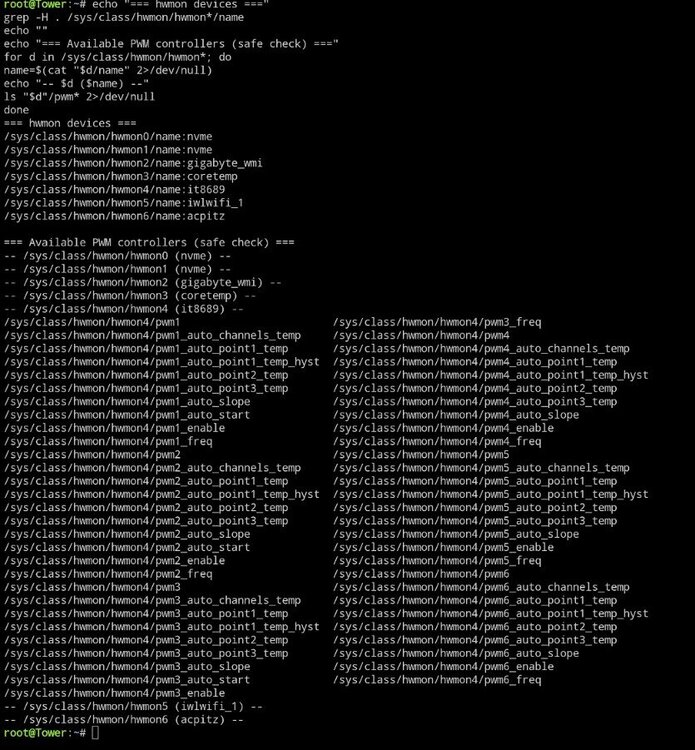

Hello,
i'm on a Gigabyte Z790 AORUS ELITE AX , Version 1.1...
It seems that i'm not able to control the fans...
In the BIOS i have set everything like you already written...
i have the Dynamix Temp plugin installed, the IT87 Plugin and all set up...
Can someone help here?!

Okay, same error. HDDs are spun down, so no temperature is shown and the two fans should remain off. Unfortunately the front fan is spinning at full speed at 1280rpms. Tried to disable the plugin and the rear fan is spinning up (as intended) but after activating the plugin only the rear fan goes down again whereas the front fan is just spinning at 1280rpms.
That said: It seems that the connection from the plugin to the front fan is somehow interrupted. Unfortunately a simple deactivate acticate procedure does not get the fan to work normal and neither does a manual operation (run now) changes anything. Only a reboot does the job.
But as my server idles when I am away it's a bit of a nuisance if this happens regularly - in this particular case after 9 days - and the log does not show anything unfortunately. Last spinup of disks has been on the 9th, full speed of one array fan on the 12th not following the plugin's parameters.
