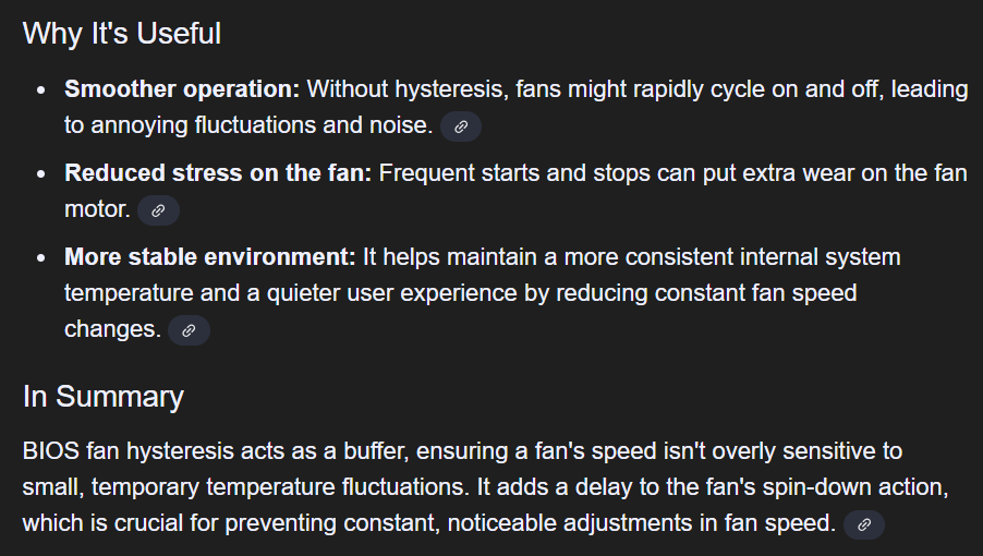

edit: here a small KI Info

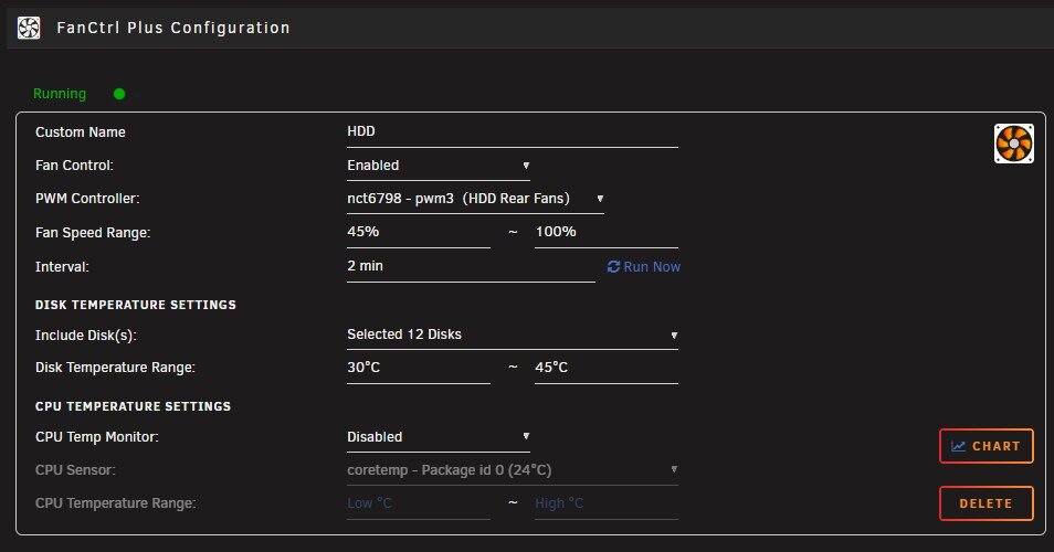

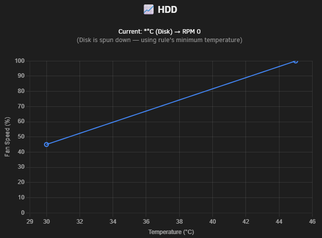

I've been testing this out today and it works great but with one small issue, minimum fan speed isn't kept when the array is spun down.
Ideally, at least for me, I want the fans to spin slowly even if the array is spun down, from the changelog etc it seems that they should keep the minimum fan speed range even when the drives are spun down. I've confirmed the fans can spin at the minimum speed range I've set (45%).
Is this a bug or could a keep fans spinning feature be added?

Yes, thatโ€™s actually how the current logic works โ€” when all selected disks are spun down and thereโ€™s no active temperature source, the fan will stop completely (or just fall back to your hardwareโ€™s own minimum speed).
I might consider adding an extra option in the future like โ€œAlways keep fans at minimum speedโ€ so that they wonโ€™t fully stop.
For now, if youโ€™d like to keep them spinning at least at your defined minimum, here are two possible workarounds:
1. Also include an NVMe or SSD in your selection (since those drives donโ€™t spin down), though of course the fan curve will then follow that device too.
2. Enable CPU temperature as an additional source. If this fan doesnโ€™t actually need to follow CPU temps, you can simply set the CPU minโ€“max range to something unrealistically high (e.g. 75 ยฐC โ€“ 80 ยฐC). That way, when all disks are spun down, the fan will still see CPU as a source and keep running at your minimum (e.g. 45%).
