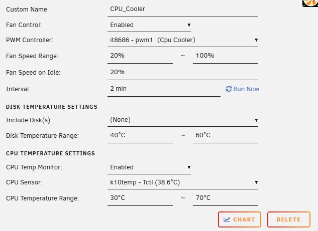

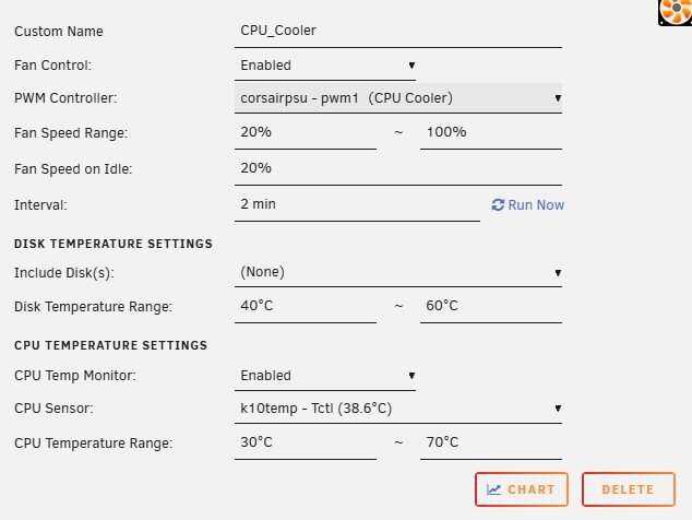

On 11/6/2025 at 2:22 AM, Random Mike said:
I have a strange issue on one of them on reboot it will change to a diffrent pwm controller.
CPU is set and labled to it8686 - pwm1 on reboot it will move to corsairpsu - pwm1 including the label.
The fan also are not auto controlled untill the run buttons are presses.
Any ideas how to fix this?

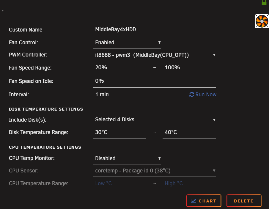

@CkChong Im not sure I understand the settings, but I have a side fan that should never run below 40% yet the its running at 29% why is that? There are no tempertaure sensors for this fan so shouldnt it just ran at a static percent?

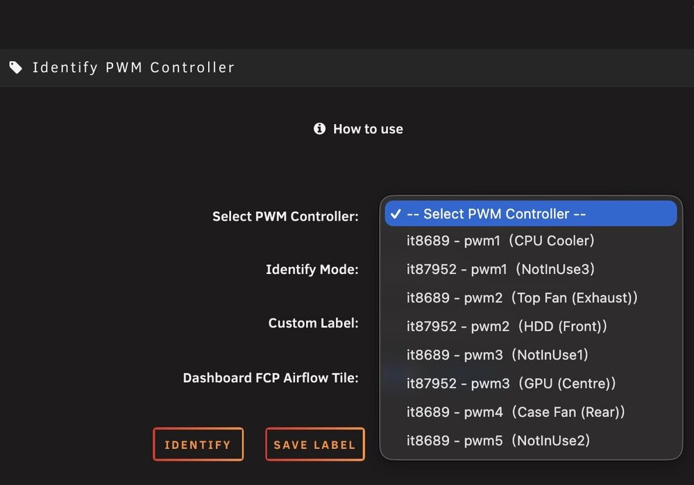

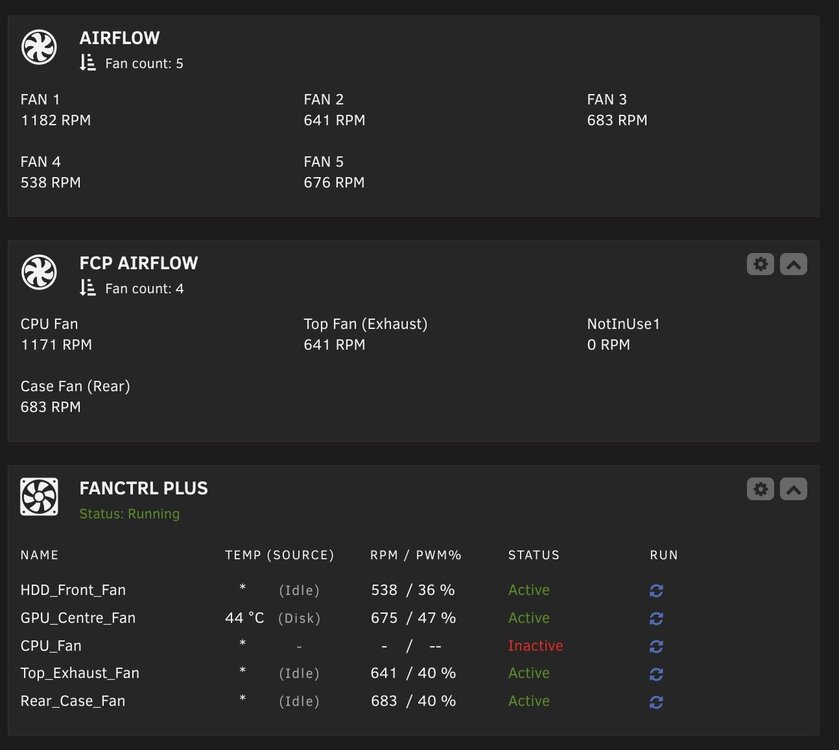

Hi, and thanks for creating this plugin - I've just installed it and mostly have it working as required except for the following issue with the airflow tile.
The screenshot below shows all the pwm fans on my server. I have 5 fans connected (including the CPU cooler) across it86 & it87.
Unfortunately, the FCP airflow tile is only showing some of the fans, including one that is not in use. I can't see any way to configure this, so assume there is some sort of UI issue with plugin. This is shown in the second screenshot.
Is this a bug, or am I doing something wrong?
Thanks.
Nick

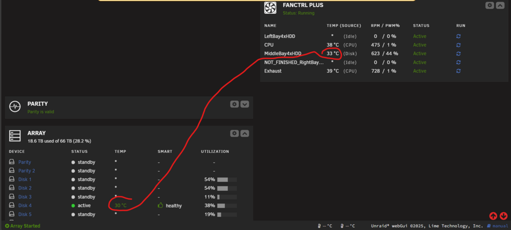

Somehow FanCtrlPlus reads (or calculate wrong) disk temperature. I have a fan job monitoring 4 disks, only one active at the moment and reporting 33ยฐC but FC+ shows 33ยฐC and PWM values are high. No change after clicking the run/refresh button on the Dashboard page.image.pngimage.png

I'm having these same issues with a gigabyte Z790 AORUS ELITE AX with smartfan6. It was working and then defaulted to all full speed one day while I wasn't home. It now detects the pwm controllers but I cannot control or identify the fans. The code above gave me the output attached.
I have it set up for PWM1,2,4 and 7. On reboot rather than grab nct6798 - pwm1, it grabs corsairpsu - pwm1 instead. If I change it and apply, it sticks until the next reboot. Am I doing something daft?
