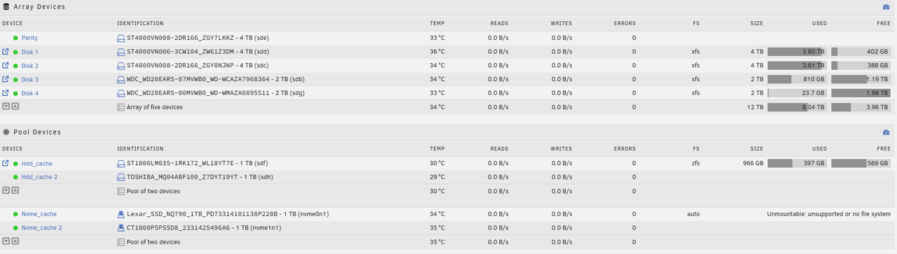

I have a problem with starting the ZFS pool in mirror (where there are config, docker, vm, and some folders that haven't been backed up).
This is my system (now):
I successfully updated from version 6.12 to 7.1.4 last Thursday.
The pools all seemed fine after the update reboot. Subsequently, the parity check started and the web page was no longer reachable. I was also unable to access via ssh.
I powered off and restarted the server, and perhaps this was the problem.

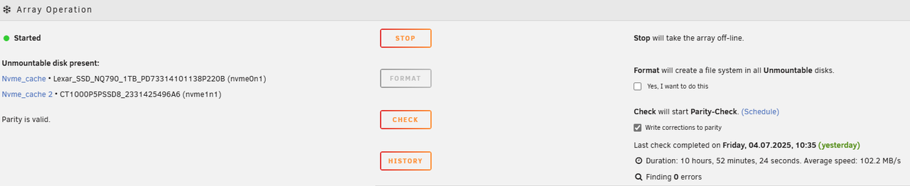

The "WRONG CONFIGURATION" message appeared and the array did not start.

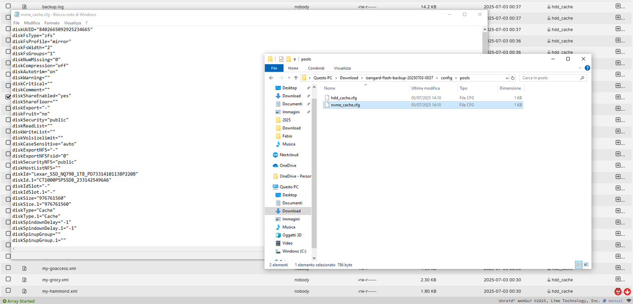

I did some research on the forum and found the following solution: - remove the pool - recreate it with the same name - reassign the devices - leave the file system set to auto - start the array.
I did this, now the system starts, but the config folders are moved to the HDD_CACHE pool, which doesn't have issues. Instead, the nvme_cache pool, where there are data and the cfg with docker and vm, gives an error of unmountable: unsupported or no file system.

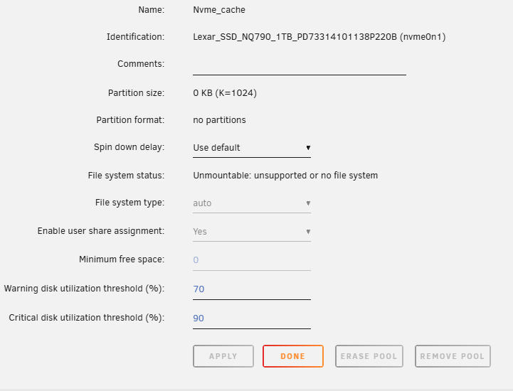

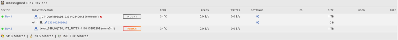

Maybe the first disk (nvme0n1) now is corrupted. I've tried a switch drive (remove pool, assign the nvme1n1 on first and nvme0n1 on second) but notingh change.

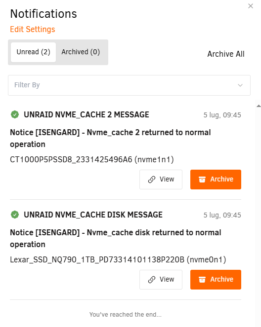

I also another alert in gui popups
If unmount the array and remove the assign, i see a only one label of nvme1n1

failed to unpack label 1
failed to unpack label 2
failed to unpack label 3
root@ISENGARD:~#
Edited by Spa
@JorgeB i'm trying a trick, and recover some information
I download the lastest flash backup, extract and see some files
I Can see a pool cgf .. how can import in somewhere o something ? Can it helps?
Thanks
Also @JorgeB i did a mistake
i didn't export pool before remove and recreate!!
What can i do now?
Restoring the pool cfg won't make any different, the command above shows that the zfs label is corrupt, you may still be able to recover some data with a file recovery app like UFS explorer.
I've tried but nothing .. i check my backup and luckly i did a big backups 2 months ago .. it's good
In the end, i created new pool and restored all docker and data
I never did a VM backup :( so i'll create my two virtual machine
Thanks for help!!
