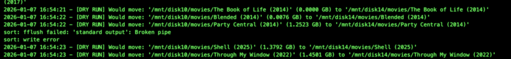

Also having issues with plugin after update to latest version. See attached txt file for dry run log. Possible you could make link available to previous version to rollback while issues being investigated? Very useful utility!

I'll take a look at it after work and also post a link to the previous version.
Im getting the same broken pipe errors as well, please let me know if i can do anything to help with the fix.
@unabletoconnect @poto2 Which version did you get the error? I posted a link to a dev version, is it that one?
i'm running 2025.12.31-3.
Happy to try the dev to see if that fixes the error, however is there a way i can abort the currently running instance? eg, like mover stop command

okay updated to 2026.01.05 (after uninstalling previous version) and still getting broken pipe errors
Thanks for reporting. I'll look at it after work. 😊
