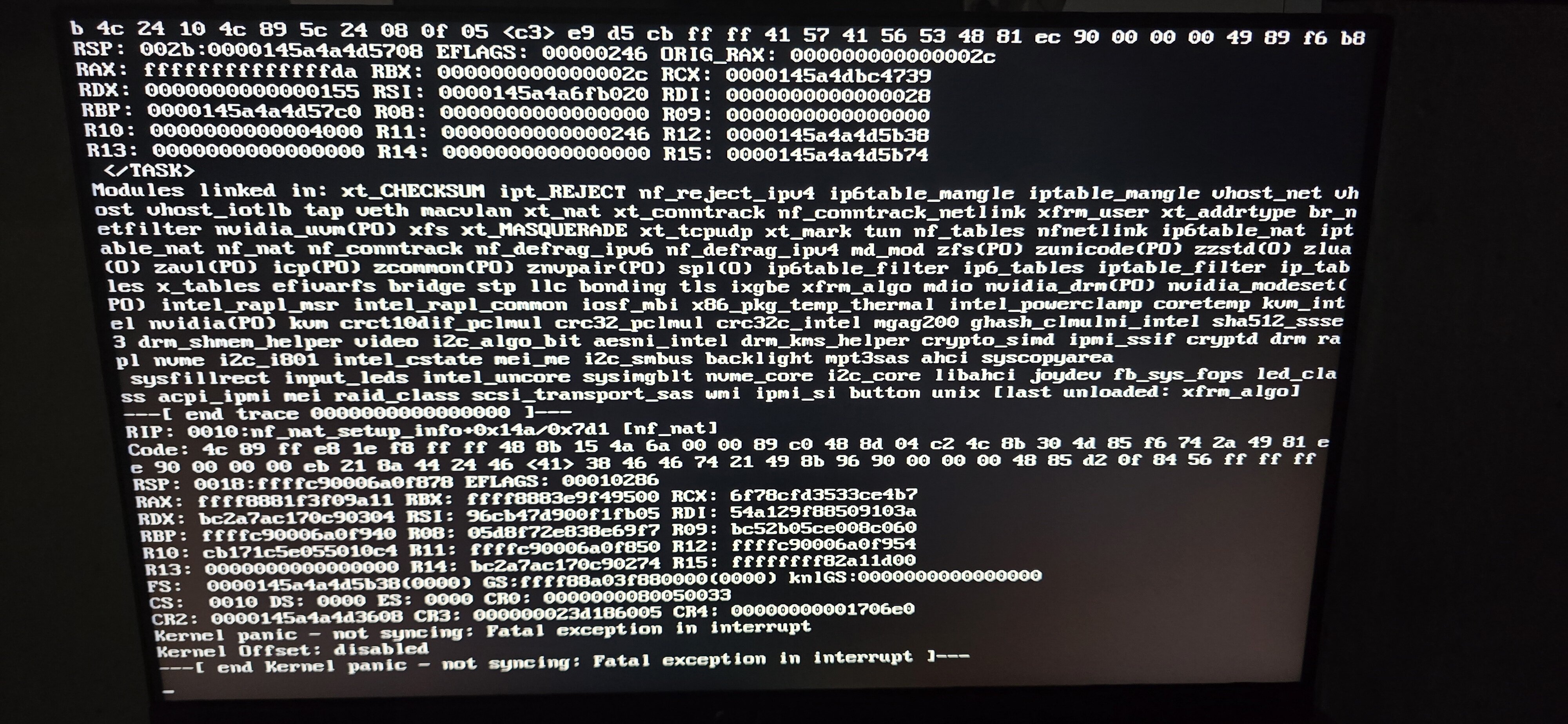

July 6, 2025Jul 6 My system has been quite stable until last night. I woke up and noticed the server couldn't be reached. It was still on but had a lot of text I didn't quite understand. I shut it down and rebooted and everything came online just fine. I left to go to the store and about 2 hours later, it was offline again. I got home on took a picture of what was on the screen.I have also attached the syslog file. I am not really able to fully decipher the syslog, so hoping someone here can point me in the right direction.Thanks!syslog-192.168.1.10.log Edited July 6, 2025Jul 6 by HappyWaffle
July 7, 2025Jul 7 Author It seems to have something to do with Tdarr. The most recent thing Ive changed on my server was setting up Tdarr. The first crash happenes during the night when I had set a large show to transcode. Then after I had power it back up, I started another show and about 2hr later is when it crashed showing the text in my picture.After booting back up, I just stopped Tdarr and its been fine since. Not sure what is causing it to crash during or after transcodes. Looking at the files, it seems like it finished all transcodes properly, and then crashed after.
