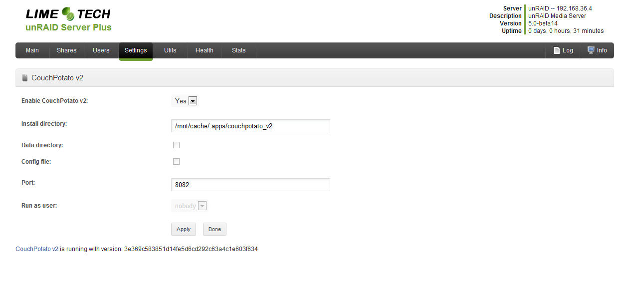

Based on the CouchPotato V1 plugin i created a plugin to handle version 2 of CouchPotato.
Here are few notes:
- this plugin create a separate catalog of CouchPotato (couchpotato_v2)
- the default installation path is /mnt/cache/.apps/, so if you need to change it please edit the plugin to suit your needs
- for now, it is recommended that the installation path and the data and also configuration file should be in the same directory
- it is possible to update the CouchPotato V2 via unRAID web or by CouchPotato V2 own site
- this plugin installs Python in 2.6.6 version
- you will find the plugin and some screens in the attachment of this message :)
- this is a first release so if you find any bug please let me know

It seems to start couchpotato fine, and reports as running, but it's "unable to connect"  it also hangs while starting.  no error message is given :(
This is because the port is being written to the config instead of settings.conf
where do I fix this?  which line of the plg?
Also, it seems that the port numbers default to different ones from BenniChann's ports.
I dont' know if there is a "standard" but it would be convenient if SABnzbdb used the same port in all the plugins.  sure one can change it, but the default being the same would be helpful ;)
The port defaults to a different port because of the plug-in writing to config.ini instead of settings.conf as well, for V2 ruudburger took out the option to declare the port from the command line, it must be declared in the settings.conf, otherwise it defaults to 5050. I've modified the plug-in to do this. But it still brings back the problem with the data_dir defaulting to the install, which if your following the SabnzbdBeta-plugin thread, I had to change because if the data directory path is ".Apps" instead of ".apps" it will overwrite your settings. This may be specific to me only, other users may use something different entirely and it would only affect you if you previously had the plug-ins installed with the data directory /mnt/cache/.Apps/.
Basically, couchpotato V2 sets the data directory and port in its settings.conf(different from the plug-ins config.ini). Its easy enough to declare the data directory, but referencing the config directory by the data directory makes it tricky. Say you set your data directory to /mnt/data, your config directory would be /mnt/data/settings.conf. If after that you change your data directory, couchpotato will look in the new data directory for the config file, and it wouldn't exist, basically wiping your settings from couchpotato.
Thats the only issue I had which was why I hadn't released the couchpotato_v2 plugin. Now looking at WW's I believe there is a simple answer, I just hadn't had time to mess with it to figure it out. I'm going to test it and see if it works though, if so, I'll release an update. Of course, WW could release an update in the mean time that fixes the port issue. WW if you don't know what it is causing it PM me and I'll send you the code change to fix it, :)
EDIT: Sorry, was a little perturbed that I had to set everything up again. I have multiple categories set up and it takes a little while to set everything back up(I'm very particular about how the media is stored and the nomenclature).
The lines that need to be edited are 413-425. Any reference to config.ini needs to be settings.conf and any reference to config.old needs to be settings.old.
These changes allowed me to install and set up couch potato.

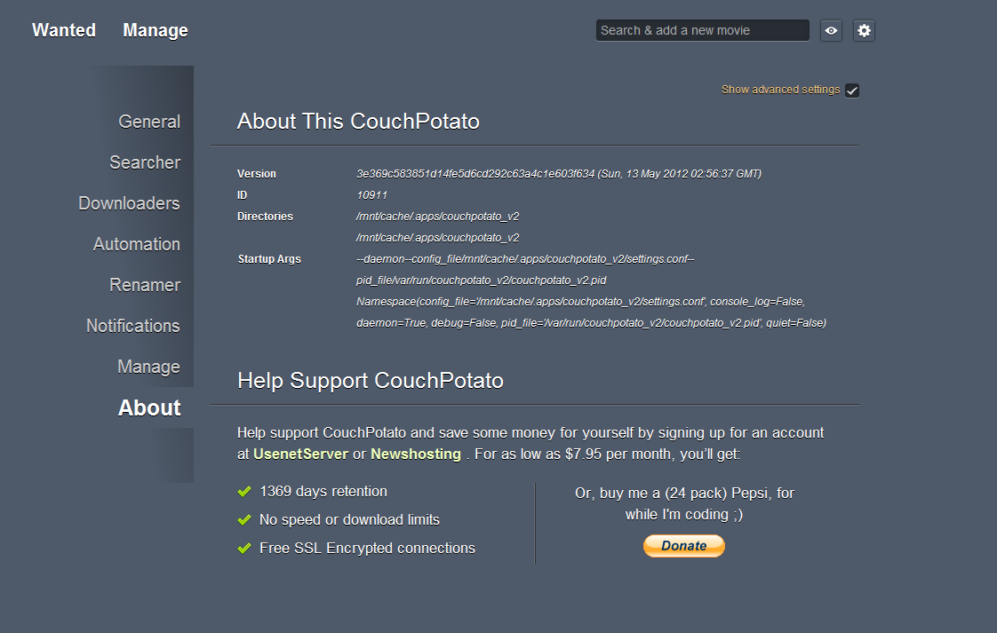

CouchPotato v2 is running with version:
Update available to version: 3e369c583851d14fe5d6cd292c63a4c1e603f634
Right. For changing port or data dir directory you should change the line 79 and 87 in settings.conf file.
This is because the plugin creates the default setting.conf directory with port 8082 and default dir /mnt/cache/.apps/couchpotato_v2
I will do some modifications to automatically change this values when user change its in unraid web gui.

Also, I see this even after Installing...
This is because plugin is using "version" file in DATADIR/cache directory.  Do you have data dir same as install dir?
If so, please disable CouchPotato and reenable it for rebuild version file.

The plugin is telling me there is an upgrade available, but is not showing the current version.  When I click Install, it seems to install okay, but still tells me there is an upgrade.  It seems it's not reading the current version correctly.
Otherwise, works great, thanks
It tells me this in settings...
Update available to version: 0ba2e579f9658dfbf7ab65245bee9a04d1c09473
I have "upgraded" several times, and this message does not change.  It must not be reading my current version correctly, but I don't know why.
It shows that CouchPotato is running, but it's not really.  i cannot connect to it.
Any suggestions on how to fix?
**Edit - I looked at the plugin and line 346 reads
$couch_port = "8082"
but I have it set to use port: 8083
why isn't this being update properly based on my settings?
I looked at the settings.conf file and line 87 shows...
port = 8082

Its because its not being updated in the settings.conf file like it should. $couch_port reads from the settings.conf, as well as couchpotato itself. The config file is there for the install_dir variable as well as runas. The Couchpotato V2 uses the settings.conf to set the data directory and port, whereas before you could set those by the command line.
Were you using my updated plug-in? Some of these issues were fixed in that release. I kept the variables in the config file for ease of access, but they are updated in the settings.conf whenever changed.
EDIT:As for the update bug, I'm going to be looking into it in the next few days, hopefully I can figure something out with it. Just haven't had a chance the past few days, remodel and alot of changes going on at work, plus I'm having to pick up and run another department right now, so I'm pretty busy lately!
