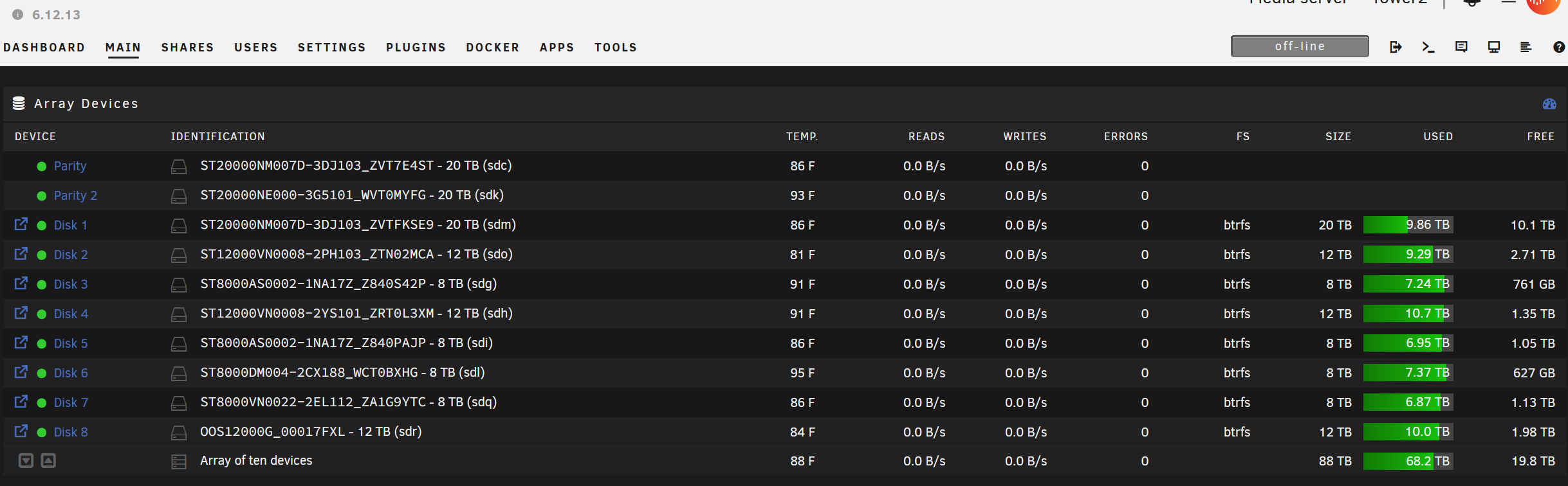

Long version - Been running 6.12.13 for a while, stable. Recently upgraded two drives. One parity 12tb to 20tb and one data disk 8tb to 20tb without issue. Been running fine.
Under 6.12.13 you can see disk1 is 20tb.

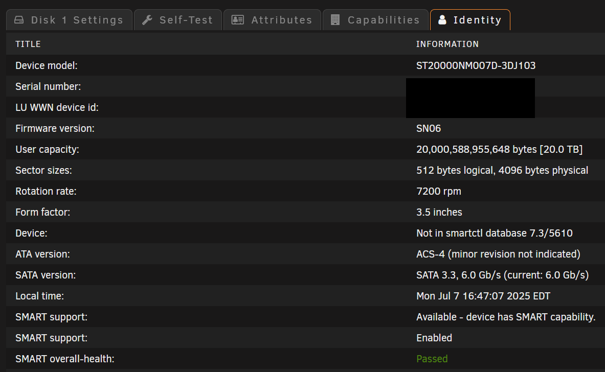

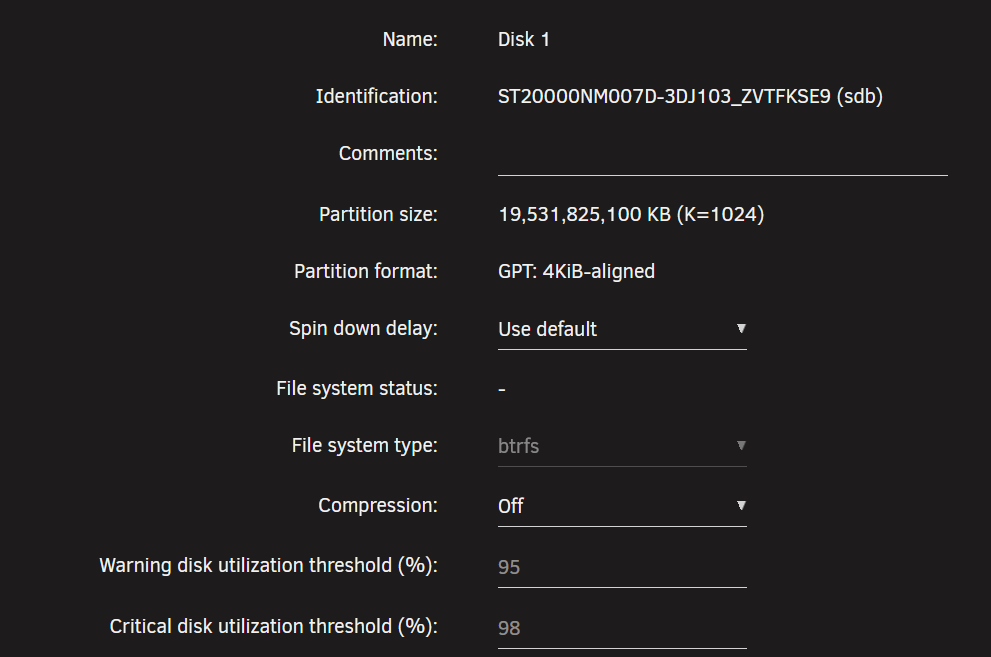

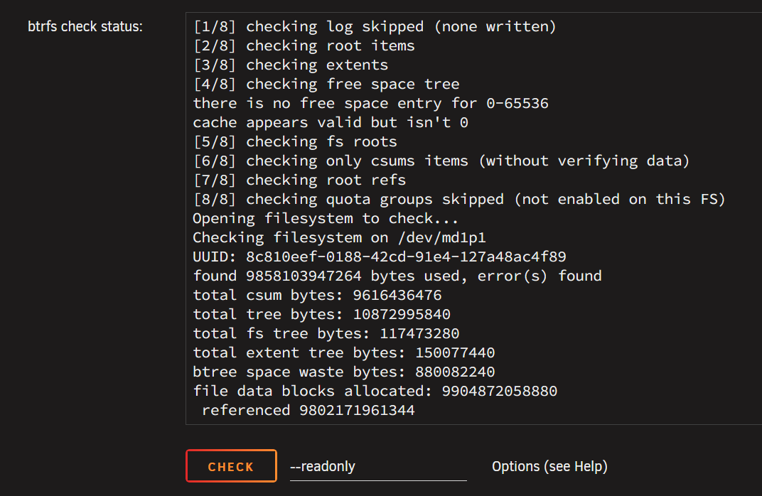

Disk1 checks out fine:

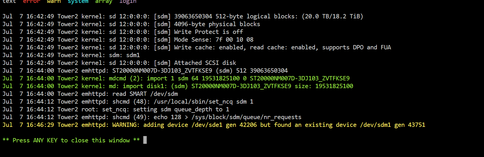

Before anything else happened I reverted back to my 6.x version and it showed as 20tb correctly when I did. This is however interesting in the disk log after reverting to 6.x:
/dev/sde is still in the system, sitting idle, but listed under Unassigned Devices.
So I assume there is something wrong here and it's reverting to that disk? IDK. Any help will be greatly appreciated.

Jul 7 15:50:41 Tower2 emhttpd: shcmd (483): btrfs filesystem resize 1:max /mnt/disk1
Jul 7 15:50:41 Tower2 root: Resize device id 1 (/dev/sdk1) from 7.28TiB to max
I assume sdk was old disk1 at this time? Having both connect may be confusing btrfs, try disconnecting or wiping it.
