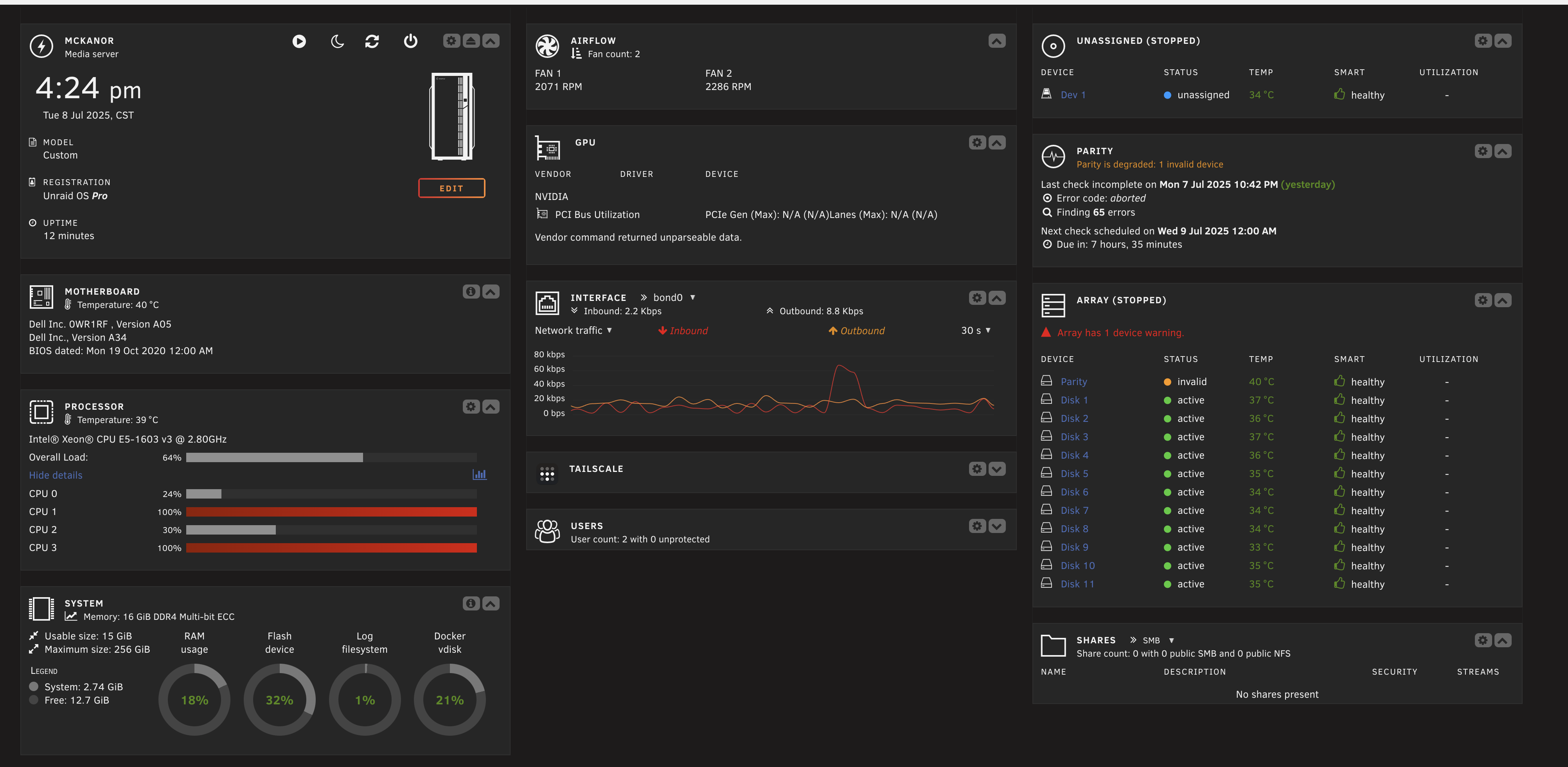

UNRAID 7.1.4 - takes forever to start the array
Hi. Need help from the experts please, i don't know if i lost data or not. array not starting. I am at a loss, just recently powered my decade old unraid server.

Not really an expert, but your logs have a lot of errors for:
Disk sdm (WDC_WD20EARS-00MVWB0_WD-WMAZA47938) throwing a lot of errors usually related to power/spinup issues or a controller/cable problem.
a ZFS disk/pool with many errors not mounting, this is likely the main culprit here, appdata,system and domains are looking for "cache" but your only cache disk is showing as a new device.
Nvidia driver needs to be changed to legacy mode as your GPU isn't supported in the new drivers.
One of your "disks" is a hardware raid array of some flavour, which isn't an error but i wouldn't recommend it.
I'm sure someone will help troubleshoot this for you.

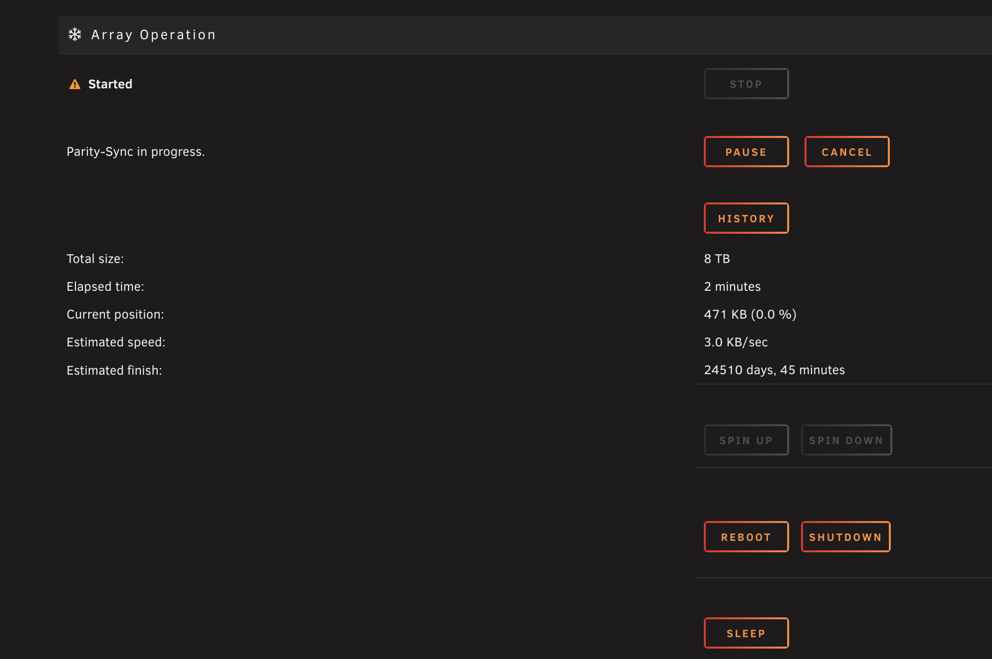

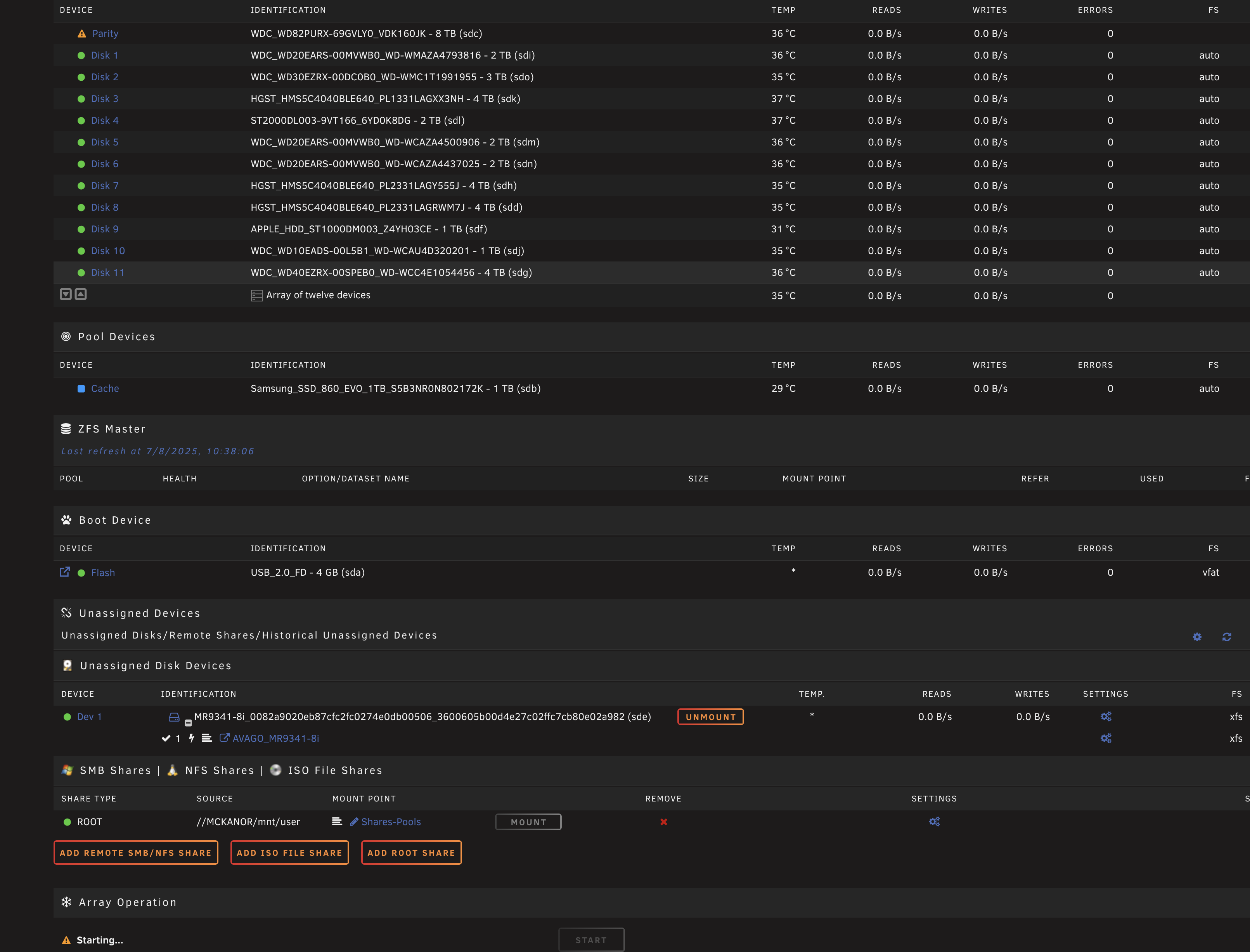

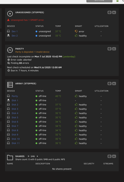

Hi. I had made some HW adjustments, is it still necessary to disable the "soon" to be problematic drive(s)? Only the parity is saying invalid, and it said earlier, if the array started a parity-sync will start. However, it is still trying to start the array.
Something weird, when in the MAIN tab, i pressed the START button to start the array and begin parity-sync, nothing seems to be happening. However, when going to the DASHBOARD tab, the start array "play" button is still enabled and i am able to click that too. But just the same, nothing happening, the array does not start. Here's the latest logs. Thanks for your concern.

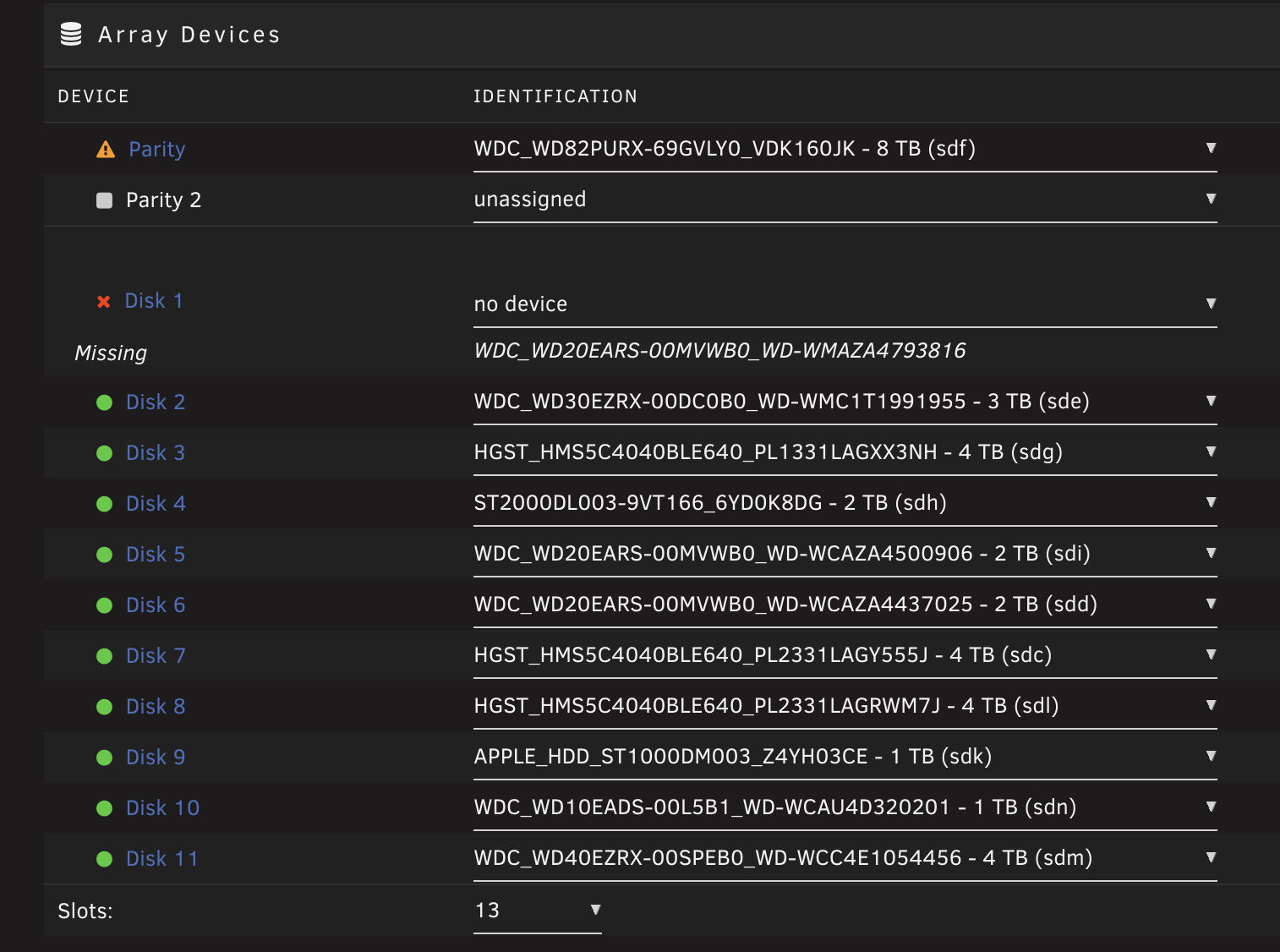

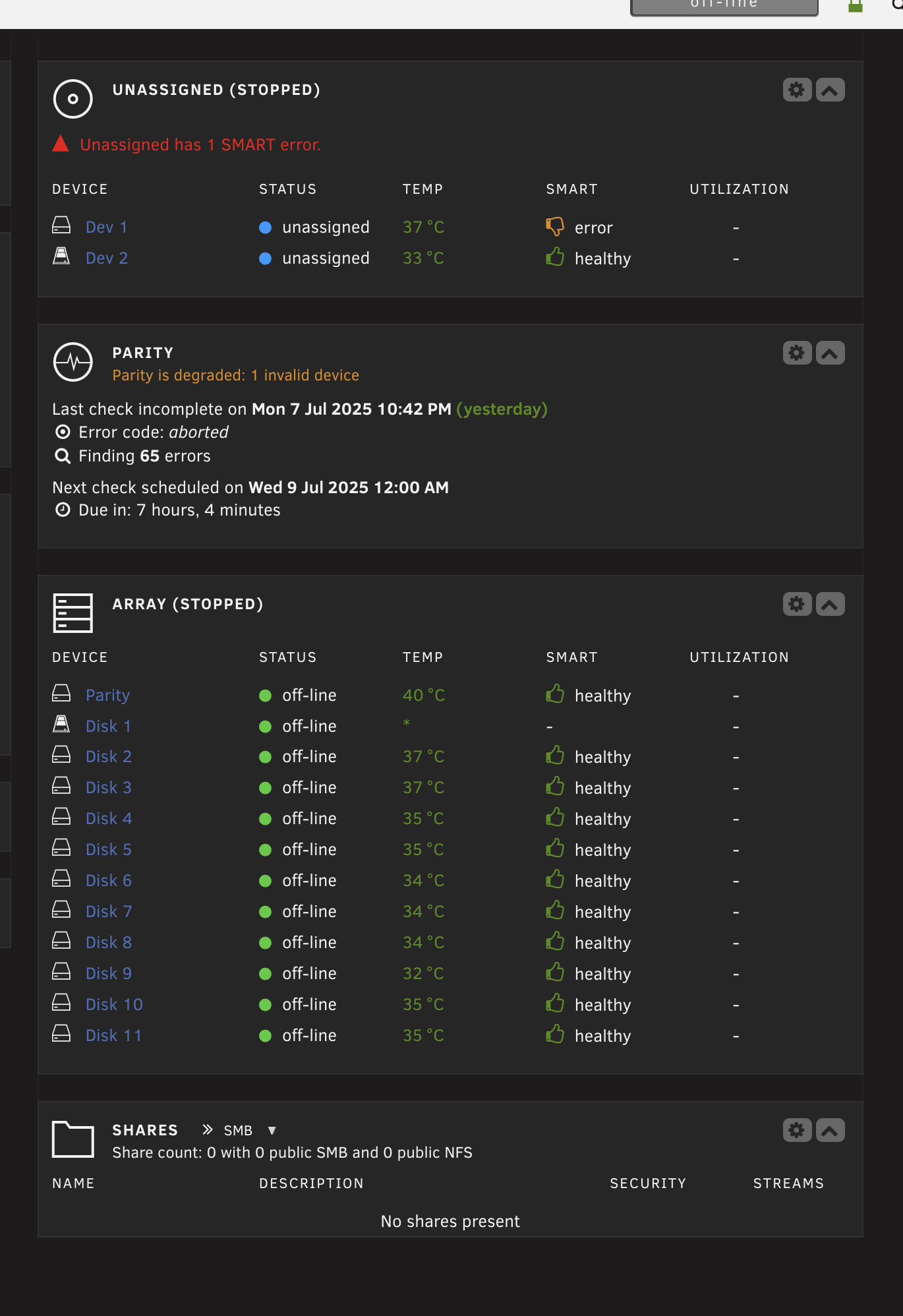

Hi. It says "too many errors or disk missing" something like that. I don't know what to do, appreciate your help, i don't mind to rebuild that apps installed, i just want to recover my data, it's 15 years ++ of personal media.
According to that screenshot, parity is not valid.

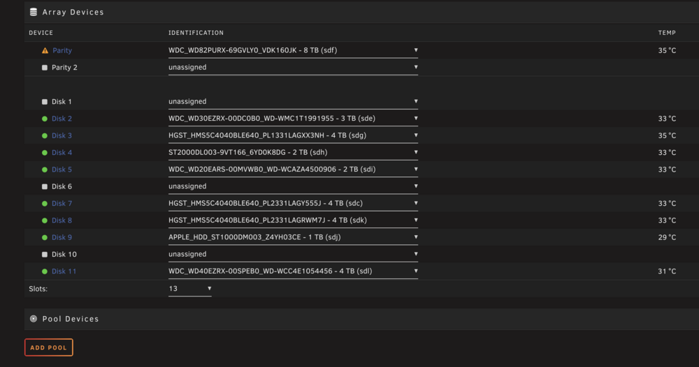

i checked did that already but with disk 1, and choices are array, pools, right (i choose all) keep same assignments. but it did not work for me. how do i exclude disk 1?
33 minutes ago, JorgeB said:
You can do a new config without disk1 (Tools - New config - Keep all assignments - Apply).
Then start the array to begin the parity sync, if any disk fails to mount or there are more read errors, post new diags.
Thanks, i am on it, will post diags once done. Appreciate it a lot bro.

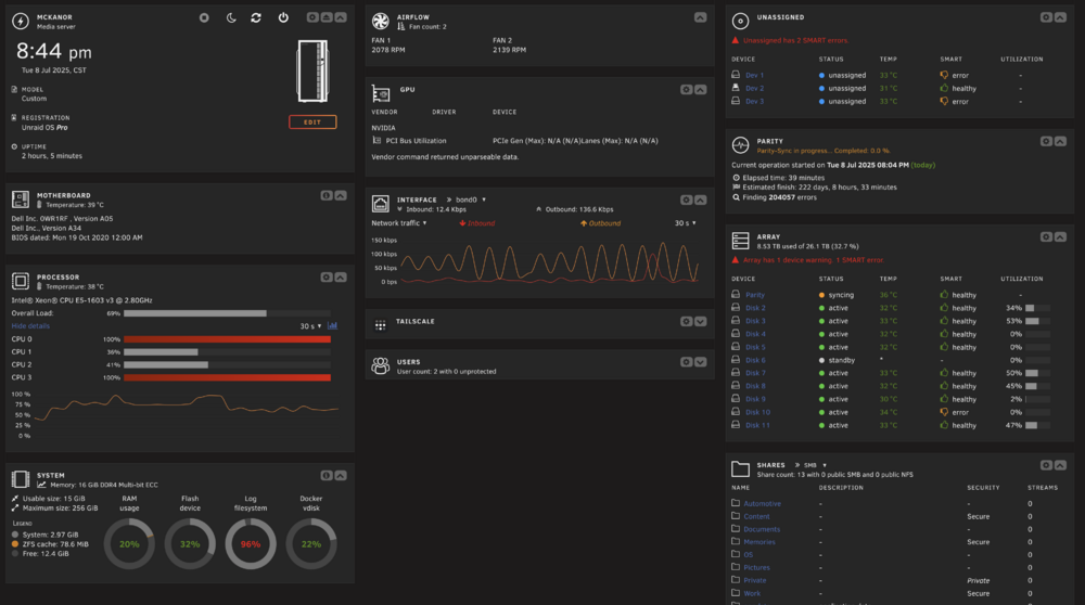

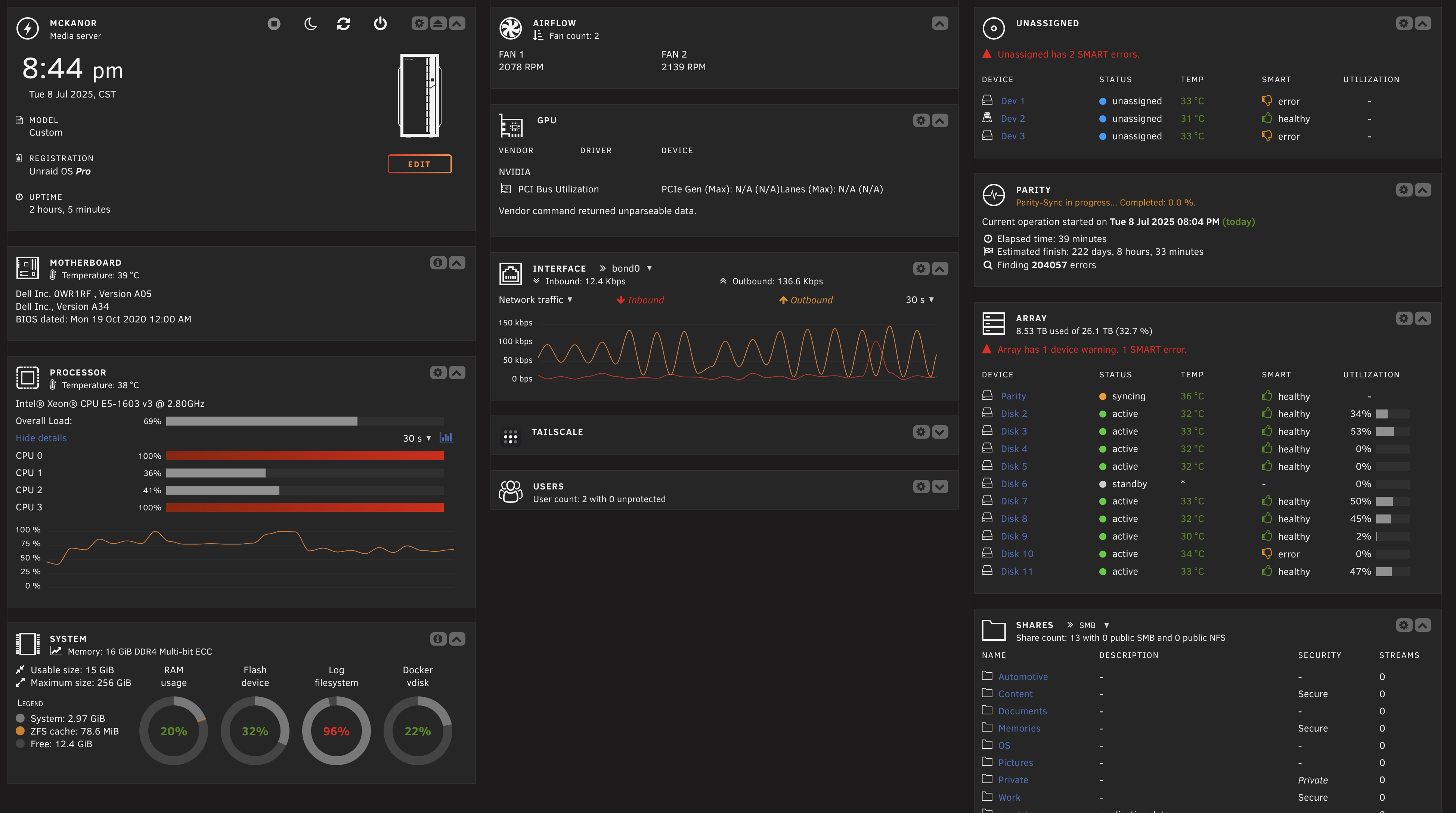

Hey bro. I got the array back up and running, thanks to all who contributed to the solution. Although i hope the parity-sync will not take years to complete

The Parity-Sync has started, it is still reporting read errors on several disks, i will plan to replace those eventually.
I still have a few questions, is there a way to avoid re-installing all apps like Plex and Jellyfin etc. Those that have VMs and Dockers? And can i restore my Cache? I dont know how to recover that, there are appdata folder there, do i also need to finish the Parity-Sync before dealing with restoring or re-installing from scratch the apps? Thanks again brother, the rest of the Unraid support team for helping me.
Please post new diags.

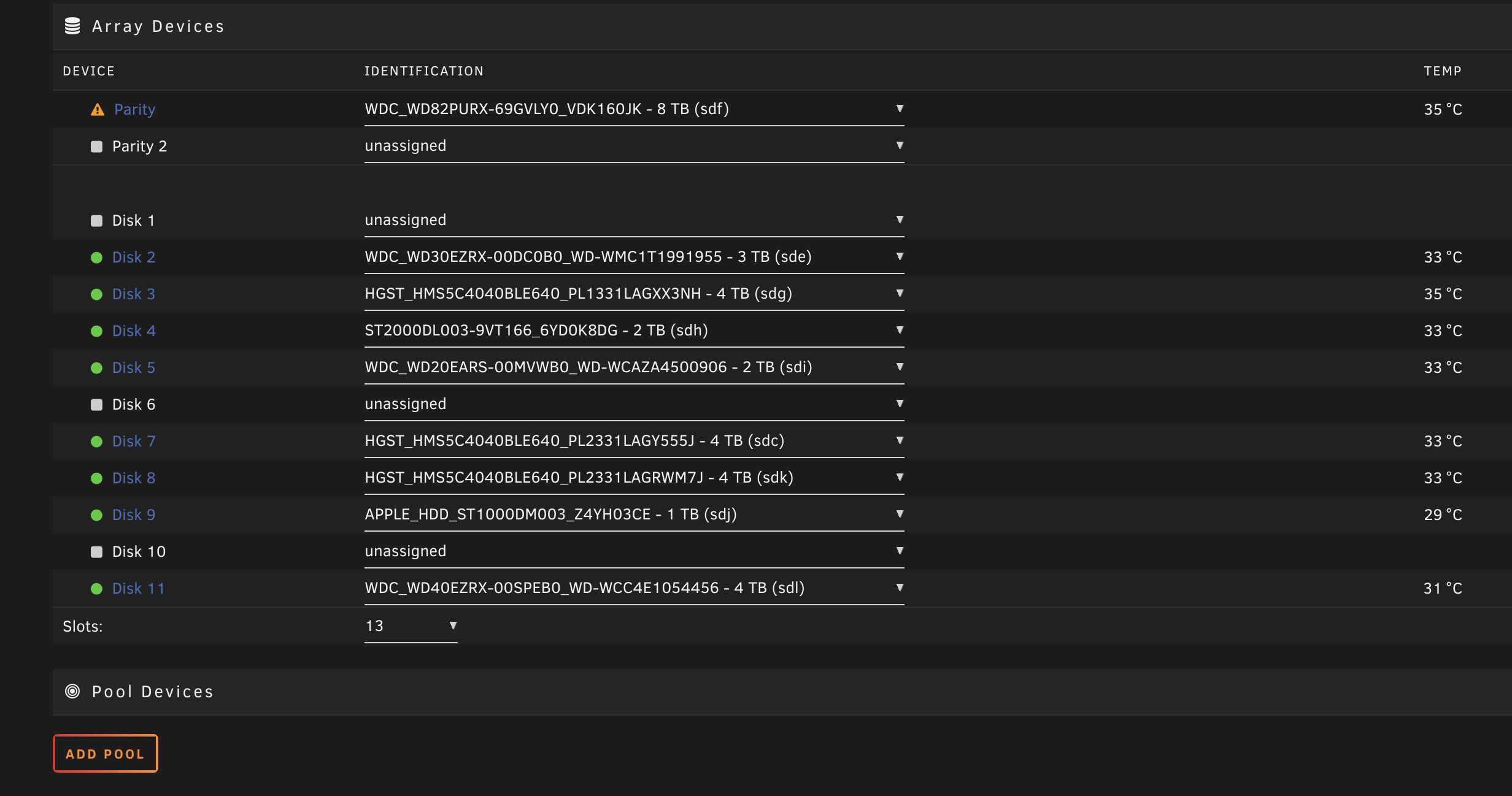

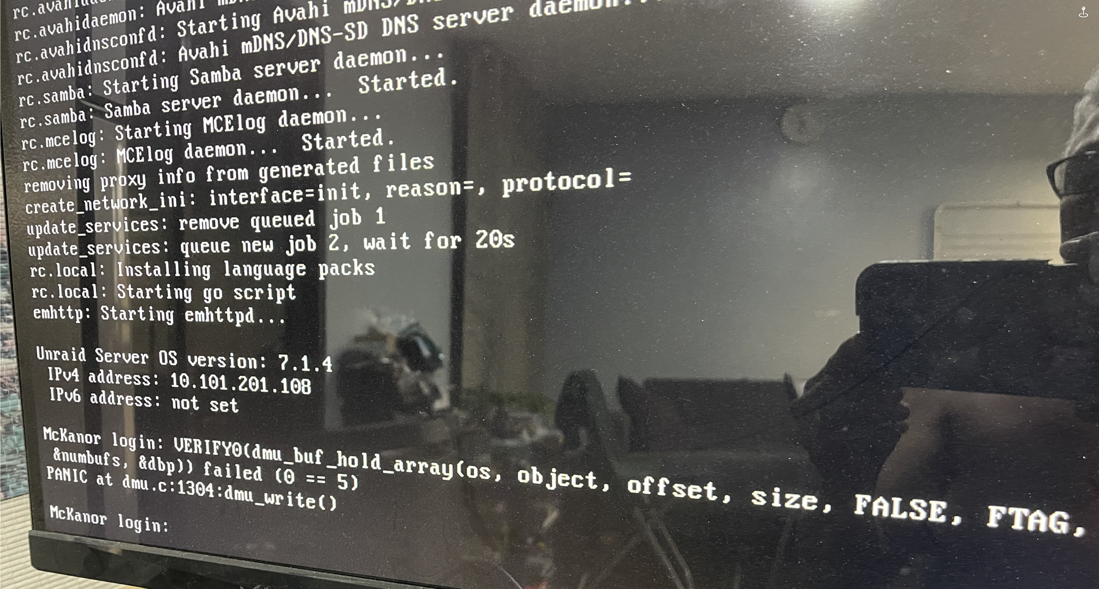

I guess the celebration was premature, as you can see from this ss the disks mounted and the parity-sync was well on its way. Unfortunately, 2 more disks (5&10) were reporting read errors and that caused the server to hang, so needed to shutdown unclean.
The i did the same as before after rebooting, i set those disks to "no device", and did a new config. Then restarted the server. Since this morning, i noticed the ff:
  1. no single disk was mounted.
  2. no read or write activity on the disks, even as the server is saying "array starting"
  3. the server did not hang, i was able to move around and do other stuff
  4. i also noticed that if i go run terminal and issue the command "diagnostics", it did nothing and produced no logs or anything
  5. i also seen for the first time this error on the monitor (please see ss attached), saying something "panic". I obeserved that prior to this message, running "diagnostics" in the console will produce the diag file, however, if the error already occurred, it will hang if diagnostics is ran.
No idea what to do now, i have attached the logs that i was able to extract from the boot flash drive.

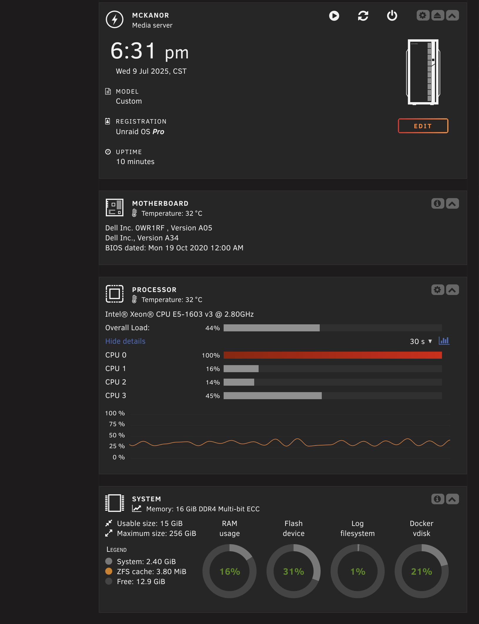

Just now i tried to recreate the event leading up to this error, and i was able to determine that if i don't start the array, this error will not trigger. In the main CPU monitor i can see also that 1 of the cores is getting maxed out. please see ss.
Did you save the diags after the read errors? I had asked for them previously.
The current problem looks like a possible filesystem issue, see if you can get the syslog:
cp /var/log/syslog /boot/syslog.txt
Also, it may be a good idea to run memtest to rule out any obvious RAM issues.
