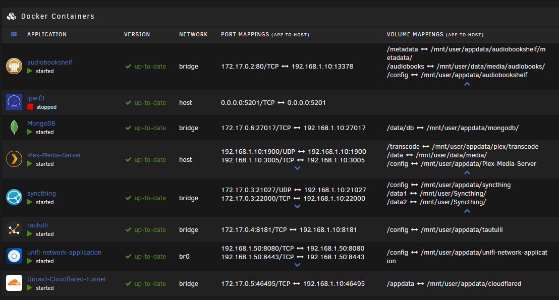

I only have 5 dockers installed. Plex, Tautulli, Syncthing, Audiobookshelf and Unraid Cloudflare Tunnel. I have looked at the template for each and none have any mappings to just /mnt. Is there any way to figure out where this file is coming from?

My bet is Syncthing , Data1, Data2 mapping is wrong , should be /mnt/user/appdata/syncthing
Data1 and Data2 are the directories I am passing through to syncthing... I don't want my directories to be in appdata, I want them to be on a dedicated share on the array.
Is this not correct? Maybe I am misunderstanding something about Syncthing.
Either way, these mappings are not on the root /mnt.
Edited by HappyWaffle
Those mappings should not ever create anything directly under /mnt. Just a thought - have you made sure that the Advanced toggle at the top right of the Docker page in case that shows anything extra?
