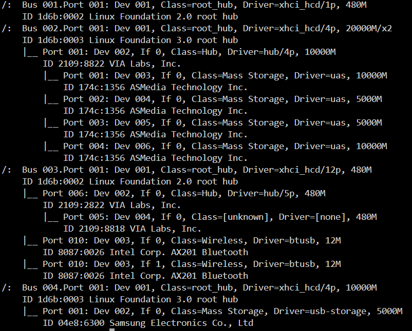

July 9, 20251 yr Community Expert There are constant USB issues logged, may not like the UASP driver, but note that USB is not recommended for array or pool devices. Post the output of lsusb -vt
July 9, 20251 yr Author This is the output of that. I thought it might have something to do with the hdd bay I got, it does support S.M.A.R.T. at least, the computer I'm using now doesn't exactly have SATA ports so that's why I thought I would get one...
