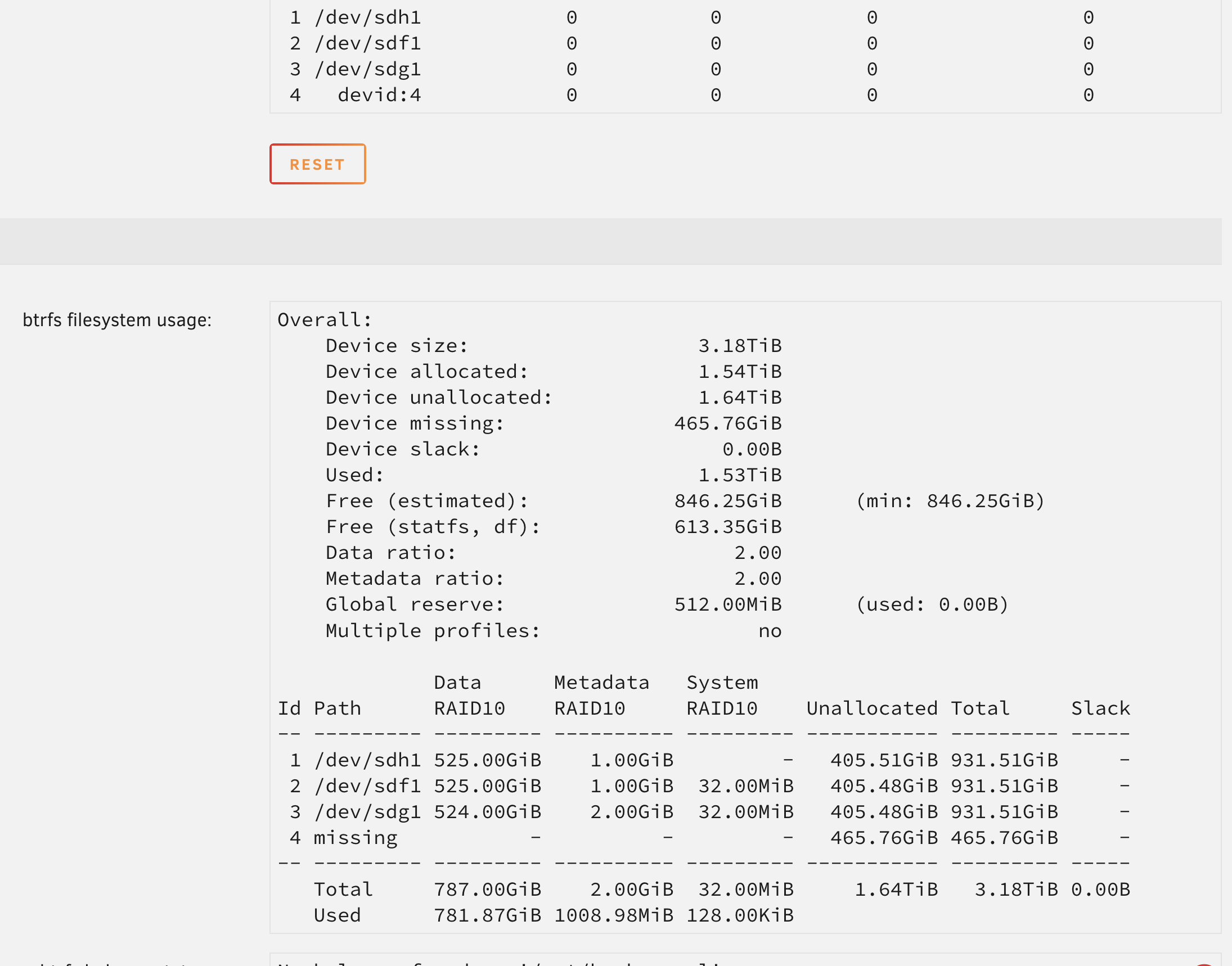

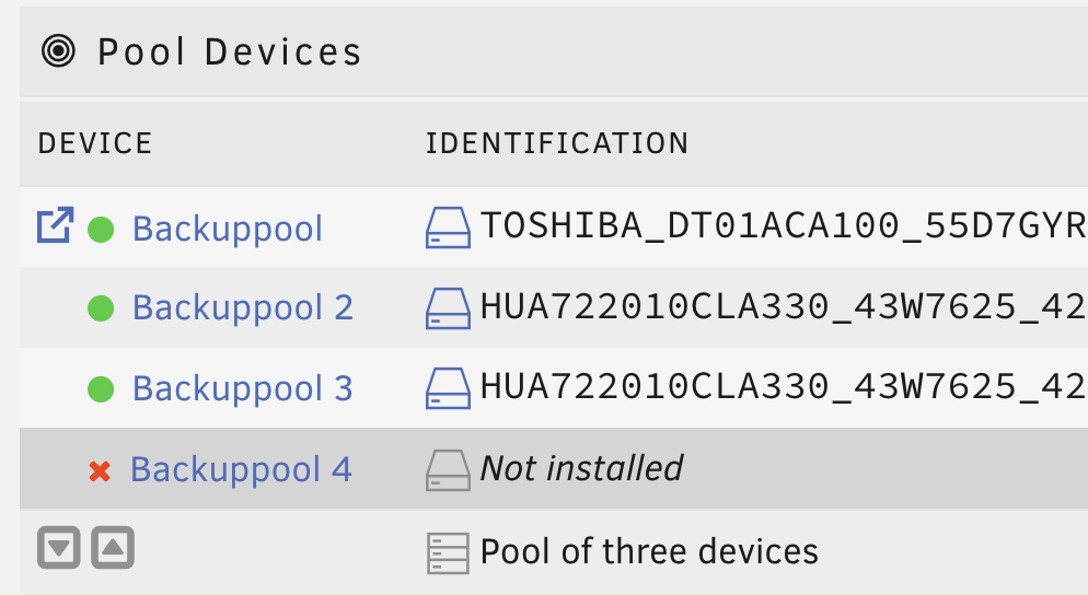

July 9, 2025Jul 9 I have a disk that went bad in a 4 disks RAID10 BTRFSPulled disk physicallyRan full rebalance, current stats:In Main tab it still shows disk4 missing:Removing the pool and readd as a 3-disk pool didn't help, it just pops up as a 4-disk pool by itself.Diagnostics attached just in case cozumel-diagnostics-20250709-0955.zipThanks!

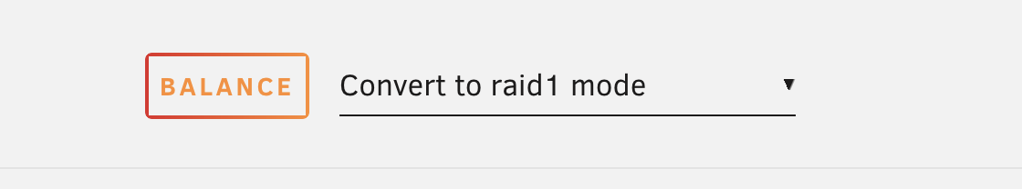

July 9, 2025Jul 9 Author 36 minutes ago, JorgeB said:Update to 7.1.4, convert the pool to RAID1, and you can then remove it, though possibly now it will need to be done manually.Thanks for helping!When you say done manually, do your mean the RAID10->RAID1 conversion needs to be done via CLI and cannot be done in GUI with the balance options?i.e.: Edited July 9, 2025Jul 9 by StylishQuoter
July 10, 2025Jul 10 Author @JorgeB I've upgraded to 7.1.4, converted to RAID1.But in GUI I still can not change the pool from size 4 to 3.(I'm potentially still running into the bug where emhttpd won't start after a reboot.)
