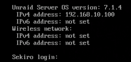

July 9, 20251 yr Hello,Since a couple of weeks, it happens that my Unraid server is unreachable through UI or SSH.The docker which are running are reachable (for example HA, Plex, ... ) - VMs aren't, since the whole server seems to be unreachable (dunno how dockers are..)I don't know why it's happening nor where to start searching.To be able to get access again I have to reboot the whole server.Sometimes I'm able to get access through ILO and I can login at least by console, then I've tried with:/etc/rc.d/rc.nginx restart/etc/rc.d/rc.nginx reloadBut it seems NGIX isn't running at all, and with START command, it fails:I saw that when i tried to do ls on /boot it was empty - like if the server was not able to get access to the Unraid USB anymore (always hated to rely on an USB Stick for OS - but that's me)But now it also happen that, when I try to access per ILO, as soon as I try to login with root (so I write root and press enter), I get:And then I have to reboot it "physically".I don't have a clue what's going on.any help to find out what's happening is really appreciated.Thanks.(in the attachement the diagnostic after rebooting the server & stopped the check of the array)sekiro-diagnostics-20250710-0150.zip Edited July 9, 20251 yr by TDA

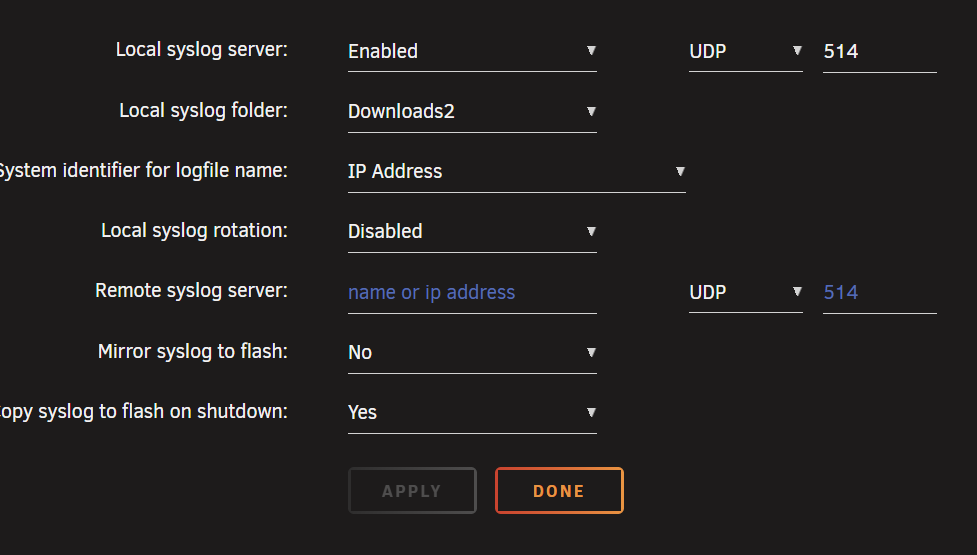

July 18, 20251 yr Author On 7/14/2025 at 9:05 AM, JorgeB said:Either option should work.Just enabled it - since it went down again after 4 days (god knows why)Set it up like this, let's see what's happen in 4-5 days:
July 18, 20251 yr Community Expert That is just ‘listening’ for syslog messages from elsewhere and will not capture anything. As mentioned in the syslog server link you either need to enable the “Mirror syslog to flash” option, or put your server’s IP address into the Remote Syslog server field.
