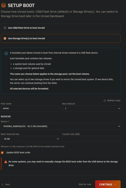

Has anyone tried to boot on the beelink memini emmc using 7.3 beta?
Yes Installed the beta but don't see my emmc drive as unassigned device, but it's here, i even could mouont partition 1... it's standard windows installed on it as it was from factory. I'll see if i changed boot device to USB stick, maybe that helps...

Does it show up in the Wizard as a boot pool option?
Oh yeah, it was there when i started the wizard. Thought i need to see it as unassigned drive:

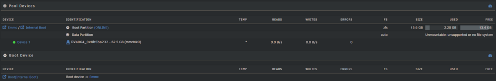

Migration done, closed wizard and rebooted, now i see it here, named it as "emmc":
Need to format the data partition with the remaining storage. 🤓
Very nice, they should mention it that emmc is not shown as unassigned but will be used in the wizard!
