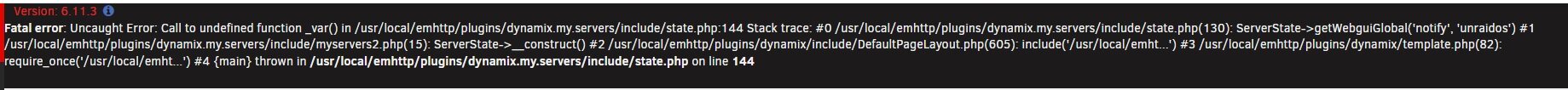

Just updated Unraid to version Version: 6.11.3 and now fatal error
Hey everyone. I just updated the Unraid on my server and I got this message after I log in headless and my actual server immediately afterwards.
Fatal error: Uncaught Error: Call to undefined function var() in /usr/local/emhttp/plugins/dynamix.my.servers/include/state.php:144 Stack trace: #0 /usr/local/emhttp/plugins/dynamix.my.servers/include/state.php(130): ServerState->getWebguiGlobal('notify', 'unraidos') #1 /usr/local/emhttp/plugins/dynamix.my.servers/include/myservers2.php(15): ServerState->_construct() #2 /usr/local/emhttp/plugins/dynamix/include/DefaultPageLayout.php(605): include('/usr/local/emht...') #3 /usr/local/emhttp/plugins/dynamix/template.php(82): require_once('/usr/local/emht...') #4 {main} thrown in /usr/local/emhttp/plugins/dynamix.my.servers/include/state.php on line 144
Has this happened to anyone else, and does anyone have a fix? If there is no fix, how can I downgrade my Unraid to the previous version without being able to use the browser inerface?
Try booting is safe mode.

Any previous release should be in the ‘previous’ folder on the flash drive. Restoring these files to the root of the flash drive will then revert to that release.
It is recommended that you always make a backup of your flash drive before attempting an update to make reverting very easy This backup can be easily done by clicking on the boot device on the Main tab and selecting the Backup option.

I did and it is functional again, but does doing that fix the problem?

I just went to the APP section and it said I needed to update, so I did.
Try uninstalling the Connect plugin; the error appears to be from there, possibly because you are using such an old Unraid release.
