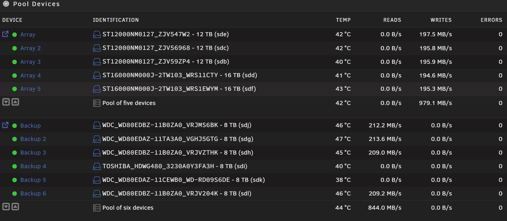

July 15, 20251 yr Author Community Expert Its there a way to fix or swap a Linux driver? Like Fetch the Intel ones to see It if makes any difference? Besines that the machine works flawless in unraid with zfs , array speed its the same as truenas :)
