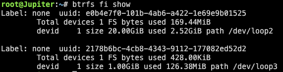

Post the output from btrfs fi show
Thanks for the reply. Attached is the output.

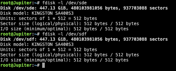

No btrfs filesystem is being detected; post the output from
fdisk -l /dev/sde
fdisk -l /dev/sdf
Here is the output for both disks. Since there is no filesystem detected, will it even be possible to recover the data from my VM and Dockers?

The partitions are missing, any idea what happended there?

Not sure what happened to the SSDs, but there's no previous filesystem signature detected on the two possible sectors Unraid uses. If the partitions were just wiped, this would bring them back, so I'm afraid that the only option to try and recover the data would be a deleted file recovery app, like UFS explorer, the free trial should show what it can recover.
