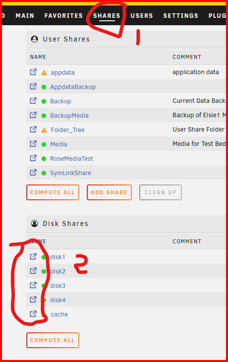

One way to check what is there is to use the built-in Dynamix File Explorer.
Open SHARES (Step 1) and then (step 2) click on the proper icon in the circled area for the disk where you want to look for files.

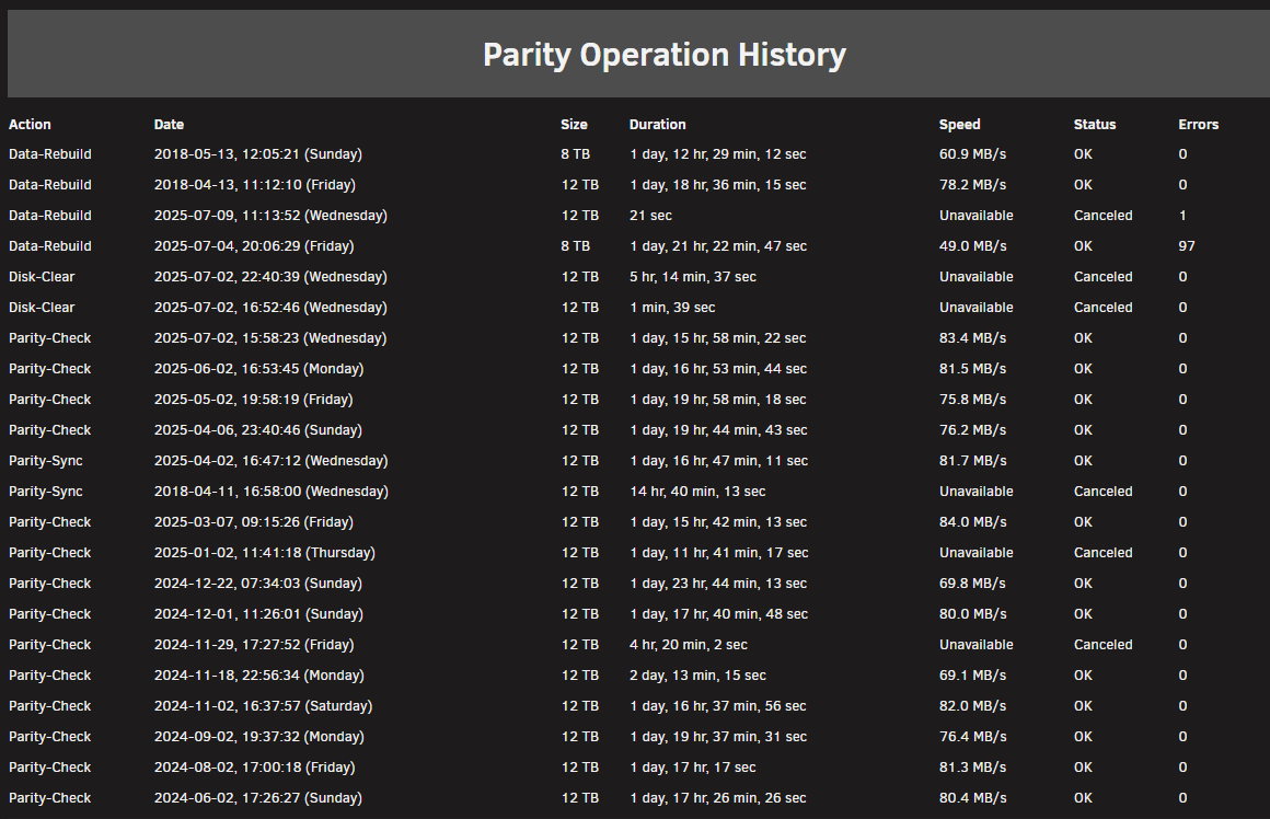

I have attached the diagnostics record, and a screenshot of two drives in the array, both of which are original drives, and are both 'lost' I guess.

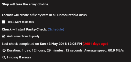

Upon firing the server back up it did a parity check, but I have attached an image of the message where it says it has not done once since 2018.
I do not want to hit "Yes, I want to do this" and format the drive unless I have to, nor do I want to execute a "Write corrections to parity" until I understand that that will do.
This history shows a good parity was done back in May, June, and July as I have it set to do a complete parity check every month.

The bottom says parity is valid, but still gives me the warning it hasn't been checked since 2018, and has the Write Corrections to Parity checked.
What should I do at this point?
I have a vague memory that the file format of the history file was changed many years ago and there was a problem with items of the old format being mixed in with the new format that would create a problem with symptoms like you are seeing. But I can't recall the fix...
I would check that the date and time on the server is correct. Somehow it seems you managed to get some history entries written with an old date.
