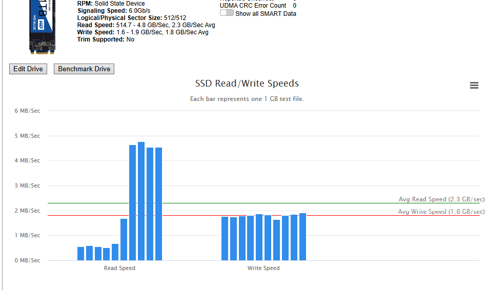

July 16, 2025Jul 16 Author which one the cache or the unassigned drive one.. they both the same 1 tb wd blue so i ran diskspeed app on the UD for the 500mb/s i getting nearly 5000mb/s test it says didnt know it could go that fastbut its not able to test the cache drive

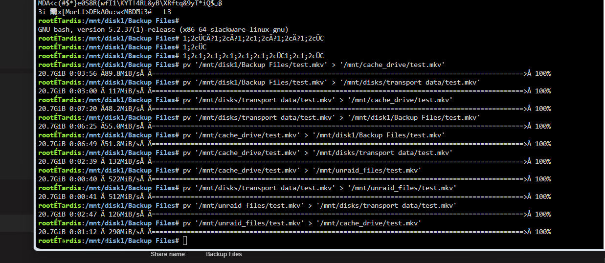

July 16, 2025Jul 16 Community Expert 1 hour ago, comet424 said:which one the cache or the unassigned drive one.. they both the same 1 tb wd blueThat wasn't clear to me, were you using disk path or shares pahst? Cache with a user path will always be slower due to FUSE, try thispv /mnt/disk1/path/to/large/file > /mnt/cache/file_namePost the results from that

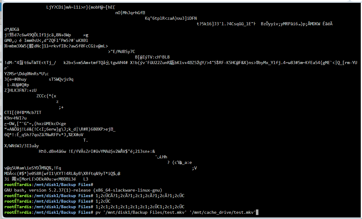

July 16, 2025Jul 16 Author for copying files in Krusader i used /mnt/user for the shares to array and to copy to cache and the UD drive i used/disks/disks for the UD drive/disks/cache_drive for the cache driveis that pv command supposed to show scrolling scrambled characters like hex of a file do i let it just scroll the entire file
July 16, 2025Jul 16 Author so i did the tests i added extra tests tooso transport_data = 1TB WD Blue Sata UD Drivecache_drive = 1TB WD Blue Sata Cache Drive unraid_files = 2TB Samsung 980 Pro M.2 x2 in mirror Modedisk1 = 14Tb Seagate Red Pro 7200 RPM

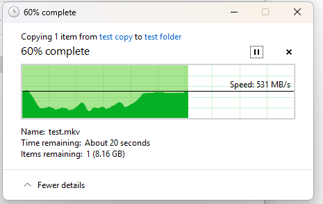

July 16, 2025Jul 16 Author so i did a copy of that test file over the network so from the UD share i have to my desktop pc.. my desktop has a Samsung 990 Pro M2. 2Tbi cant figure how to get a share of the Cache Drive to copy directly from itbut here is screen shot it stayed around that speedso read from the WD was over 500 and copying from the desktop to the UD stuck around 150

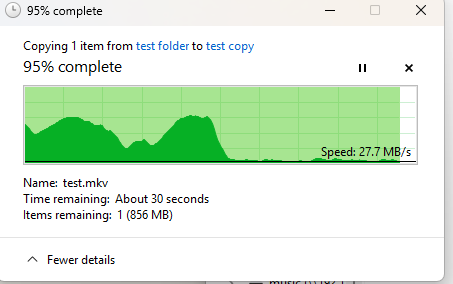

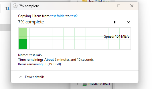

July 16, 2025Jul 16 Author so i now copy from Desktop to a Array Share that uses Cache Drive firstit was running at 300+ but then drops down to 12mbs or sotest copy folder is Array Folder With Cache First test folder is Folder on the Desktop with the 990 Samsung so copying from the Array Folder with CAche First it started off 500 then dropped down below 200 then droped to 0 for 5 seconds then started up and finishes copying at 500 in test 4 image
