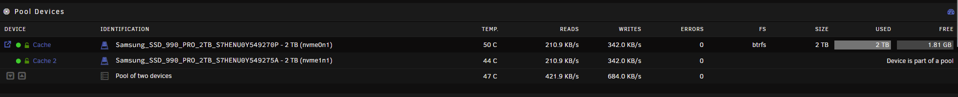

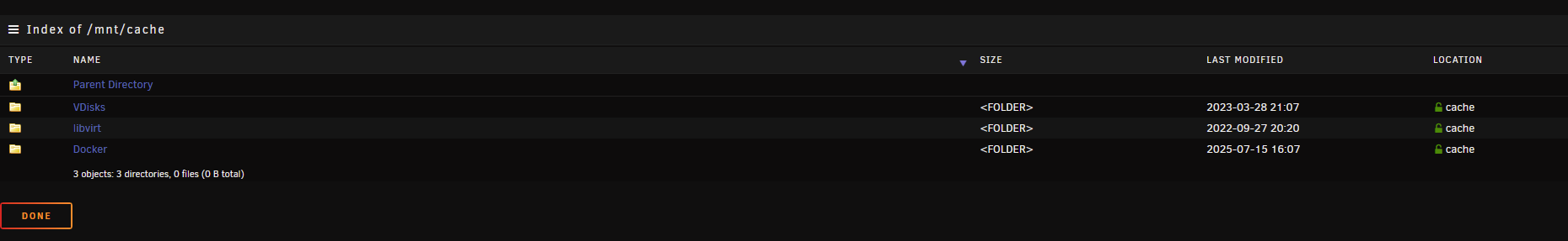

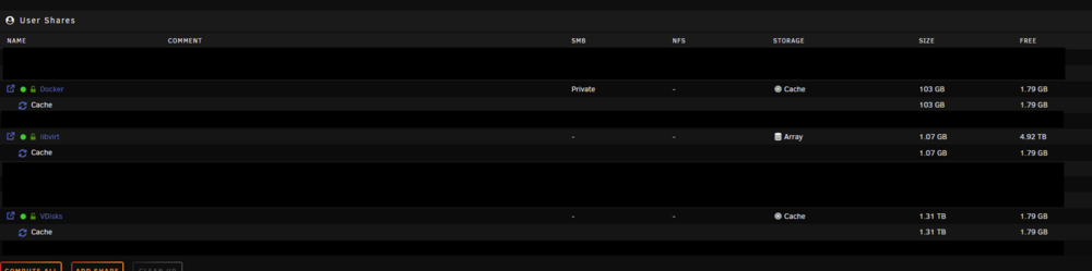

July 15, 2025Jul 15 Hi all, ive got a really strange cache issue where 400GB has vanished. So far I have restarted the array, restarted the server, turned off all dockers and VM's. Just cant figure out why its suddenly lost 400GB of usable storage. Server has been rock solid for years, 99% of the time its just been run mover and the space is sorted but this doesn't appear to be locked files stuck on the cache. Trim has been run from scheduler, that's given back about 1GB. Balance and scrub doesn't seem to impact this. Any unraid wizards have any clue whats ate the storage?Data, RAID1: total=1.82TiB, used=1.81TiB System, RAID1: total=32.00MiB, used=320.00KiB Metadata, RAID1: total=3.03GiB, used=1.50GiB GlobalReserve, single: total=512.00MiB, used=0.00B Cache only shows 3 folders on itChecking those shares, they add up to 1.4TB (ish)

July 15, 2025Jul 15 Author Sods law as soon as i post i found it. I had a 1000G Vdisk that was taking up 1.5TB.Not really sure why it wasnt releasing the space but i can just restore the disk from backup for now
July 15, 2025Jul 15 Community Expert This should help keeping the vdisk smaller:https://forums.unraid.net/topic/51703-vm-faq/#findComment-557606
