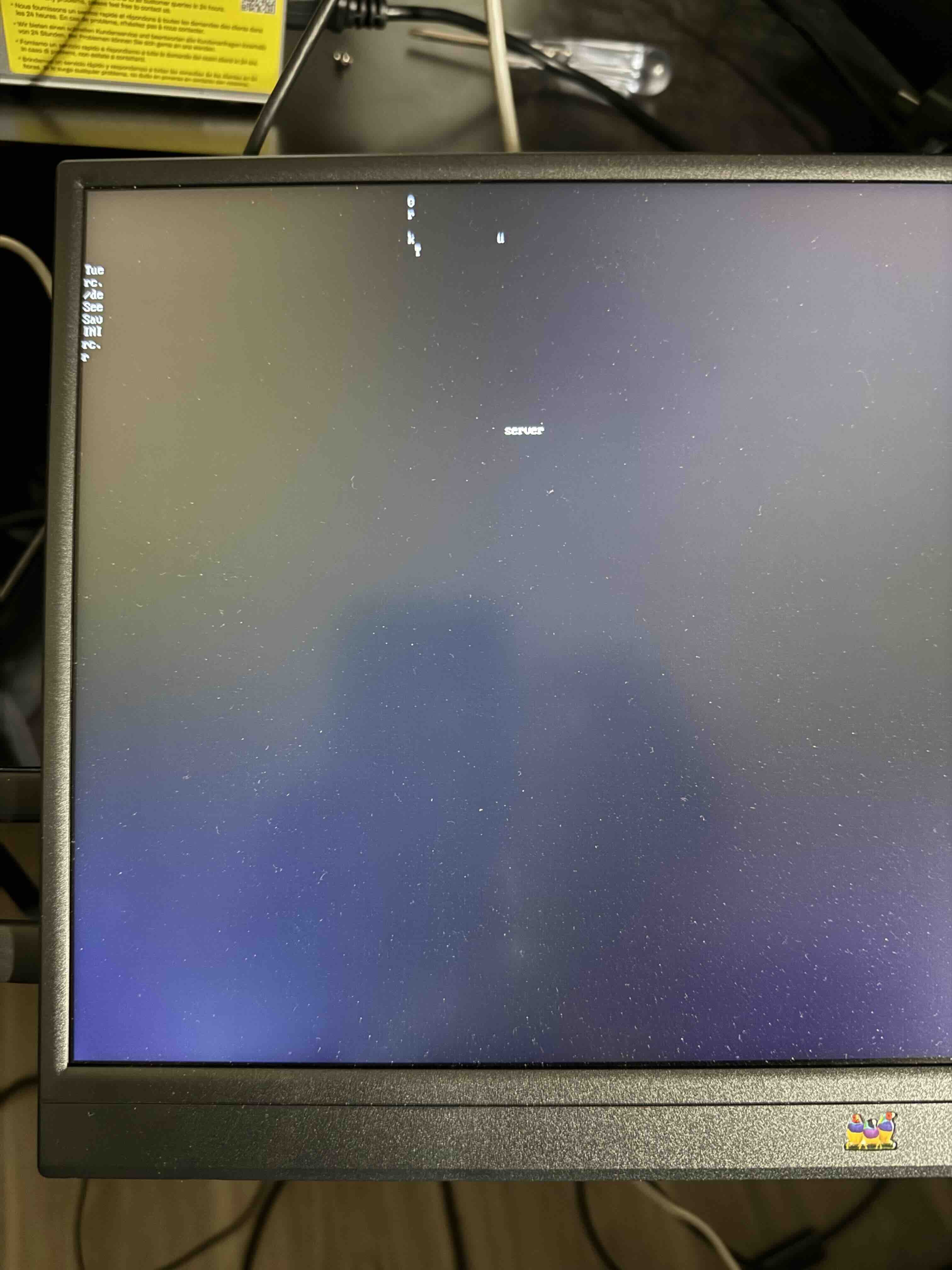

July 16, 2025Jul 16 Author I did not have one connected at the time. now it just shows garbled text. It does not appear the system rebooted.

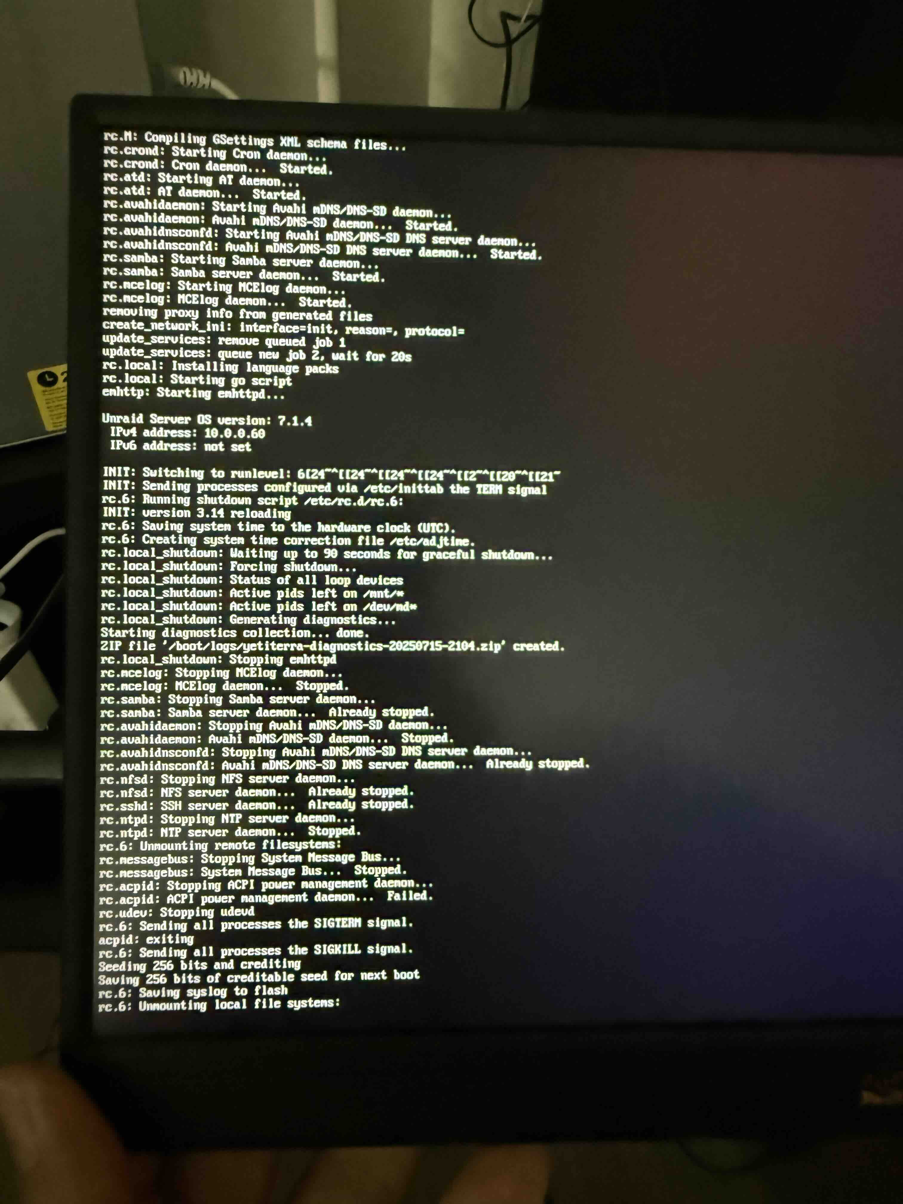

July 16, 2025Jul 16 Author Tried a soft reset and the display now shows additional information. But it remains stuck.
July 16, 2025Jul 16 Community Expert That shows Unraid is shutting down; the GUI won't be accessible.
July 16, 2025Jul 16 Author ok, so just leave it like this? Its been ~ 8 hours (since i hit reboot in the GUI). Edited July 16, 2025Jul 16 by lawyeti
July 16, 2025Jul 16 Community Expert Just now, lawyeti said:ok, so just leave it like this? Its been ~ 8 hours.No. If it does not complete in a few minutes after reaching that stage it is never going to complete and you need to force a shutdown by holding down the power switch.
