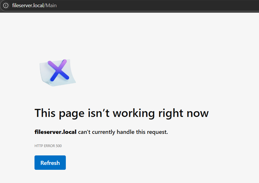

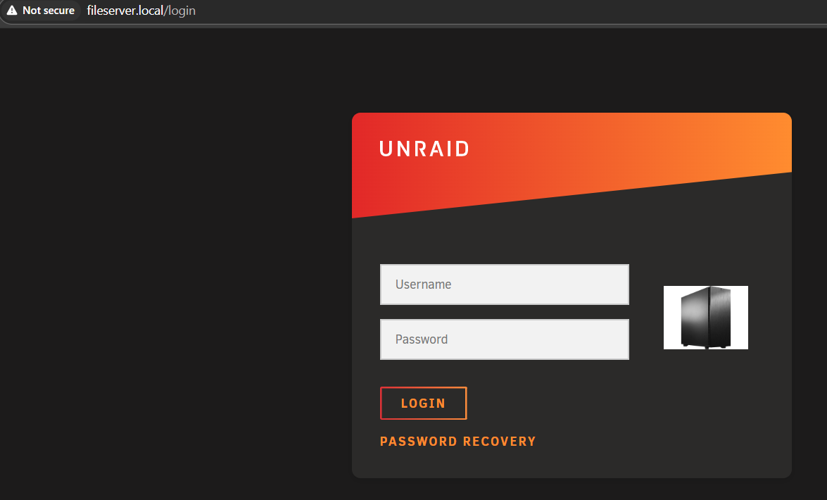

I am unable to get into my dashboard after rebooting. I've tried restarting nginx and php-fpm which will get me to the login page but after I log in the next screen I get is an error message that says "This page isn't working right now". Any help would greatly be appreciated.

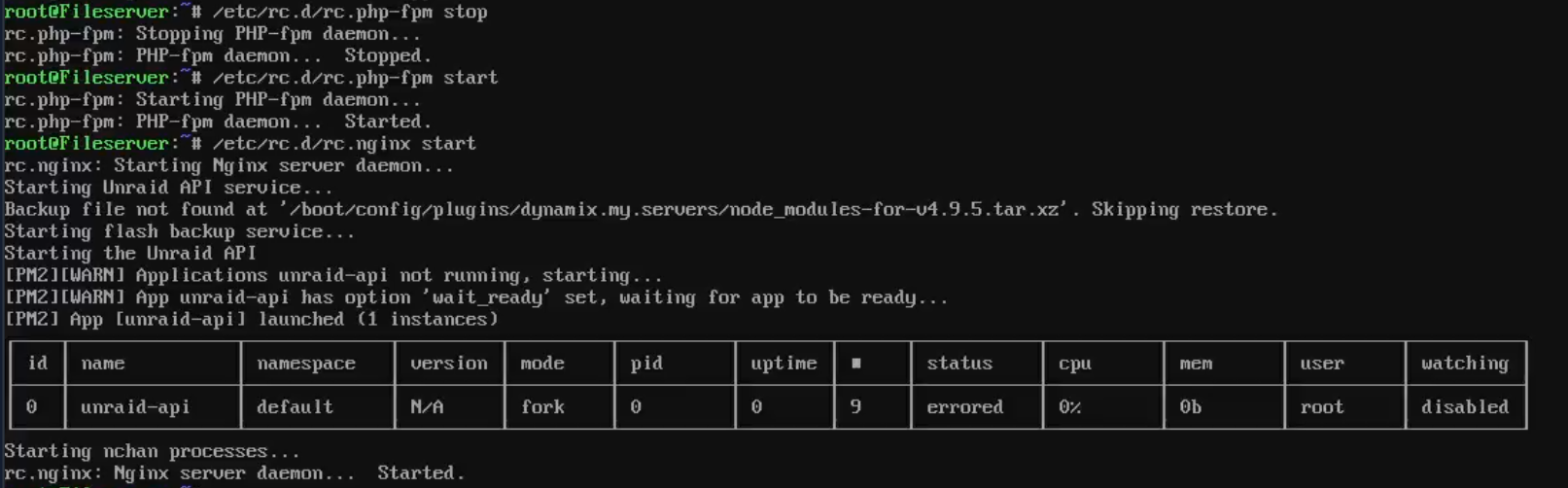

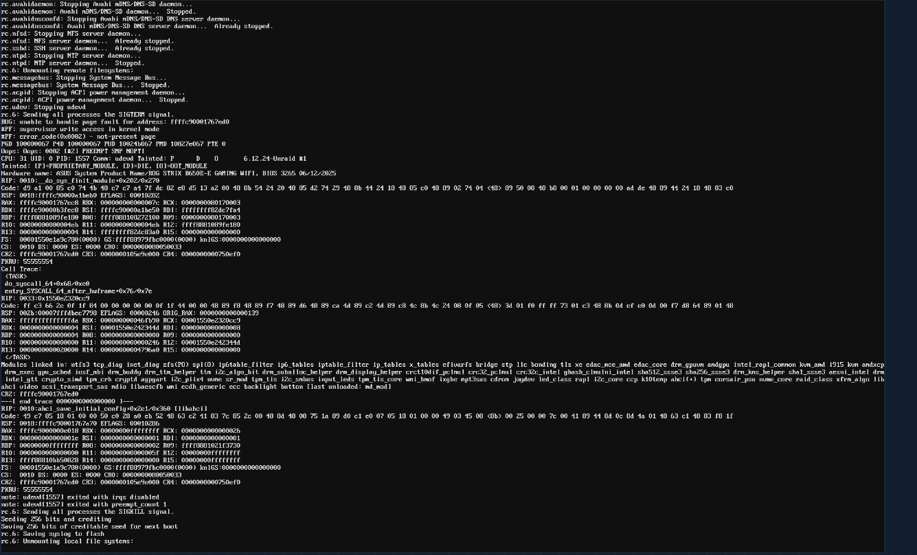

Don't know if this helps at all but I got this when rebooting the server from CLI and it hung here and won't shut down:

Thanks again Jorge for saving my bacon. So I found the issue being the Unraid connect app causing the issue. Also, my kernel panics came from upgrading my cpu from a 7950x to a 9950x with my b650e motherboard. I was getting MMIO issues. I resolved it by upgrading to a proart x870e creator motherboard.
