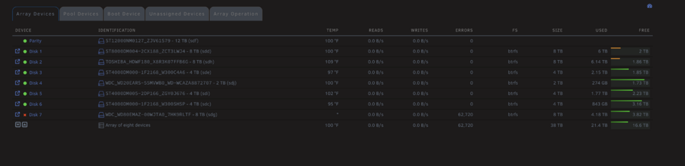

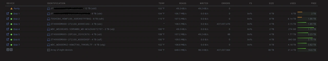

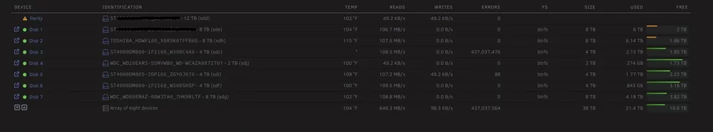

July 16, 2025Jul 16 I had a 12 TB Parity drive start to show some errors. It was still under warranty so I powered down the array and swapped in a replacement 12 TB drive to start a parity sync. Now that the parity sync is in-progress, I'm seeing a massive amount of read errors on Disk 3 in the array (over 400k errors).I'm not sure what the best case scenario is at this point. I have the old parity drive still (have not erased data on it).Should I allow the parity sync to complete? Should I stop the sync, replace the old parity drive, then replace the failing Disk 3?For the most part, Unraid is still working fine except the syslog is getting hammered with lines like this:md: disk3 read error, sector=4472505808 Edited July 16, 2025Jul 16 by ColonelRhodes

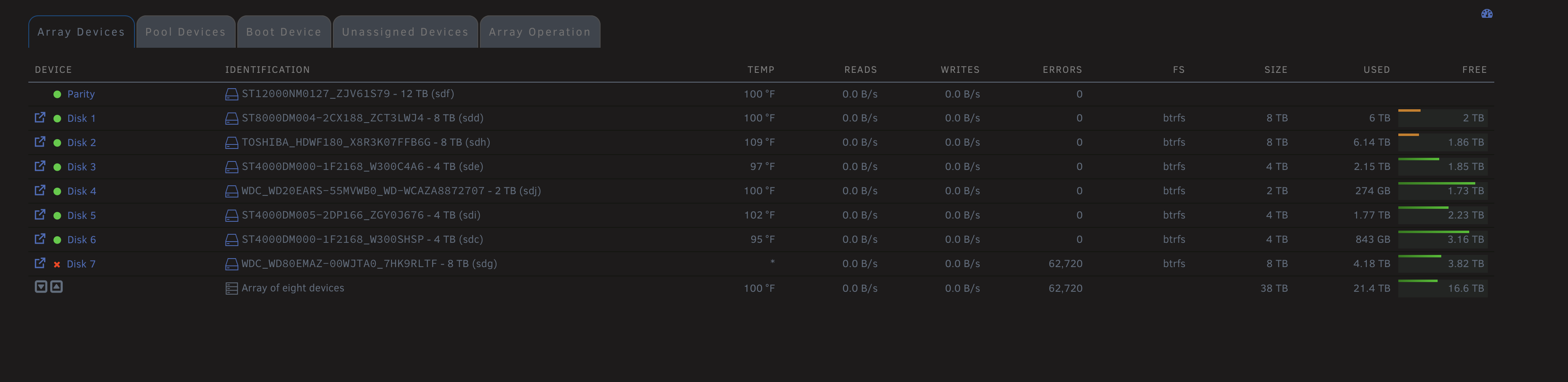

July 17, 2025Jul 17 Author I just got an alert during parity check that disk7 now has errors (seems similar to what happened on disk3)tower-diagnostics-20250717-1421.zip Edited July 17, 2025Jul 17 by ColonelRhodes
