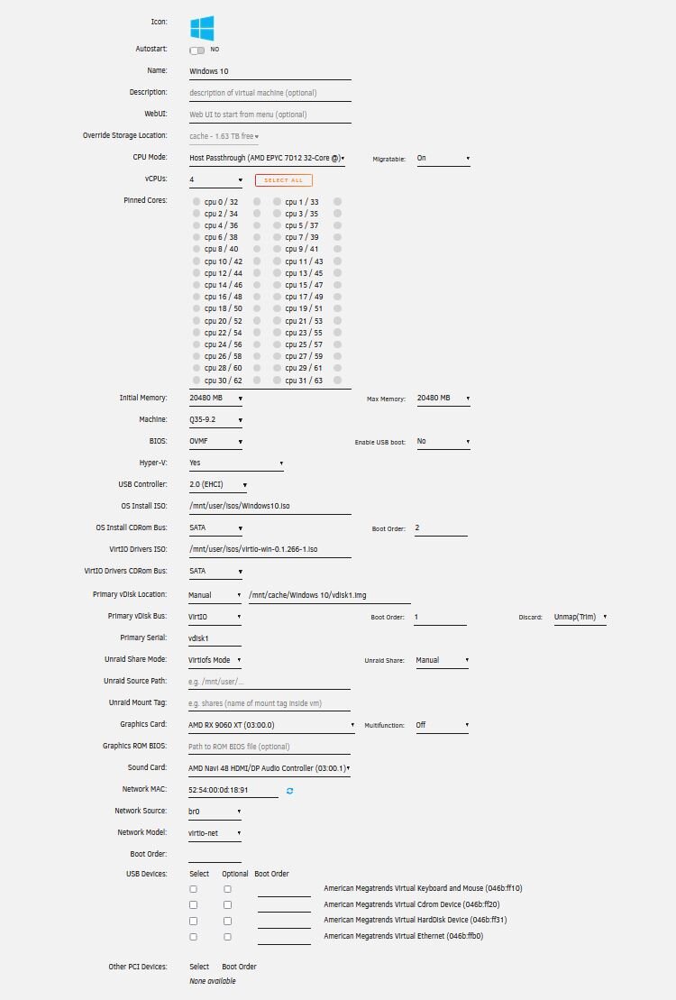

Hi all,
Apologies in advance if this has been repeated, which it likely has but I have followed all the relevant threads I can find but my unRaid system still freezes up.
So trying to pass through an AMD 9060 gpu the steps I took as follows:
  1. Setup Windows 10 VM with VNC first to setup and install a remote desktop system.
  2. Once installed I shut down the VM. Change Graphics card to the AMD Device (it is on it's own IOMMU) - Multifunction is off. I have also set PCIe ACS Override to both.
  3. Audio device i set to the AMD device that shows up.
  4. The VM takes a while to start but eventually status changes to started but the remote desktop never goes online (which it does immediately once the log in screen loads)
  5. I then try force shutdown and this is where the system hangs. Forcing me to hard reset which I can't keep doing to avoid data corruption.
Either one cannot go the route of setting up the system via VNC first and just changing over or I am missing something here?
If there is any specific data needed I can share.
iommu grouping.txt xml form.txt
