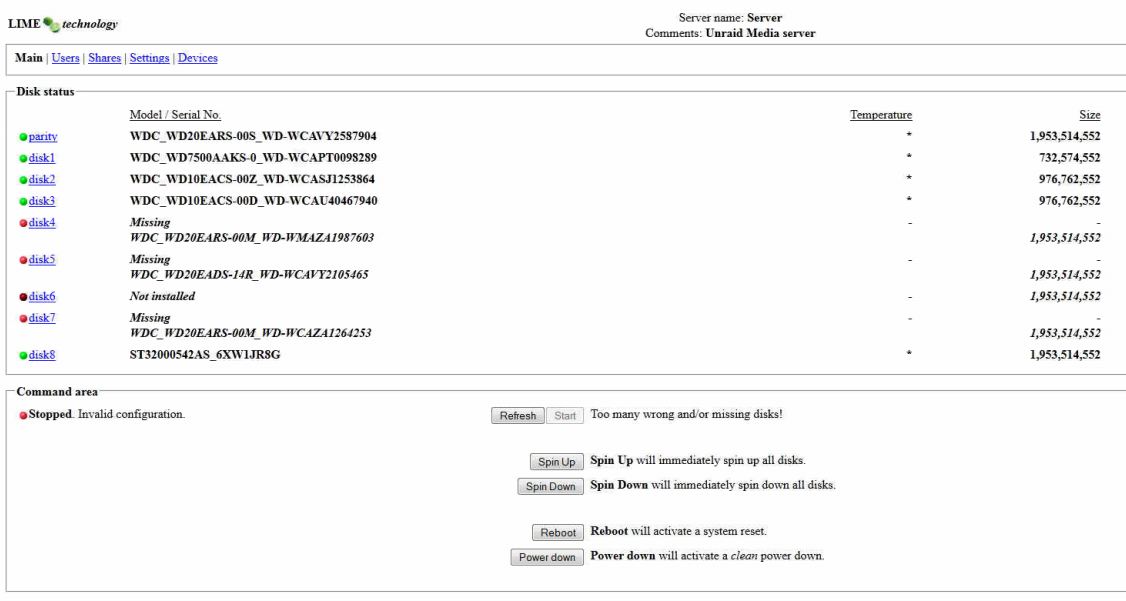

I have been running 4.7 for more than 6 months without any problems and I haven't added any disks since I started.  Last night I went to a folder on the unraid server to find a file and the folder structure was all there, but all the folders except the Movies folder were empty.  The Movies folder was never assigned to all the disks in the array.
I logged on via the web interface and all disks were flashing green except for disk 6 which was red.  We had a storm a few days ago when we lost power and the server rebooted (yeah I know I should have had it connected to a UPS).  When I saw this red disk, I rebooted the server in hopes that it would magically come back on line with a reboot.  After the reboot, disk 4,5 and 7 now show as missing and 6 (the original red disk) shows as not installed.  The other disks are blinking green.
What should I try to get the array back up and running?

Looks like an entire disk controller has stopped responding...  Three disks missing, and one more not installed?
Step 1.  Post a system log from before you do anything more.
Step 2. power cycle.  perhaps the disks/controller just need to be initialized and a simple reboot does not do that.
Step 3. post a second system log.
Step 4. consider the purchase of a UPS and configuring the server to shut down cleanly in the event of a power failure.

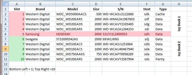

I opened up my server and all the disks that are missing/not installed are on the same icy dock 5/3 tray.  These 5 disks are connected to 5 of the motherboard SATA connectors.  The other 5 disks that are showing green are in a second 5/3 tray with one SATA connection from the motherboard and the other 4 from two SATA pci cards.

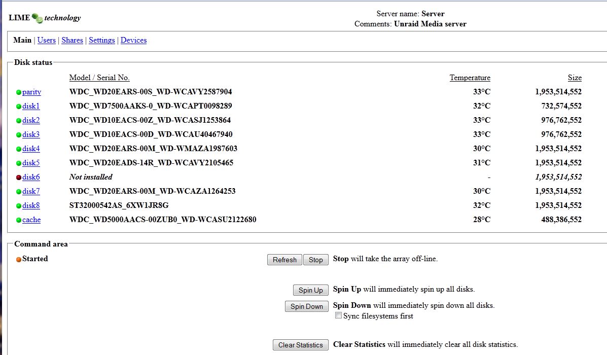

I disconnected the drive that was originally the only red drive and booted the server and now all the drives that are connected show as green (just like I originally saw before my first reboot that made the others go red).  Would one bad disk when connected within a 5/3 tray make the other 4 disks connected in that 5/3 tray show as Missing?
So it appears to me that I have a bad disk and I need to follow the procedures for replacing a bad disk.  Does that seem logical?
You might have a loose power connection to that tray.  The replacement of the one drive may have re-seated it.
Yes, at this time you can go about the process of replacing the defective drive.

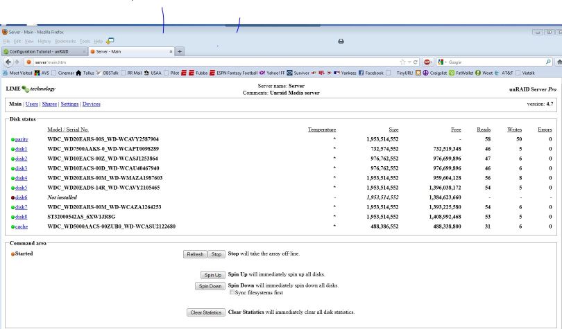

I ran pre-clear on a new 2TB drive 3x and it was successful (no errors).  I restarted my server with the new disk (same size as the old disk) in the same location (disk 6).  The main page shows this disk as not installed.  Where do I go from here to add this disk to the array?  Disk 6 is showing up as not installed.
thanks,
Murray
thanks,
Murray
Does it show in the BIOS?  Do you see it listed (by model/serial number) in the syslog?  If you stop the array, is it available in the drop-down list for assignment?
If not, then you have exactly the same conditions that might have taken the original out-of-service.  (the disk is not responding, for whatever reason... defective/intermittent controller-port/drive-tray/cabling/power)
When I stop the array it is available for assignment and lists the model/serial numbers.  Do I just assign it and then the array will rebuild and incorporate it with the other disks?  Or is there another step to get it into the array? thanks,Murray
That's it.  Just assign it, then start the array.
Thanks...everything is back to normal now with the new drive.
