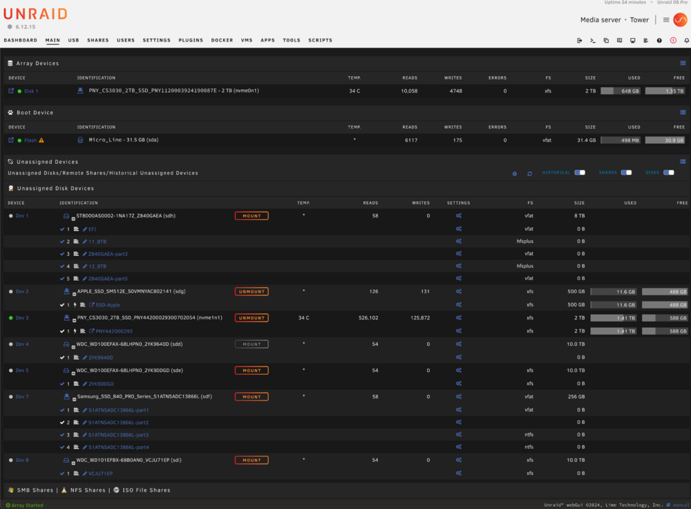

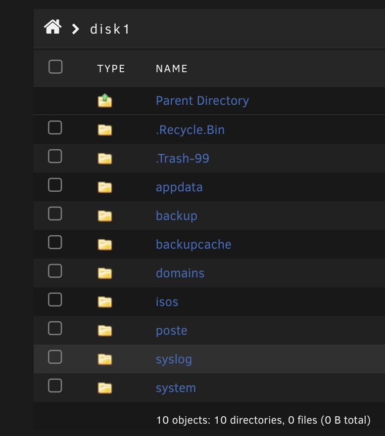

July 21, 2025Jul 21 Author 4 hours ago, Kilrah said:You don't need lots of RAM for ARC. Can set it to the max of 256MB and go ahead on your way, with potentially lower performance but that's likely not going to matter for backup use.So... I tried the ZFS RAIDZ with 3x 10TB HDD today, but unfortunately it seems to be very slow, esp. compared the the BTRFS RAID5. I set it up with standard settings, no special config, with only a minimum RAM setting. I have 64 GB in my Server, while I was using my VM with allocated 48GB RAM, copying files seemed to be very slow.I use a 10Gb Ethernet Connection on both machines, my Truenas and Unraid Server and with ZFS RAIDZ files of aprox. 1TB took significantly more compares BTRFS RAID5.In my actual array, I have only one NVME of 2TB, where all the system files, appdata, isos, etc. are stored.My VMs are on a second 2TB NVME, a unassigned device, where I boot my VMs from.My thinking now is, to actually use the Array possibilities from Unraid and put the 3x 10 TB HDDs in there where one acts as a parrity.Question is, if I create a new blank config, how can I restore my settings (apps, VM settings, etc.) which are then on the previous array NVME, which then becames a unassigned disk too?What is the best way to use it then, when I want the array to spin down also, when no backup job is running. So basically Uraid should not use the array when I work on the system with my Virtual machines!I really need no redundancy or security for my VM images, as they backup over to my truenas server.Does the array spin down, if these files stay there but non of these directory contains files, the VMs use?I guess performancewise the Array would be the best bet?Here is a little overview how have set it up the disk now as my daily VM workstation:
