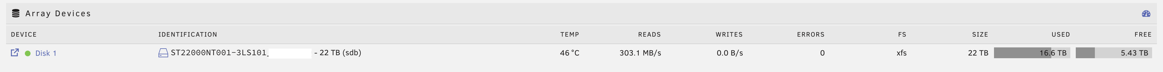

Here's the Reads value while performing Read-Check:

During a stream the disk shoudl be reading at like 5 to 10MB/s, so it's plenty of fast, assuming it's not doing anything else.

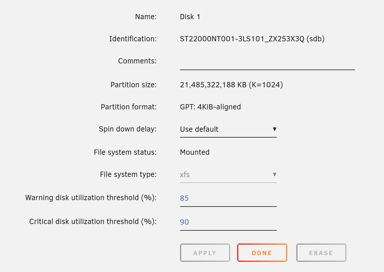

I'm a bit confused about the values I get when I use different commands to check the "read_ahead" parameter before to make any change:
  • When I type cat /sys/block/sdb/queue/read_ahead_kb I get 128
  • When I type blockdev --getra /dev/sdb I get 256
Same after I run the script:
  • With cat /sys/block/sdb/queue/read_ahead_kb command I get 16384
  • With blockdev --getra /dev/sdb I get 32768
Maybe because they use different measuring units?
Anyway, I'm getting a HDD replacement with a brand new unit (not refurbished) and I'll start over.
I will do a Preclear before to create a new XFS Volume in order to check disk integrity.
Is there any parameter I need to consider when I will create the XFS Volume on the new HDD?
I am specifically referring to the bytes/sector formatting parameter.

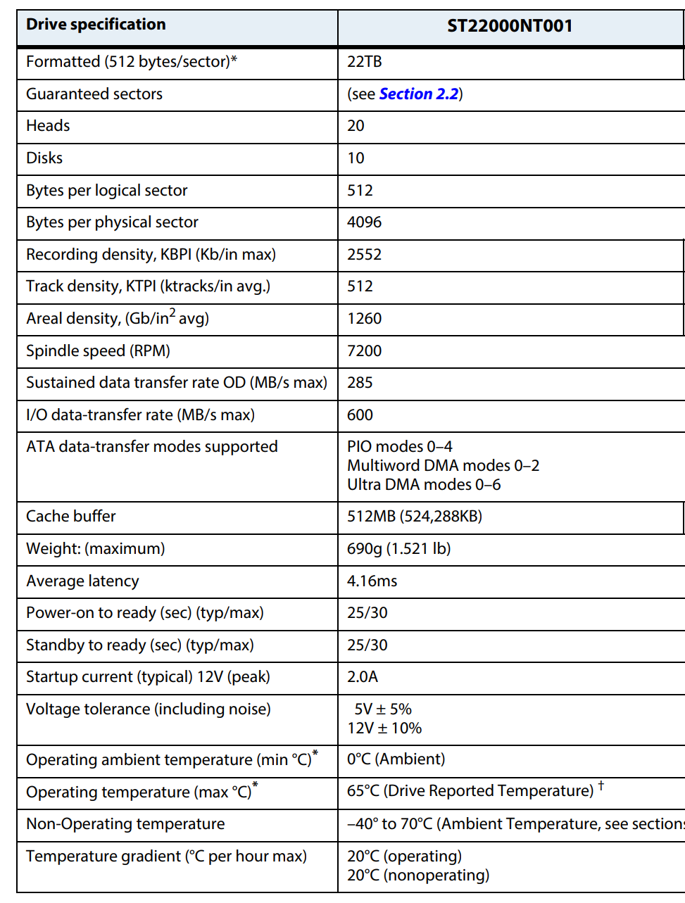

This is the actual configuration of the current disk that I will replace:
These are the official disk specs from Seagate:
Full document here.
Sorry for my noob questions, any help and suggestion are appreciated.
Thanks
nope ...

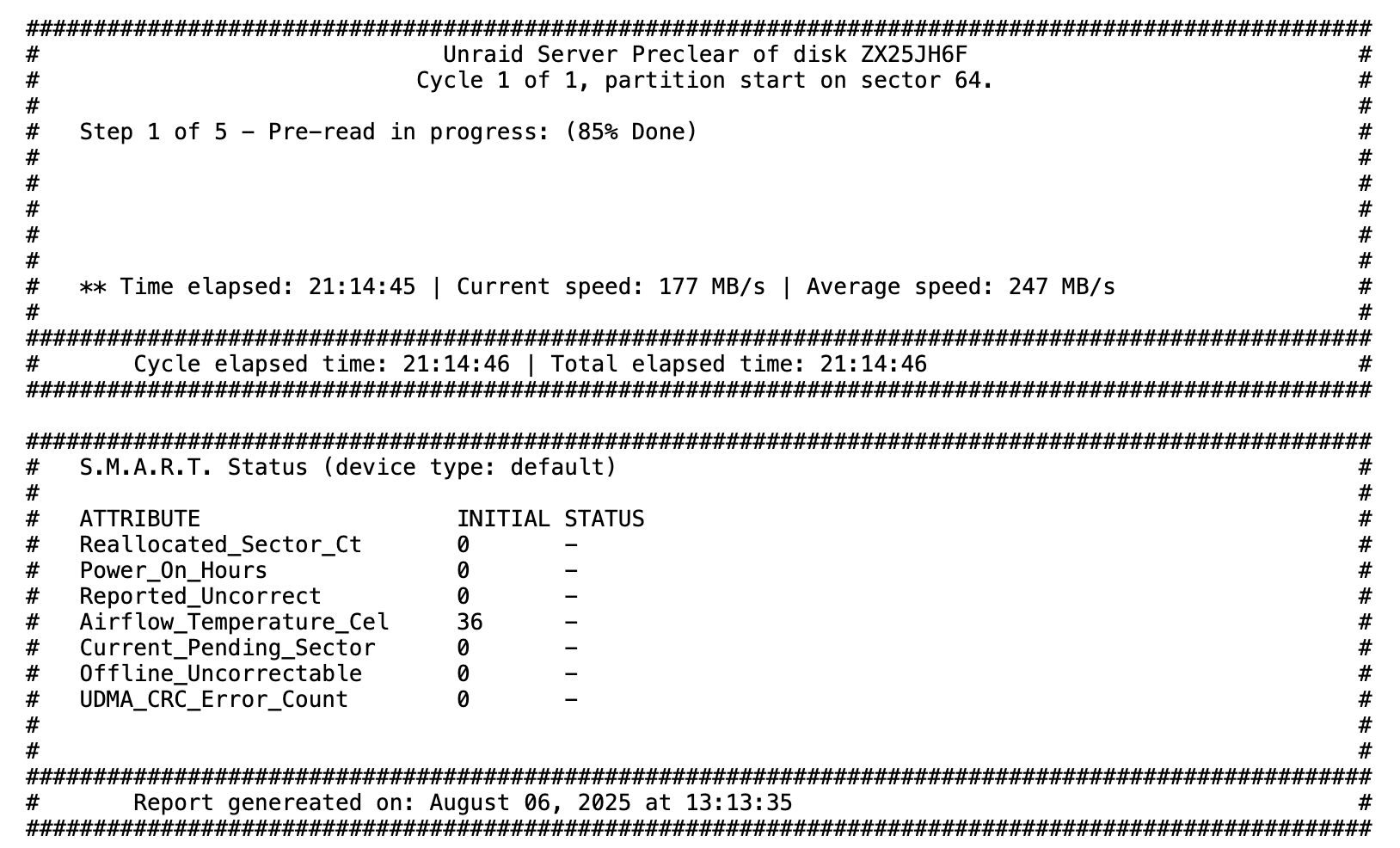

I get a brand new replacement disk yesterday and it's running preclear since 21 hours (it's at 85% right now):
I don't remember there were 5 steps, I remember 3 (read, write, read).
So which are these 5 steps?
I also don't remember if the Preclear plugin will format the disk at the end of its job.
Is it better to let Unraid OS to format the disk?
Thanks again
i never preclear a disc ... so definately the wrong person to ask ;)
It won't, since the disk would no longer be cleared.
If you are going to add it as a new disk, you will need to format it at array start, if it's going to replace an existing disk, it will be rebuilt using the existing format of that old disk.
Hello @JorgeB
Thank you for your reply.
Yes, I will add it as a new disk then I'll copy all content from the previous disk.
