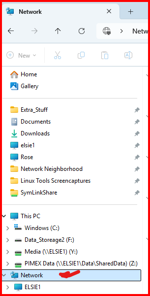

July 24, 2025Jul 24 Community Expert 2 minutes ago, Corneloues said:Low and behold - they've now started working!I have said for years that SMB appears to be controlled by witchcraft and magic. Ifd it is not showing up here:Then read here:https://forums.unraid.net/topic/191221-some-musings-on-smb-and-samba-and-unraid-and-windows/#findComment-1561585(Right now, I am missing my second Unraid server-- on 24x7 --until I went to it and opened a share.)
July 24, 2025Jul 24 Author The server was appearing, but not the shares!I think the witchcraft includes reading these forums, because without change, they all started to appear again!Cheers,Roy
July 24, 2025Jul 24 Community Expert 13 minutes ago, Corneloues said:The server was appearing, but not the shares!That is a new one...🤔
