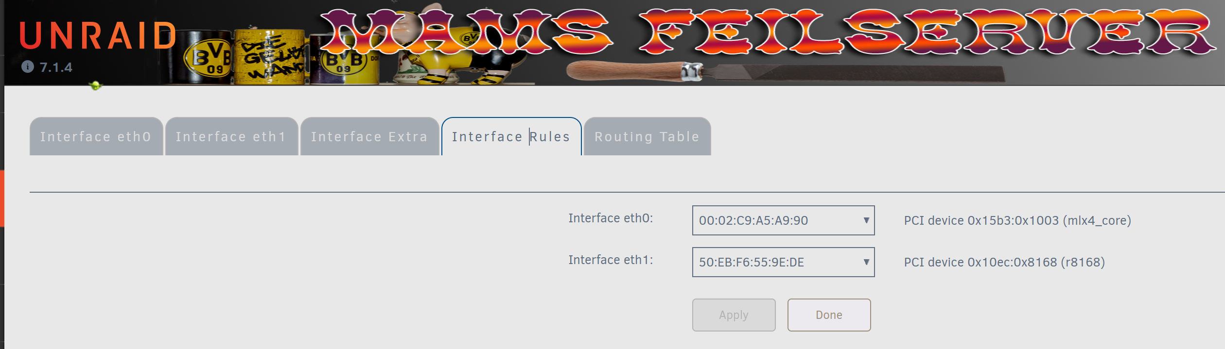

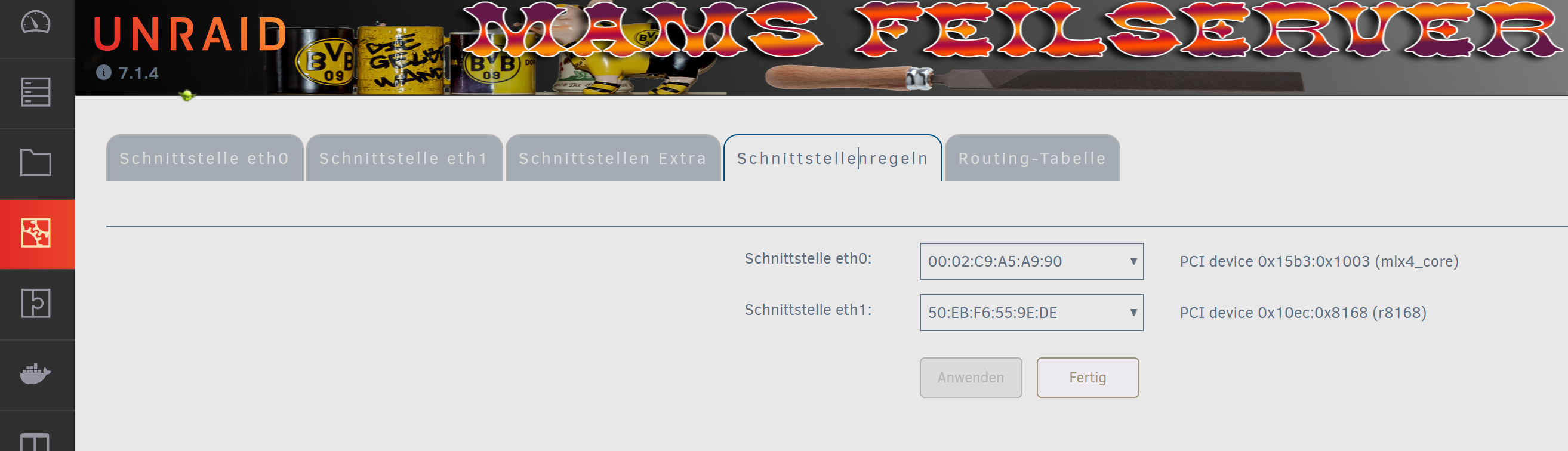

the correct way to do is is to let all the cards "live" in BIOS, go to UNRAID's networking settings and edit "network rules". Here you can define which card (MAC address) is "eth0" and so on.
This setting will be applied on every reboot (your BIOS maybe reset after an update and the cards may become active again then)

You man need more than one active card to make the tab appear...
